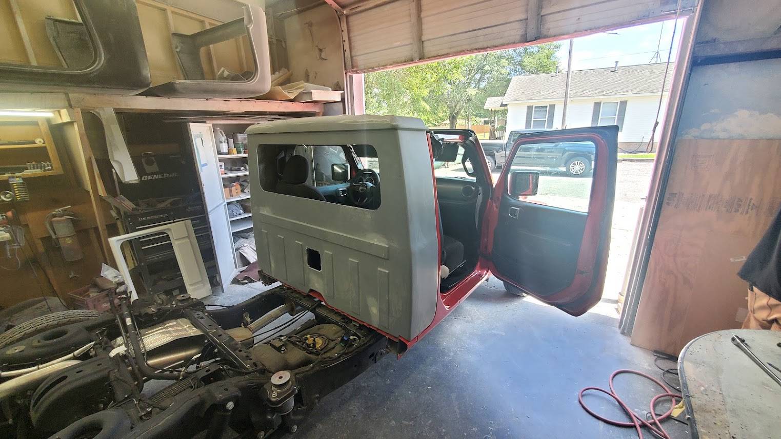

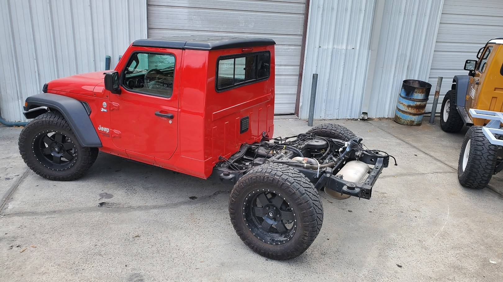

Just joined, and found some of these threads. Its interesting to read all the angles people like to have at the 2 door Jeep truck market. It certainly is a niche market that is a subset of the Jeep truck market. But, we are trying to cater to that market with several of our different products.
Earlier in the summer, we finished up the JTruk Cab kit for the JLUs. We took a 2019 JLU and cut the whole back of the tub slightly behind the pinch weld seam in the bottom of the rear door and remove the rear body, but we do not cut the frame, fuel, or brake lines, or any electrical. We then bolt on our complete fiberglass cab enclosure using bolt locations of the rear doors. The wheelbase stays the same. We then can put on a flatbed or this this customer want put the effort into (not easy or cheap) to extend an existing gladiator bed to fill in the gap at the front. This will be a kit format that you or a body shop can do.
Jeep Gladiator Gladiator 2 door. Please, please, please, take my money! pE1QP0B3vE15g_242Lgw=w1620-h911-s-no-gm?authuser=0

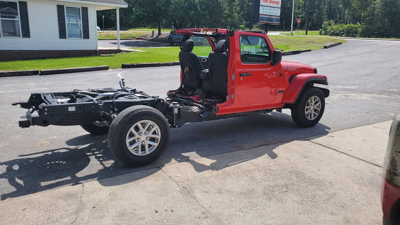

Next up the gladiator. Our existing cab back for JLU will also work on a gladiator that a person wants to make into a 2 door long bed. We just cut up a 2023 JT with 4500 miles on it last week. The cab back will work the same and leave at least a 7 ft bed. I'll post reply with a pic of that from my phone.
We don't have the full video install for a JLU or JT yet, but the process will be almost the same as it was for the JKU. Its the JLU and JT have a bit more wiring/sensor/relocations than the JKs did.
But, if you want to see how the process works, Here is the link to the JKU install
https://youtu.be/EN2Fb6fazQ4

A few pics on the Gladiator build.
Meh, not really what I would expect/want. It would be much better if the entire top were able to be removed, like on the AEV Brute conversions.
