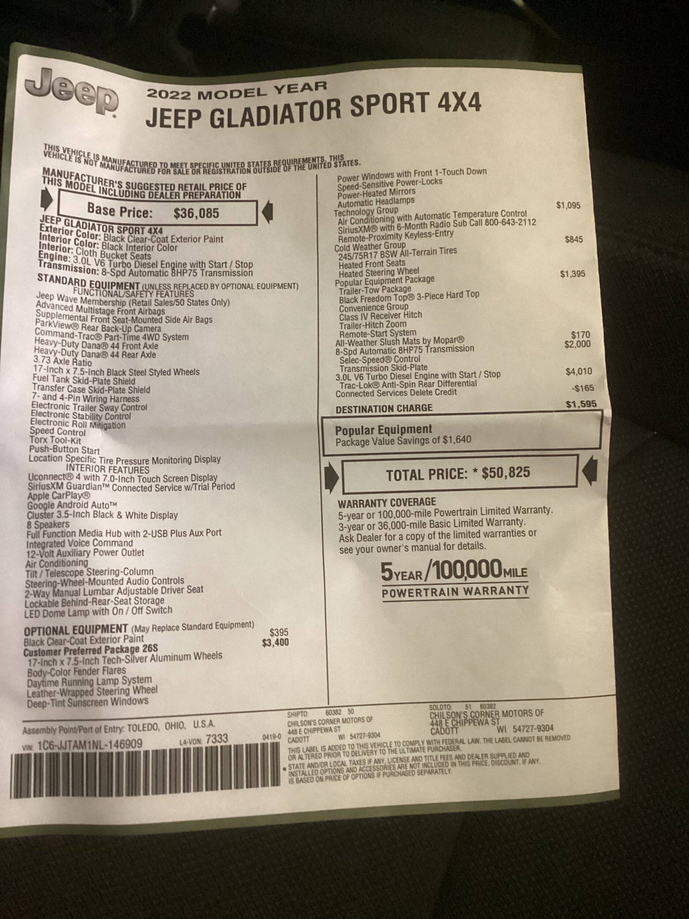

Being in Midwest Wisconny I went with the Hardtop, and cold weather package. Worth it, well worth it. -20°F worth it . Bundled with Popular equipment it was a little cheaper. Get hitch, hardtop, and… it’s on sticker lol. Not sure for 23’. I almost pulled trigger on a Willys Diesel. After realizing I didn’t need; the rock rails, the 255 optioned black wheels, and a black grill, I saved money on a Sport. The Trac Lok rear end came with diesel so Willy’s or not I got that. No Selec Trac, no biggie. I put wheels, tires, side steps, and a Mopar matte grill on for less than the factory Willys option. Bedliner was horse a piece, $500 Mopar, $500 after market. For my 22’ when I opted for the cold weather it also gave me the 1st upgraded tech package, keyless entry proxy, and better gauge cluster. No 8” Uconnect display, which would have gotten me rear USB ports. Kids are fine without it in back. No alpine woofer. Wanted to get the best bang for payment. Here is my sticker.
Jeep Gladiator Please Critique my New Gladiator Configuration 81A5105C-594A-42AB-BEA2-2004CA5C9C09

i skipped this about the prices... based on this go for diesel for sure.
21mpg with a Gas seems a sweet lovely dream ( again based on my experience , maybe someone will confirm he can do that)
Was getting 28-29 w/3.0 @ 78mph all last summer. Lift and tires choked it a bit to 22. But still running winter blend up Nort’ hopefully she’ll pull back to 25-26 when the kerosene is more pure
