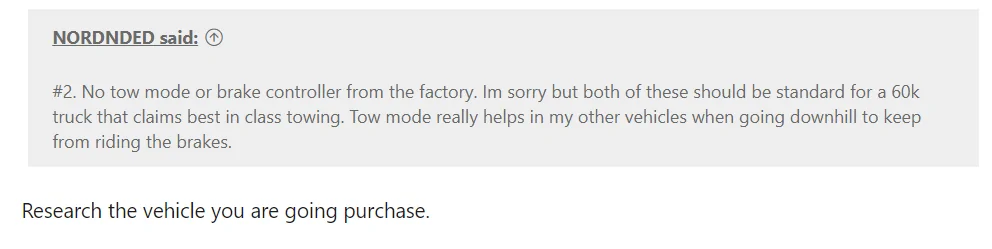

#2. No tow mode or brake controller from the factory. Im sorry but both of these should be standard for a 60k truck that claims best in class towing. Tow mode really helps in my other vehicles when going downhill to keep from riding the brakes.
Research the vehicle you are going purchase.
