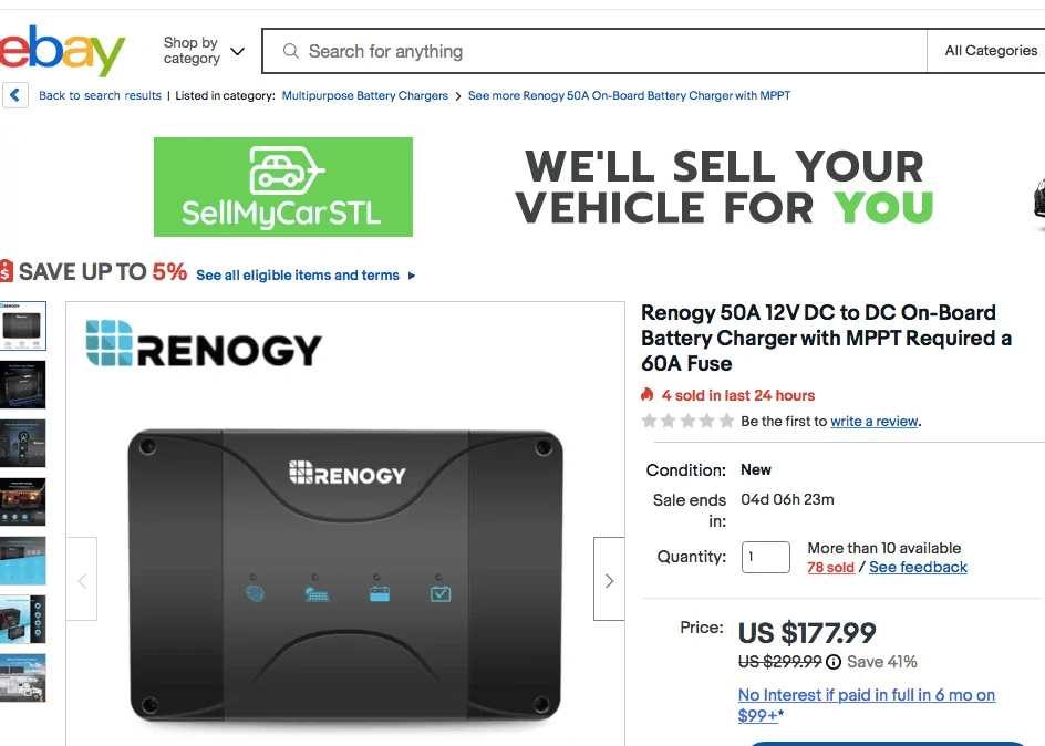

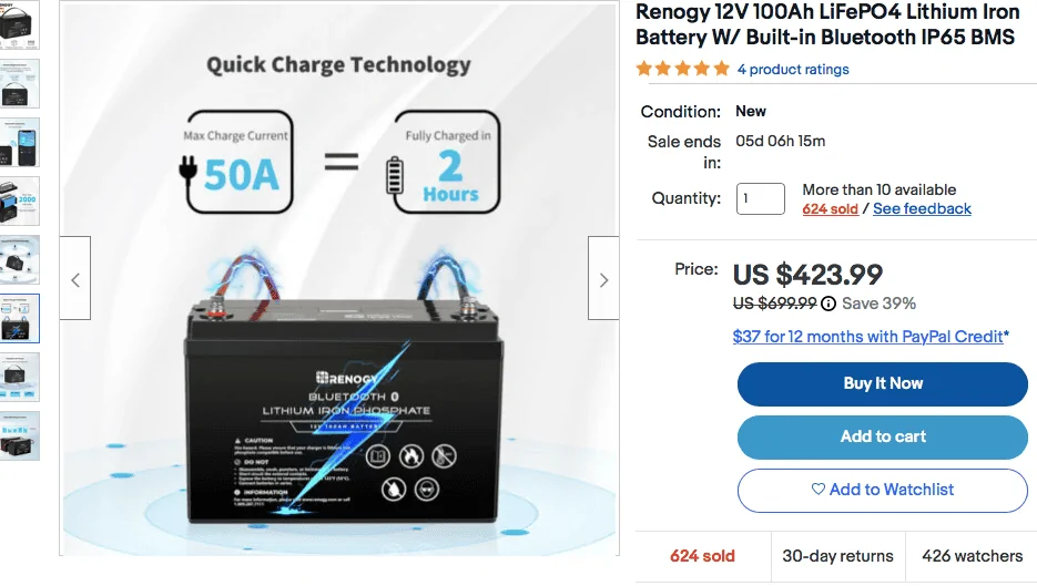

To my knowledge (not that much) Renogy is a quality product. My build is so far all Renogy.
Edit:
From what I've read. As far as batteries go. Battleborn batteries are the best. Renogy comes in a close second. Check out their eBay store. I've bought all my stuff from there. They run a lot of sales on eBay.
The Ebay Renogy store rocks!
Wait till memorial day. I bet you can get it cheaper on there. I saw the batteries at 383$ shipped for free.

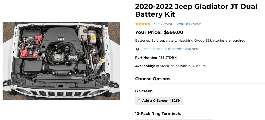

Alright, we talked Lithium, solar, DC DC charging, and battery boxes vs. built in. I want to hear more about under hood dual battery systems. Any good or bad experiences. I still like the clean idea of keeping the batteries out of the way, under the hood. Only problem I've found is that I don't think you can use Lithium batteries in this setup. That means the old school batteries won't be as fast charging and pretty heavy. You can fit (2) 750Ah batteries in there.
By the way, the Gladiator already has a smaller second battery for the Start/Stop ESS system, that runs the accessories when the ESS kills the engine. Too bad this second battery is only 12Ah and not big enough to power my fridge for long.

There's just not a lot of advantages to agm over lifepo4. Agm is only good for about 50% discharge vs 80% for lifepo4. Combine that with charge rate and it's not really a contest. Your battery wont last very long running a fridge in warm weather. Plus you have to replace agms more often. The only advantage foe me is the ability to self start when my main battery died. But now I carry one of those battery starter pack. I guess the other big thing is the extra work of packing and unpacking the lifepo4. Of course you can use this excuse to get yourself something like an rsi or alucab cap. :) then you can permanently mount it in the bed nice and clean.

From what I have read standard lithium batteries do not do well in high heat environments like under the hood. They make high heat versions but I expect they are pretty expensive.
For my needs the dual battery system under the hood works well. It keeps our fridge, shower pump, and charging ports working. We generally are driving somewhere new each day so it is automatically charged. We don't use a solar setup.
If you are staying stationary for a few days you may want lithium and/or solar charging.
One big advantage that I see in the dual battery system is it gets rid of the troublesome second battery in the Gladiator. I like any modification that makes my rig more reliable when we are by ourselves in the middle of nowhere.

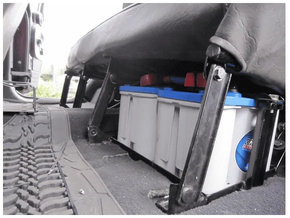

Maybe I could fit Lithiums under the passenger seat or back seats. Here's a couple Optimas under a JK rear seat.

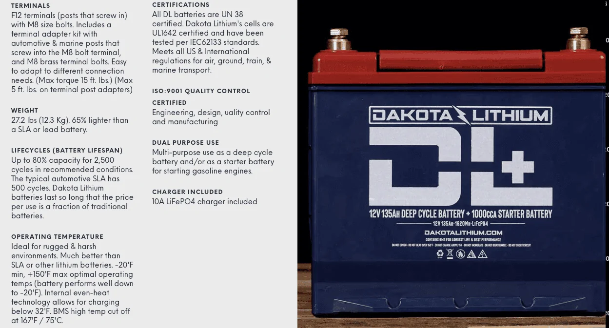

Now, here's a really cool option, if it will work. Dakota has a 135Ah Group 24 Starter Battery (smaller in size than my Gladiator's battery). The biggest complaint I've heard about Lithium Starter batteries is that they don't like the cold/heat. Dakota says theirs works from -20F to 150F.
How cool would it be to have 135Ah of power available for my accessories, in my truck's starter battery! I'll have to check charging rates, but my 240 amp alternator might be able to fully charge it in about 40 minutes. All that power, and no second battery, no DC DC charger, or solar setup. Change the battery and go.
It can't be that easy? Anybody try Dakota Lithium Starter batteries yet?
