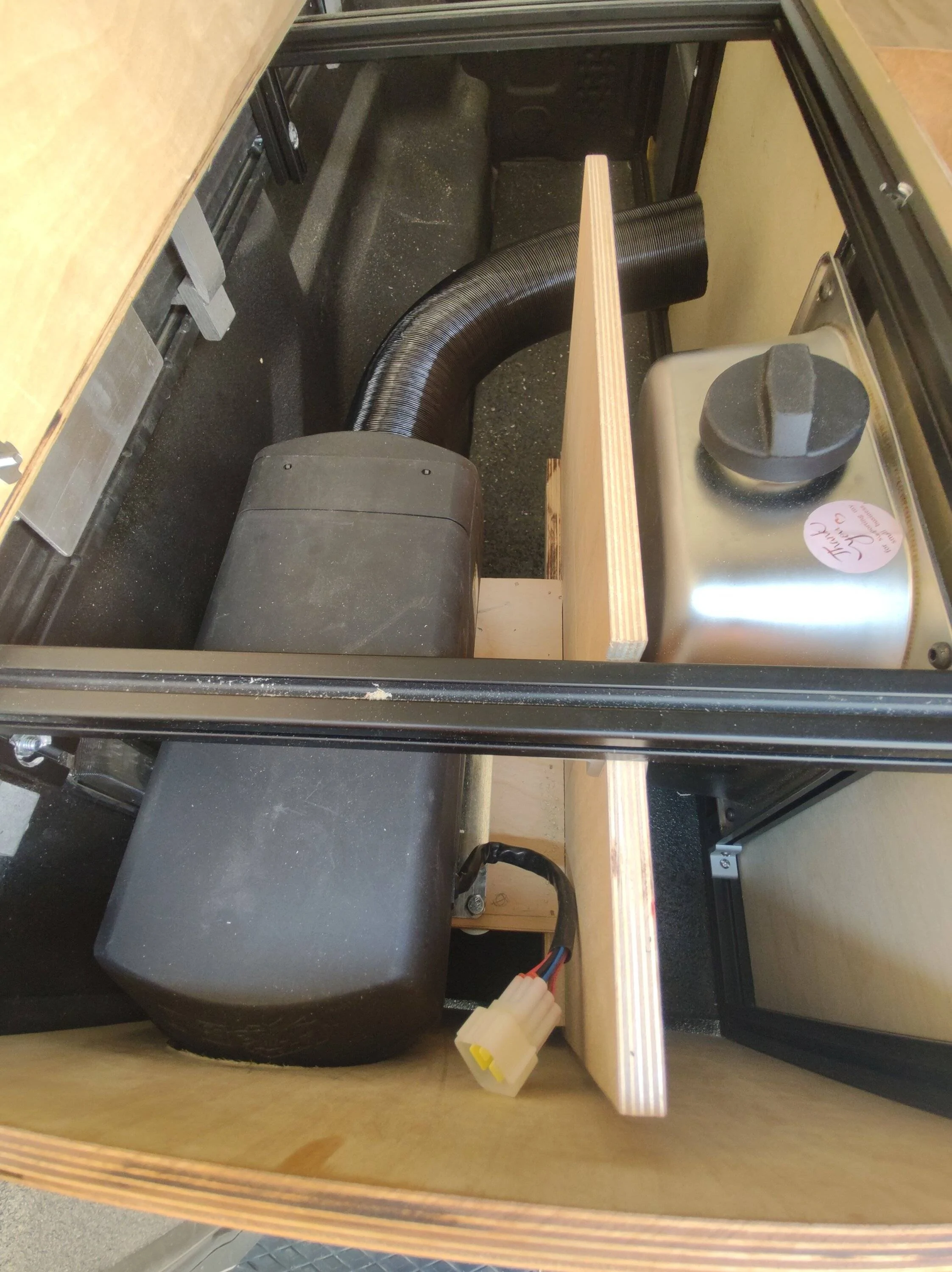

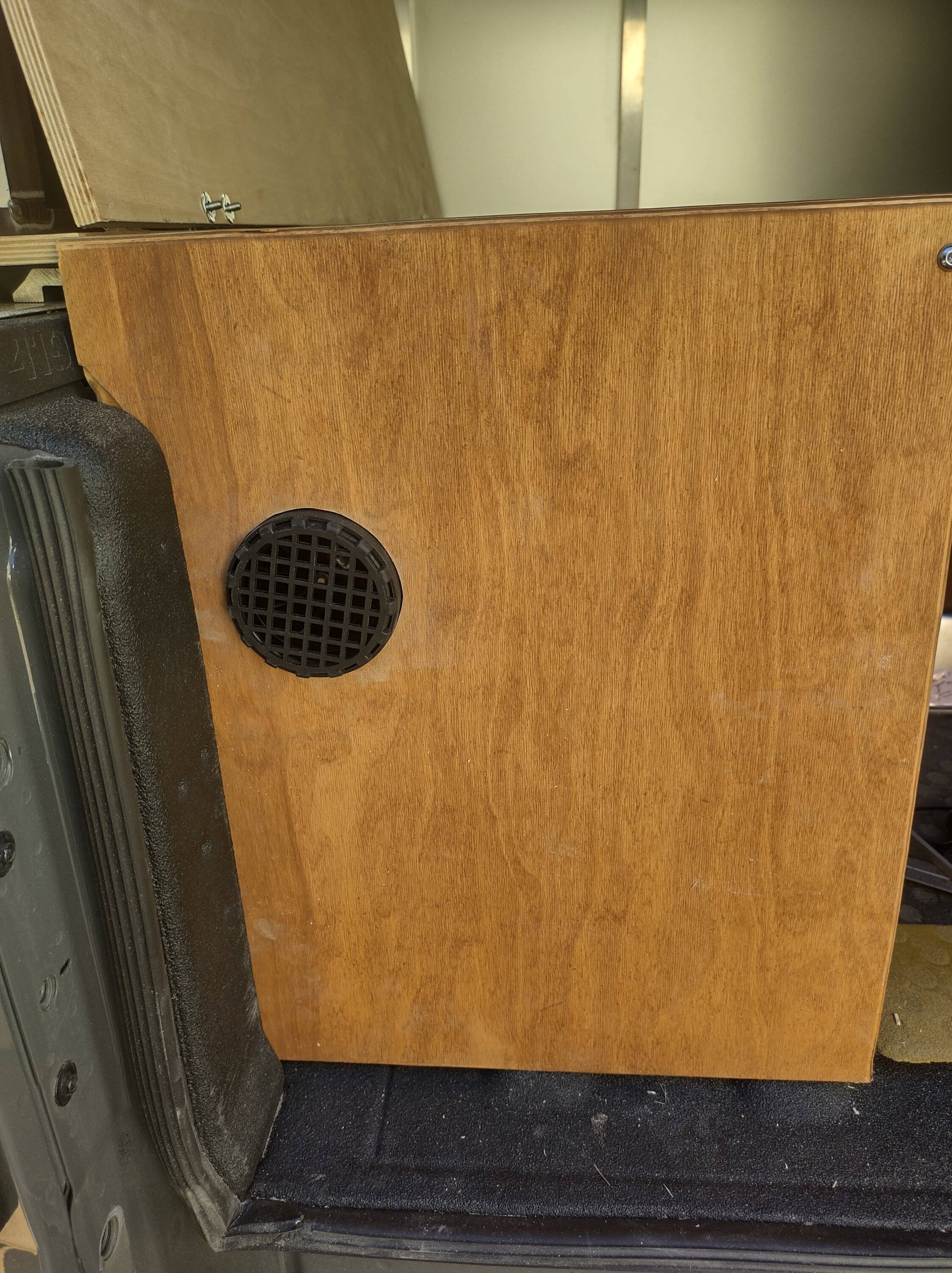

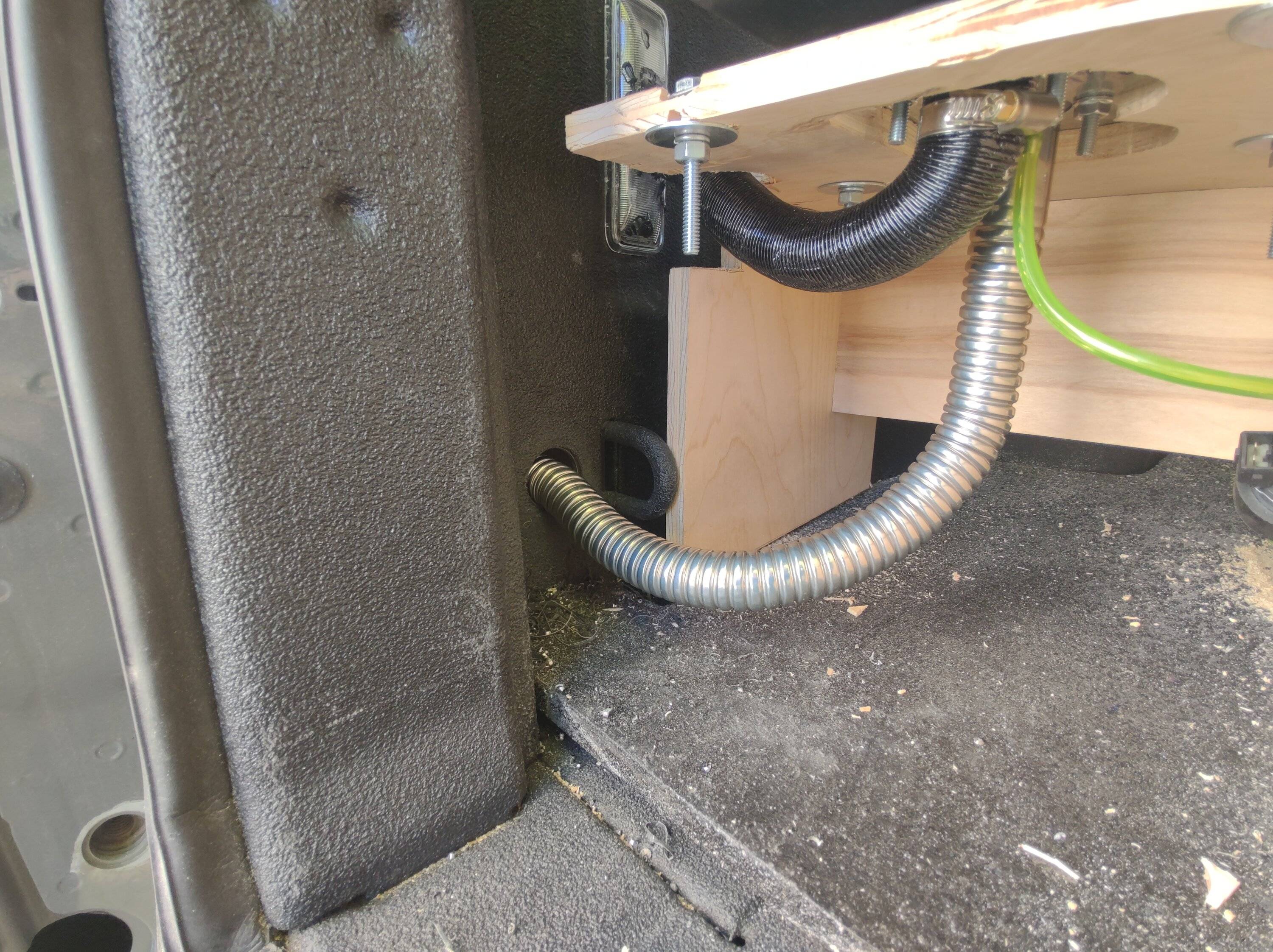

So my setup is under the bench seat. Not quite completed yet. But I have the heater intake stubbed through the wall of the bench unobstructed. The air intake for the heater for ignition was ran through the wall right where the bed light was. I bought a bed light from eBay butchered it and ran it to the back side of the wheel well. The exhaust port is ran through the bed hole(bored out to 1 3/8 using step drill) it will then be ran out and through to the bumper with a hole there for the exhaust.
That is exactly what I was talking about. Looks like great minds think alike....:)
Let us know how if works.

Sorry I meant the burner exhaust diameter. I’m guessing since you run yours outside you don’t need the exhaust pipe and muffler. No worries, I think it’s 2.5cm diameter.
Ah my bad. Not sure but the kit includes those parts. I did keep the filter and exhaust pipe on while outside.

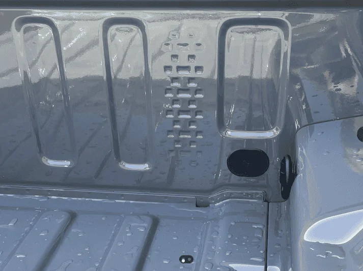

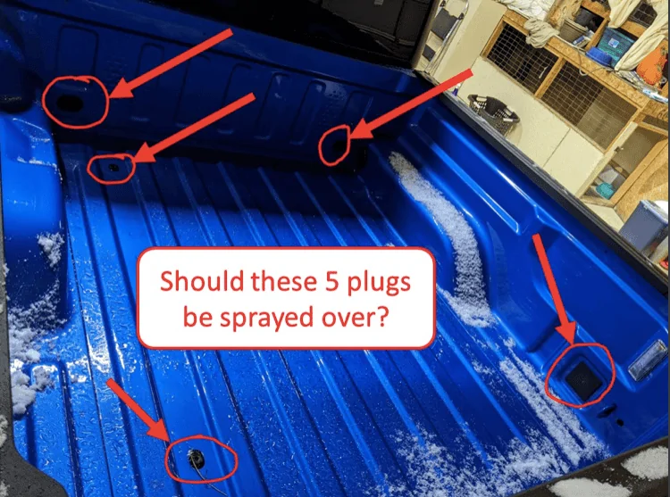

Here's a bunch of drain hole covers that could be used for a Diesel Heater exhaust (or the back right one for blower inlet). Mine is hard to see since they are covered with a factory spray in bedliner.

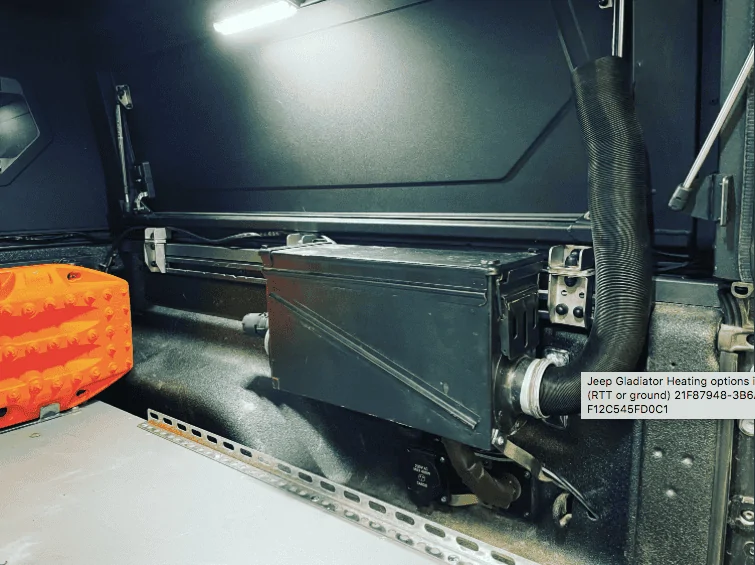

Here's another Diesel Heater install from @JeeperFIN. Nice setup built in an Alucab and ammo can. Looks like the exhaust is routed through the Jeep bed sidewall. Nice job!
Thanks
Yes, the exhaust goes through the power outlet hole. I didnt want to make any extra holes to the bed.
Diesel for the heater comes from the tank, i have t-fitting in the webasto inlet .
When i need the heater, all i need is to take the controller and thermostat to the tent.
