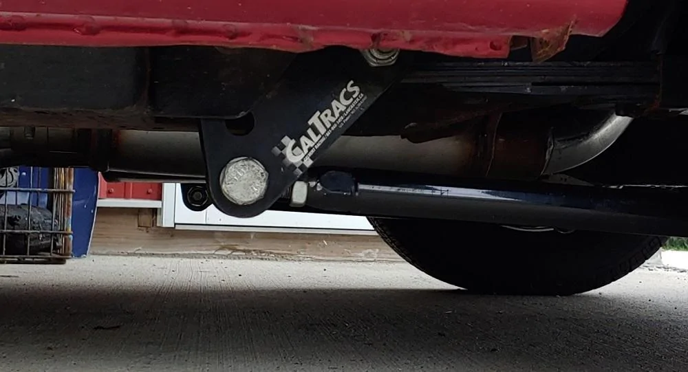

Old-fashioned but effective traction control...........
Jeep Gladiator Gladiator in snow - disappointment? caltracs-left-side-2
