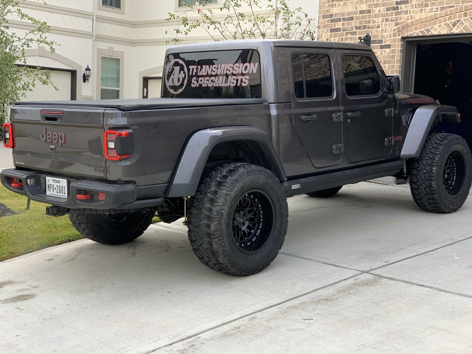

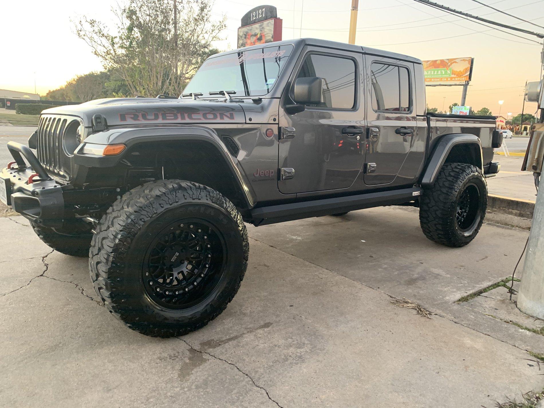

The best pics I have for now. 38x15.50. 20x11.5 wheels.
when I get the coil over I will Post some more.

Looks great. Which coilovers are you going with?
I noticed the same rake after going to an aftermarket bumper/winch. I recently switched to a set of EVO 4.5" springs that leveled the Jeep and gave me an extra 1-1.5".

I wanted to keep everything as uniform as possible so I’m going with the Skyjacker Leduc Series front Coil-over suspension. 3.5”-6” adjustable. It appears They are Fox coil-overs. I should be getting my Fox 2.0 adjustable steering stabilizer around the same time the coil-overs come in. If they ride nice I will swap over the rear to the coil-over as well.
