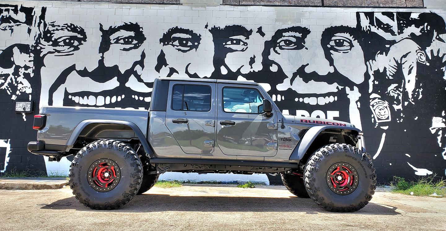

I ordered the version with the Black Max shocks. They are decent travel at 12.5" up front and 11.75" in the rear. I don't plan on keeping this kit forever, but happy with the ride quality so far.
I have 41" Irok Radials sitting in the shop that will go on when my wheels get finished
you ever get those wheels installed? like to see a couple pics.

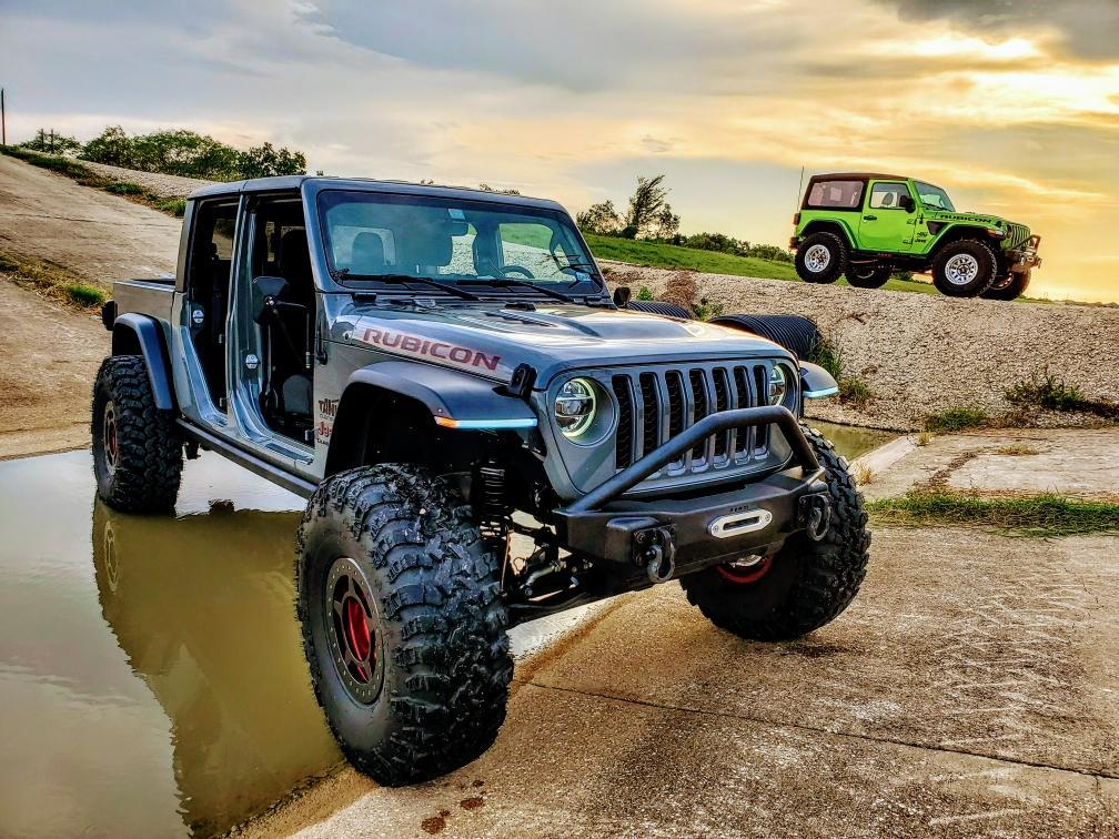

Chris, can you share what you did with the front fender, looks clean.
The front fenders are two piece. By separating the bottom half and trimming off some tabs you gain a good amount of clearance for bigger tires.
Once the lower portion is removed then uppers are kinda floppy, so I used a Quake fender brace/DRL kit to reinforce them and retain my blinkers.
You lose the inner fenders, but @JcrOffroad makes some nice replacements for the front/rear.

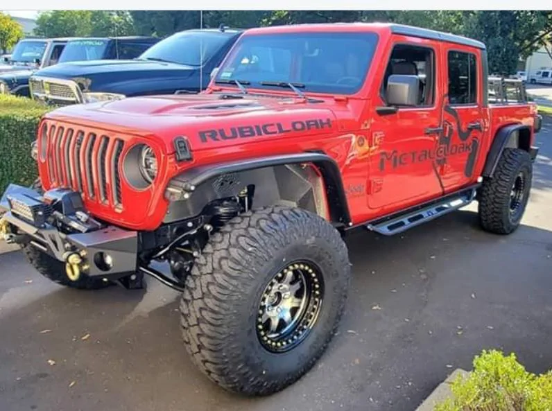

I did not go back to the show today. The Metal Cloak JT lift is much like the JL lift up front the big difference being the rear dual rate springs. Rock Krawler had a 4 Link system at the rear of their new JT lift unfortunately the person i was talking to did not seem to know much about it just saying that the ride was great. Terraflex did not have anything yet for the JT saying that they needed more time and were not happy yet with what they had in R&D.
