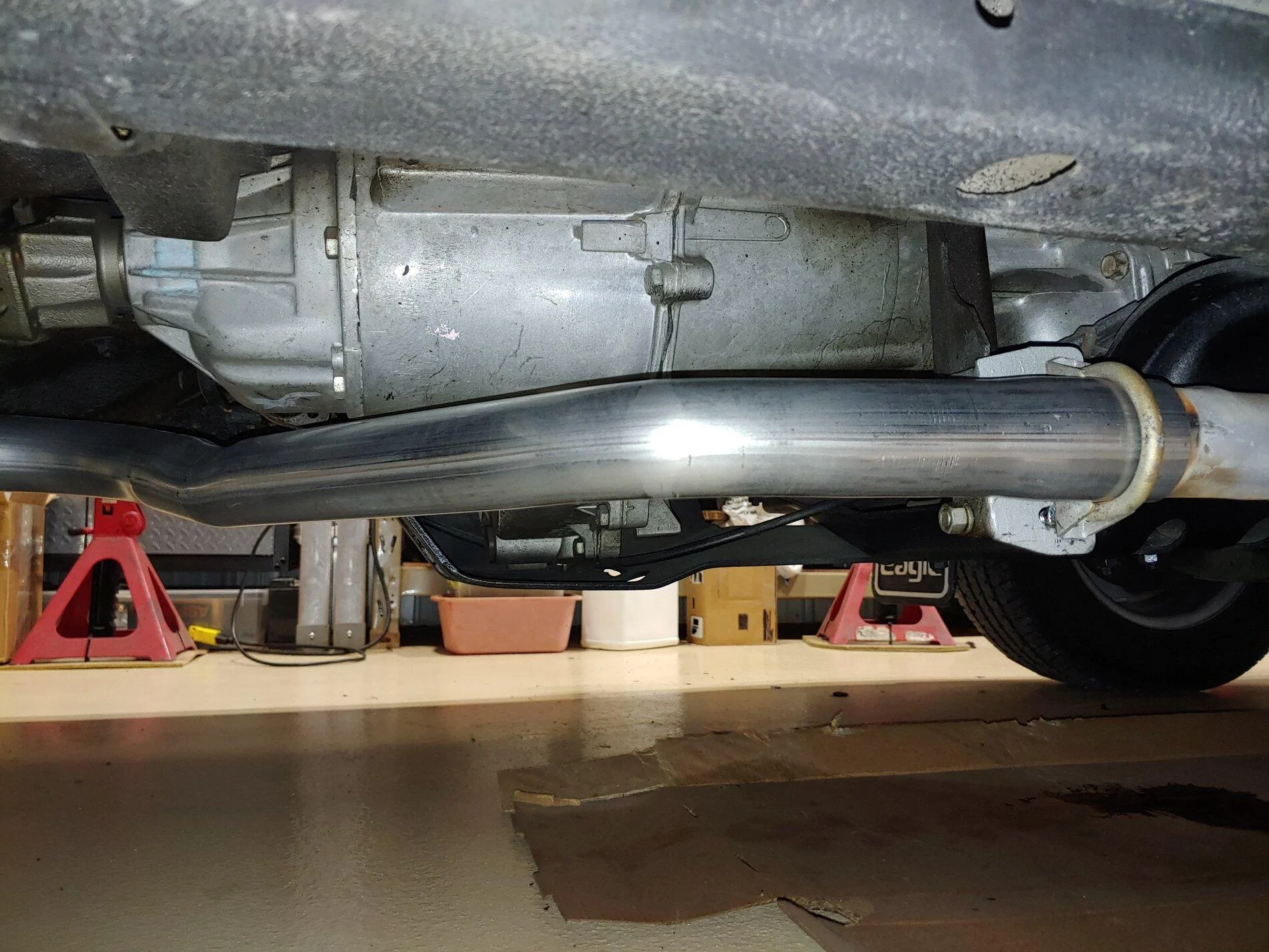

Below - 1982 car. Been in Iowa since 2007. Has been driven in winters in the past. No rust. I wash it under there regularly. The car below has over 193,000 miles on it.

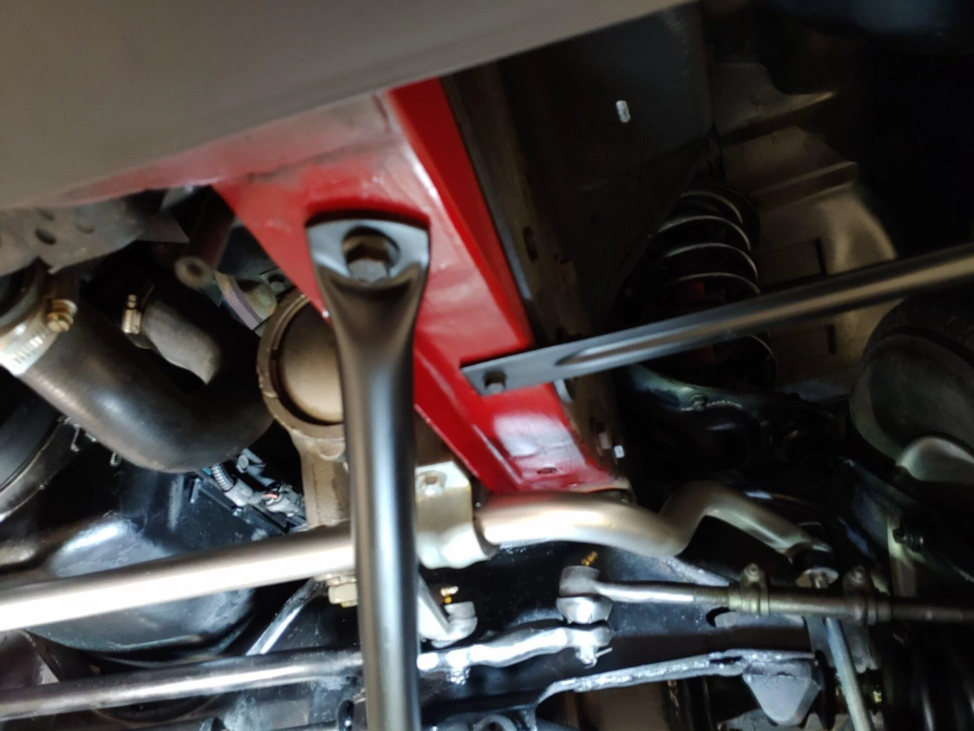

This ^I drove on the beach a lot with my jku. Id rinse the under carriage after every trip, but still got funk under there. I took to once a year hitting most of the underside with rust converter and then black engine spray paint. Kept it so nice the dealer always commented on it during service.
havent done this for the Jt yet, but its in my radar.
