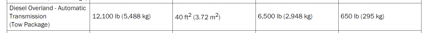

It's crazy that a towing rating isn't a rating anymore. Well it's 6000 pounds but please enter the frontal area of the trailer, the temp, the elevation , and day of the week into this equation to determine today's towing capacity lol
When they design for, and specify a max GTW, they must be considering some maximum uphill grade you might encounter (for an assumed amt of time and speed) which is when GTW has the most profound load on the truck. I wonder if, in real life, that gradiant is ever exceeded by a significant amount?

The ratings are different now because they are real. It became an advertising war. Sure that monstrous full sized pickup could tow 20k lbs on the flat. But the second you went up hill it overheated.
Now there is a standard with a protocol. The incline is the same, the trailer size is the same, the temp is the same.
Its SAE standard J2807.
Google it and read and you will know more about it than all of us.

See I feel that the ratings are real using the standard in that companies needed a way to quantify how much they can push the towing number while skirting liability. I traded my 2018 F150 (2.7L) for this jeep. Although I have a diesel, The max tow Glad has the same tow rating as my F150 did but I would feel way more confident in the F150's ability to actually pull that.
Another problem specifically with jeep is that part of that towing standard is the davis dam test in Arizona when over 100 degrees out.
Jeep struggled to cool the diesel gladiator (not sure if that is the issue). The problem is people are most likely to be pulling near max capacity when they go on vacation. Jeep people tend to go to places in higher elevation on vacation (Colorado, Moab UT, and so on). Davis dam is 600 ft elevation but people are going to be pulling in Colorado at 100f, on similar or worse grades, >=10000 ft elevation.
I know ford says to adjust decrease GVWs and GCWs 2% per 1000 feet for the F150 (8% in Calgary) I wonder if this the same relevant or worse for the gladiator given it's problems cooling.
Obviously there are other concerns with the frontal/area.
Either way, the truck didn't derate, so I assume this problem wasn't specifically related to cooling. I am not sure what other problems he could have caused by towing more than recommended that would have been the cause of this unless it was his brakes or something
