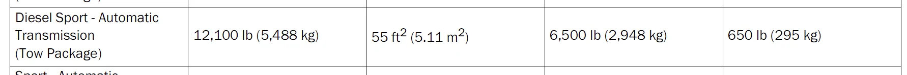

It's 6,000 on the gas, is it the same for the diesel? Dunno - my manual is for the 2020 gas.
Your point is good on the frontal area according to the book.
It's crazy that a towing rating isn't a rating anymore. Well it's 6000 pounds but please enter the frontal area of the trailer, the temp, the elevation , and day of the week into this equation to determine today's towing capacity lol
If the trailer was truly 8x9 it would be 72ft² then right? I think for the overland 40ft² max with tow package and ecodiesel.

Similar sports (like mine) with tow package+ecodiesel is 55² instead of 40ft² . I wonder what limits the overland to 40ft² with

Frontal area question - Other than a pop-up or small teardrop are there any trailers that would fit the bill of less than 40 SF or 55 SF? I ask because Jeep shows the Gladiator pulling an Airstream in their ads which has a frontal area of ~72 SF, which is well beyond both. Also, for kicks I checked the Ford Super Duty "Frontal Area Considerations" and they show 60 SF for bumper pulls and 75 sf for 5th-wheels. I think you would be hard pressed to find a 5th-wheel less than 75 SF and as far as I can tell, there aren't very many travel trailers smaller than 60 SF. Is the calculation something other than height x width of the trailer?
