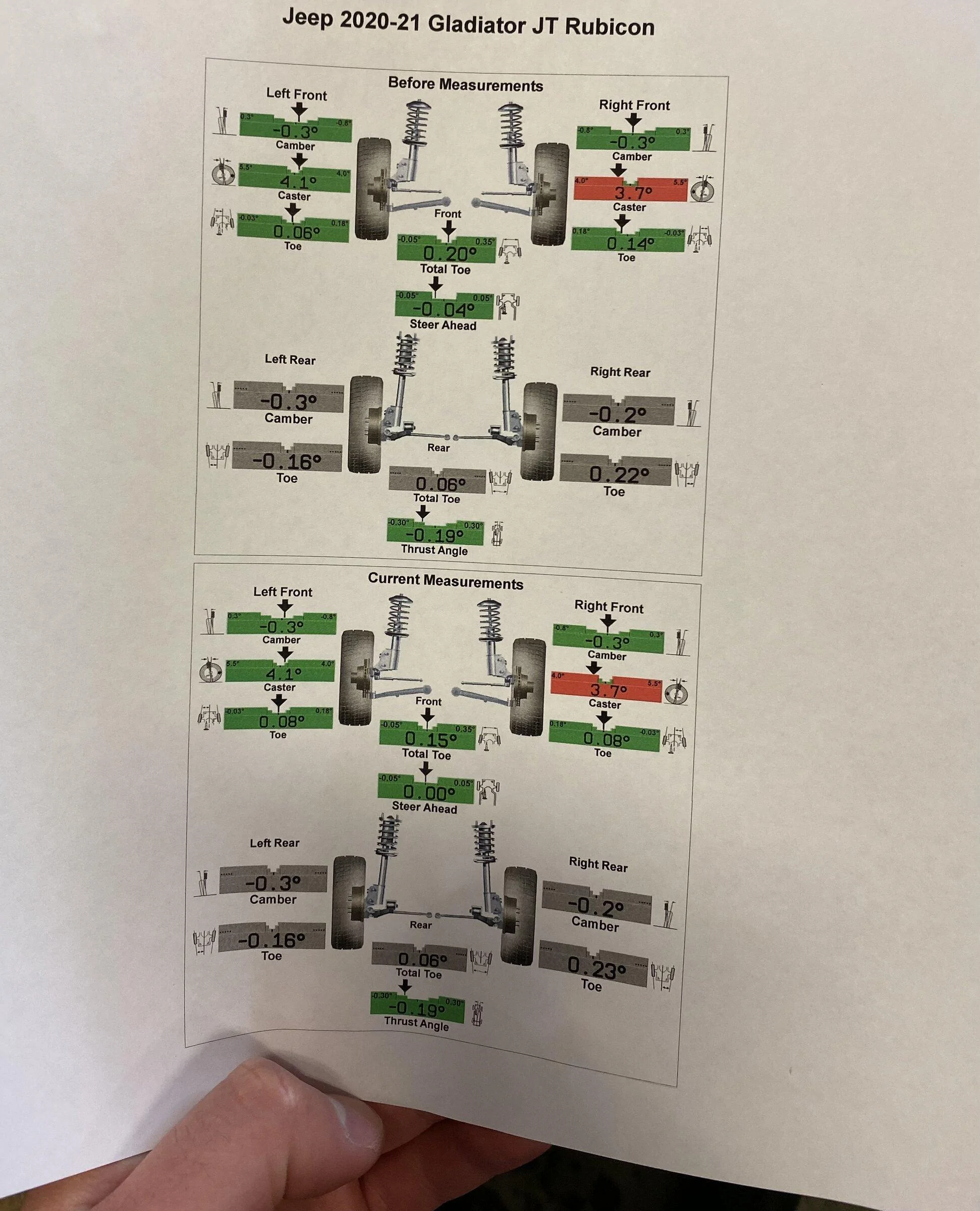

After the new steering box, Synergi Track bar, new stablizer and asking the dealer what could I do next they say to lift it….. my vehicle is wandering stock and the dealer recommended to lift it to improve the driving on highway speeds. I’m not one to throw more money at something to fix it, considering the Launch Edition was over 60k. Has a lift helped people with wandering issues?

After reading some other forums, I am purchasing adjustable control arms to help the geometry. I went with Terraflex the full set alpines. Fingers crossed!

Caster is really low, you should aim for 5.5 to 6 either using adjustable control arms or geometry correction brackets if you lift your JT You could add the Mopar lower control arms to your stock JT they will get it close to where you want to be.

I had wander issues with my 2020 when I bought it used this past January. Chalked it up to a Jeep Thing. Did the steering gear recall then put a Rough Country levling kit on with the synergy Track Bar. Then I had not only wander but Death Wobble at 55+mph. I then added the Mopar factory 2" lift Lower Control Arms. They're a 1/4" longer than stock. That seemed to fix a lot of the wander but still had the DW. Finally bit the bullet and put in the Synergy Tie Rod, Drag Link set and longer front shocks to get rid of the shock spacers. I then took it to my sons' shop for an alighment. Set it up as follows:
Total toe = .33 degrees
Checked Caster (non-adjustable, just the Mopar LCA's) = 5.1 (Driver) and 5.0 (Passenger) degrees
Didn't bother with a camber check
It now has no noticable wander and no DW.
I also heard that Jeep is instructing their techs to set total toe at .35 degrees.
I also put in the Exact Center Stabilizer from Roadmaster. That helped a lot too to keep it centered on the road.
IMO, you're low on both caster and total toe.
When $ allows, I plan on going to adjustable LCA's and push caster out to around 6 degrees.
Yeah, that caster is lower than mine was!

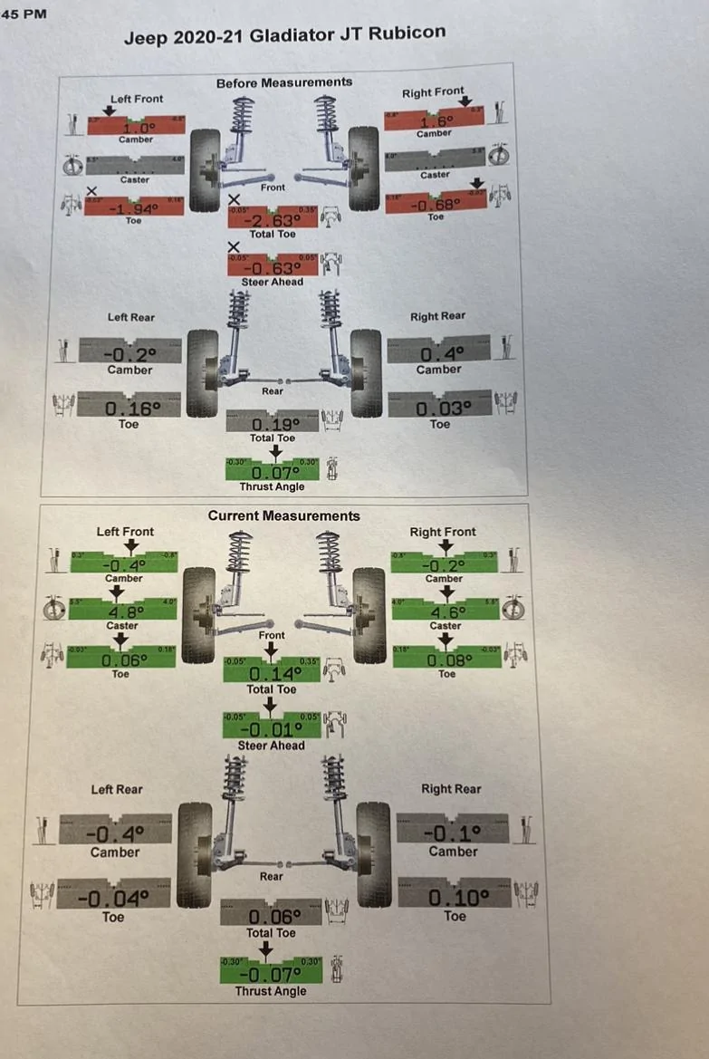

Updated alignment after the Control arms! The ride is so much softer! Drives like a Mojave almost, but the lift I’m sure will change that lol. After I wear the Wildpeaks down, I will be getting the mopar 2 inch lift and 35’s. I think I will stick with Falkens as well I enjoyed these quite a bit!
