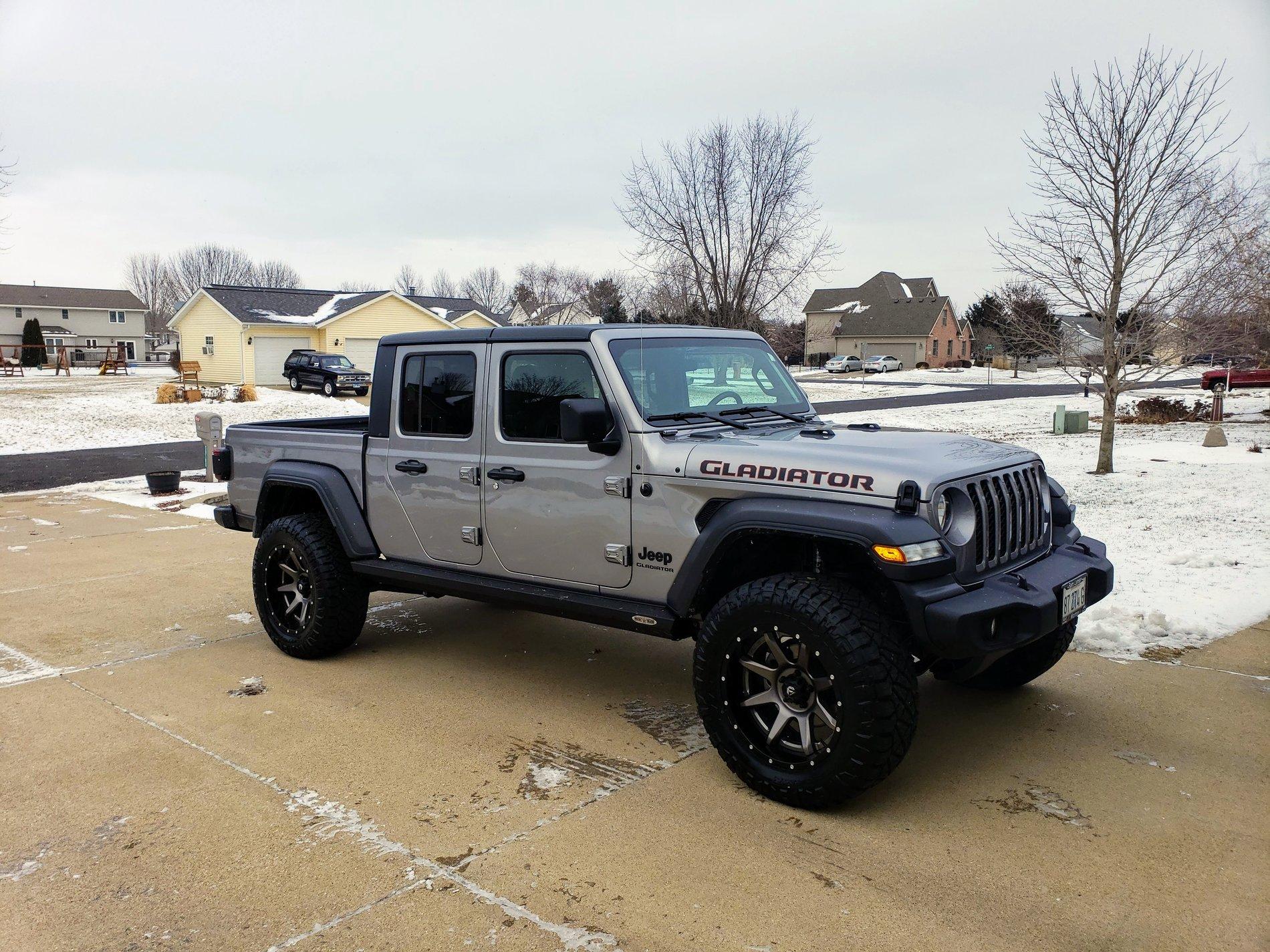

I love those wheels, you Jeep looks great! I seriously considered those for the offset and look. Thinking I should of considered harder. I like what I ended up with, but I am still thinking I need to try a set of these in the future. Thanks for posting.
2" Mopar lift 35"s on 20" Rhino armory wheels
I am on 20x10 Fuel Rampages, with 35x12.5 Trail Grapplers

Ok, mopar lift on, gave me 3 inches all around give or take. I need a bigger torque wrench for 200ftlbs. 37 Cooper stt pro. I love these tires, factory LE wheels with spacers.
Whats thw verdict now after a few months with the big tires on the stock wheels? Also what width is the tire?

Replaced the 35" Nitto Ridge Grapplers with 37's. Still the 2" Mopar lift, but I'm going to add the 1.5" leveling kit and a track bar next week. Enjoy.

Your JT looks great as is. I’d be concerned about adding another 1.5” up front. You not only will need a front adjustable track bar but also will need new front control arms to correct caster. Seems like you are setting yourself up for some potential problems. If you are happy with the way your gladiator drives now I’d really consider leaving it as is. Just my opinion.

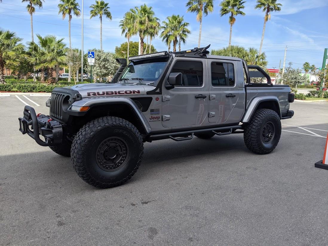

MOPAR 2"
BFG KM3 39x13.5r17 :rock:

Hey Mark - Just wanted to let you know I purchased a Rubicon Express Track Bar today and installed it tonight.
Tires are now equal distance past the fenders Test drove it and all is good. I honestly didn't notice a change in the ride at all which speaks to my comments earlier that the truck drives really nice even with the added spacers
