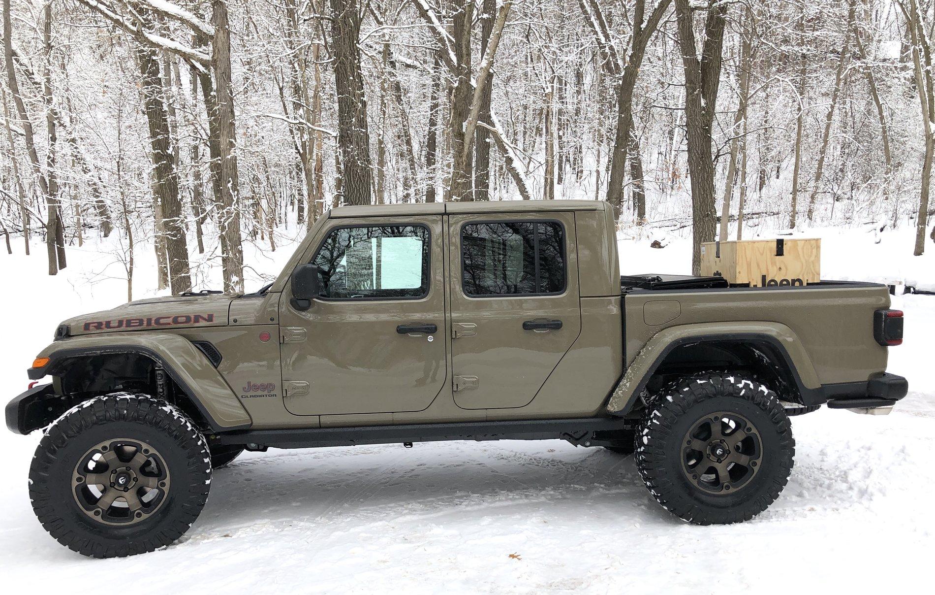

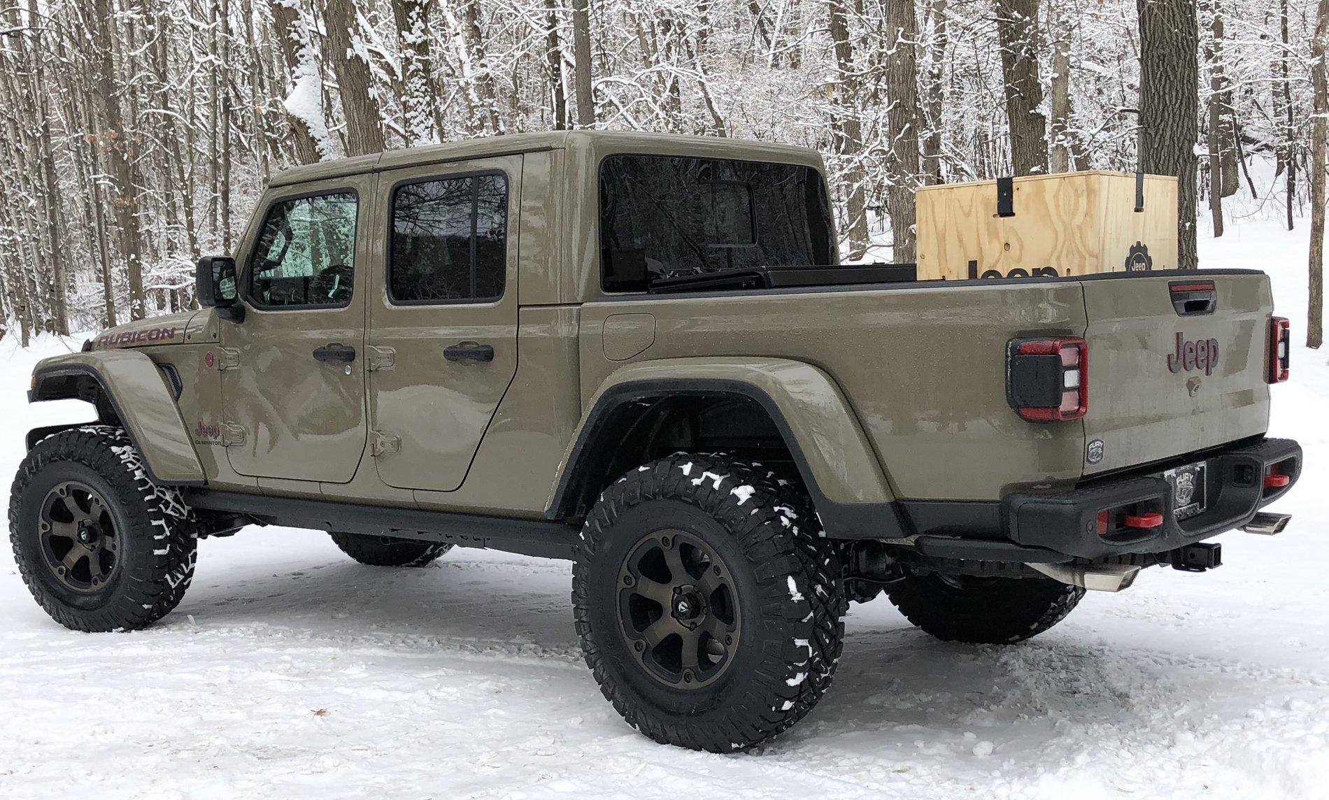

Wow!!! Pure awesomeness! What did you do for spare?
Thanks! I haven't mounted my spare yet, I am considering a few options but also waiting to see if any new products are coming out soon for mounting a larger spare

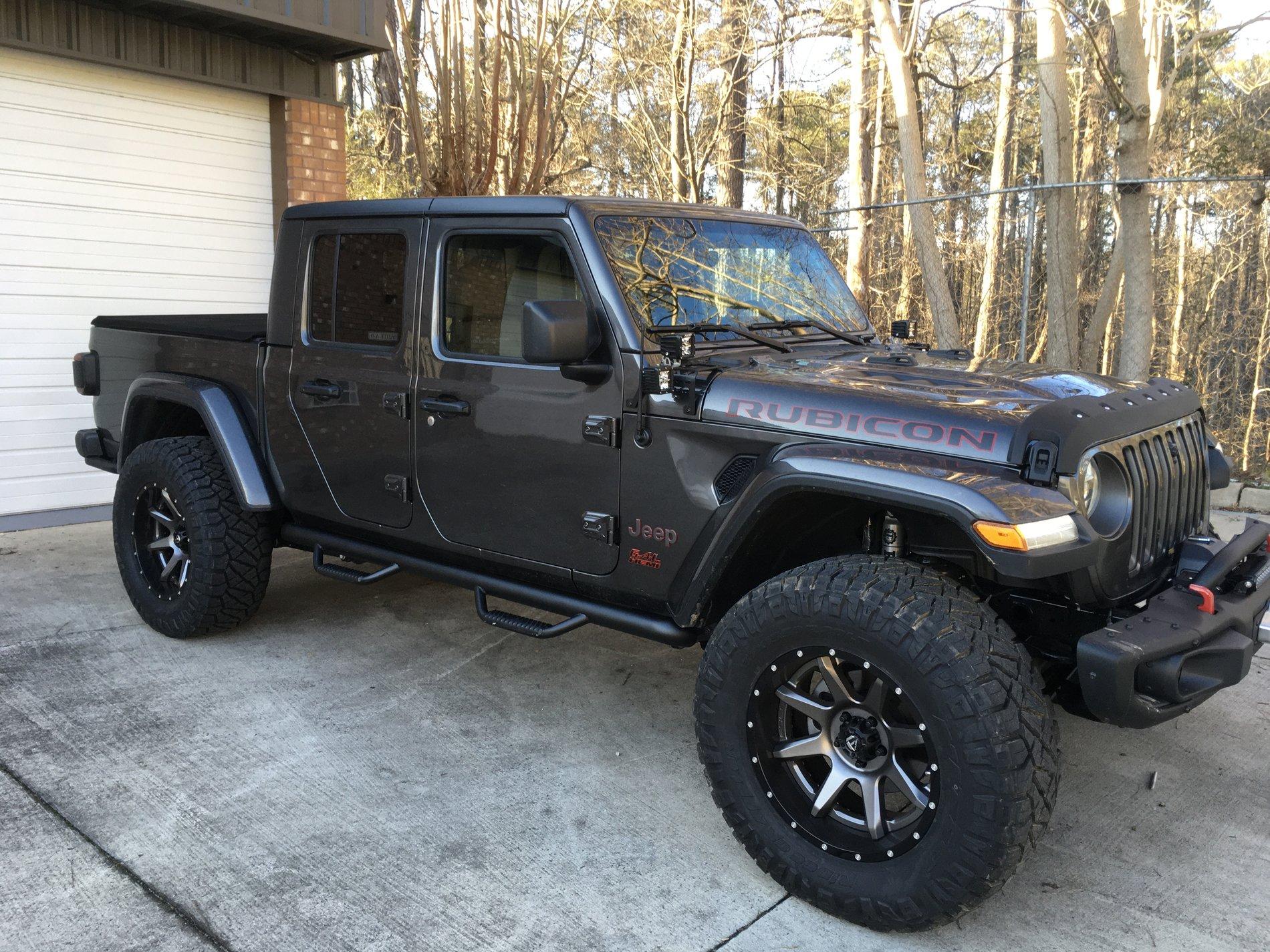

Mopar 2" Lift Kit with Fox Shocks, 1.5" leveling kit (front only to address future bumper, winch weight), Nitto Ridge Grappler 37x11.50R18LT D 127Q tires, Fuel® Off-Road D564189073 Beast Wheel In 18x9 +1 offset black with dark tint.

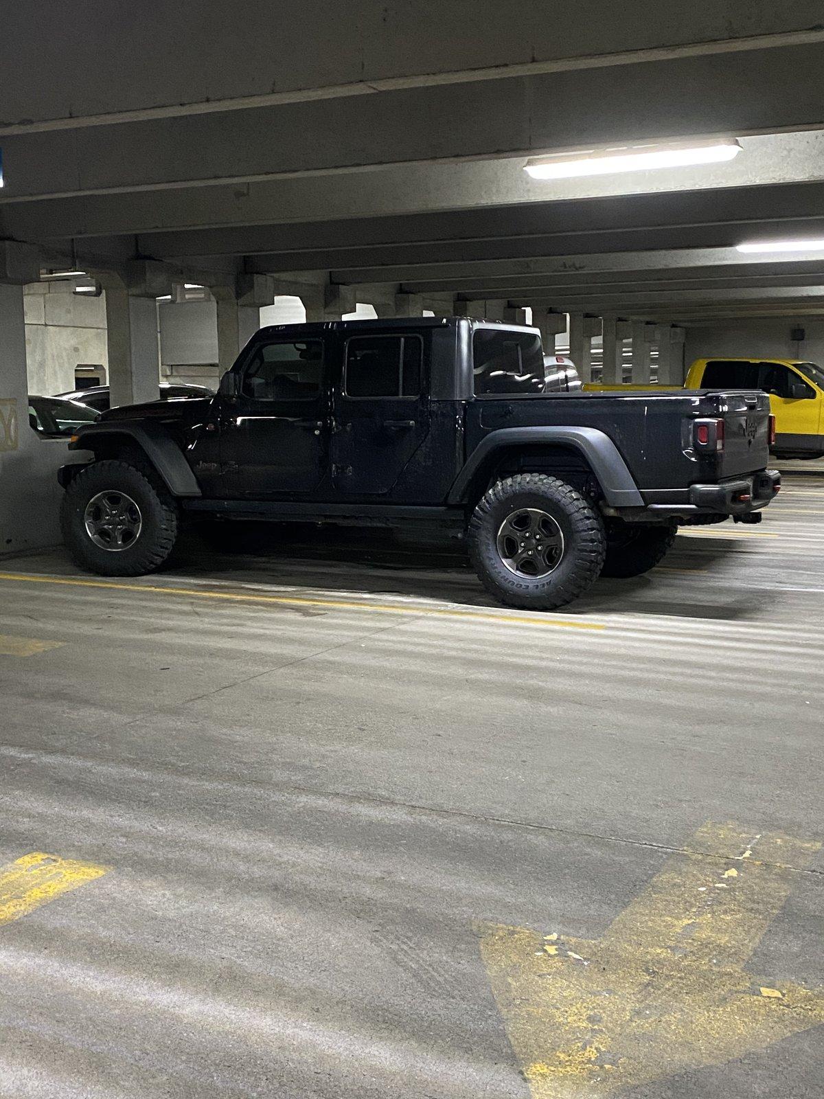

it’s been great! did some small crawls with no issue and haven’t had one issue on the highway at 80mph. I do mostly interstate driving and avg about 18mpg (21 if i keep it under 65) after getting the speedo recalibrated.
Jt_chief, did you rub spacers with stock wheels because you had to or wanted to? Thinking of going 37x12.5 on the stock overland wheels but don’t want to get spacers
