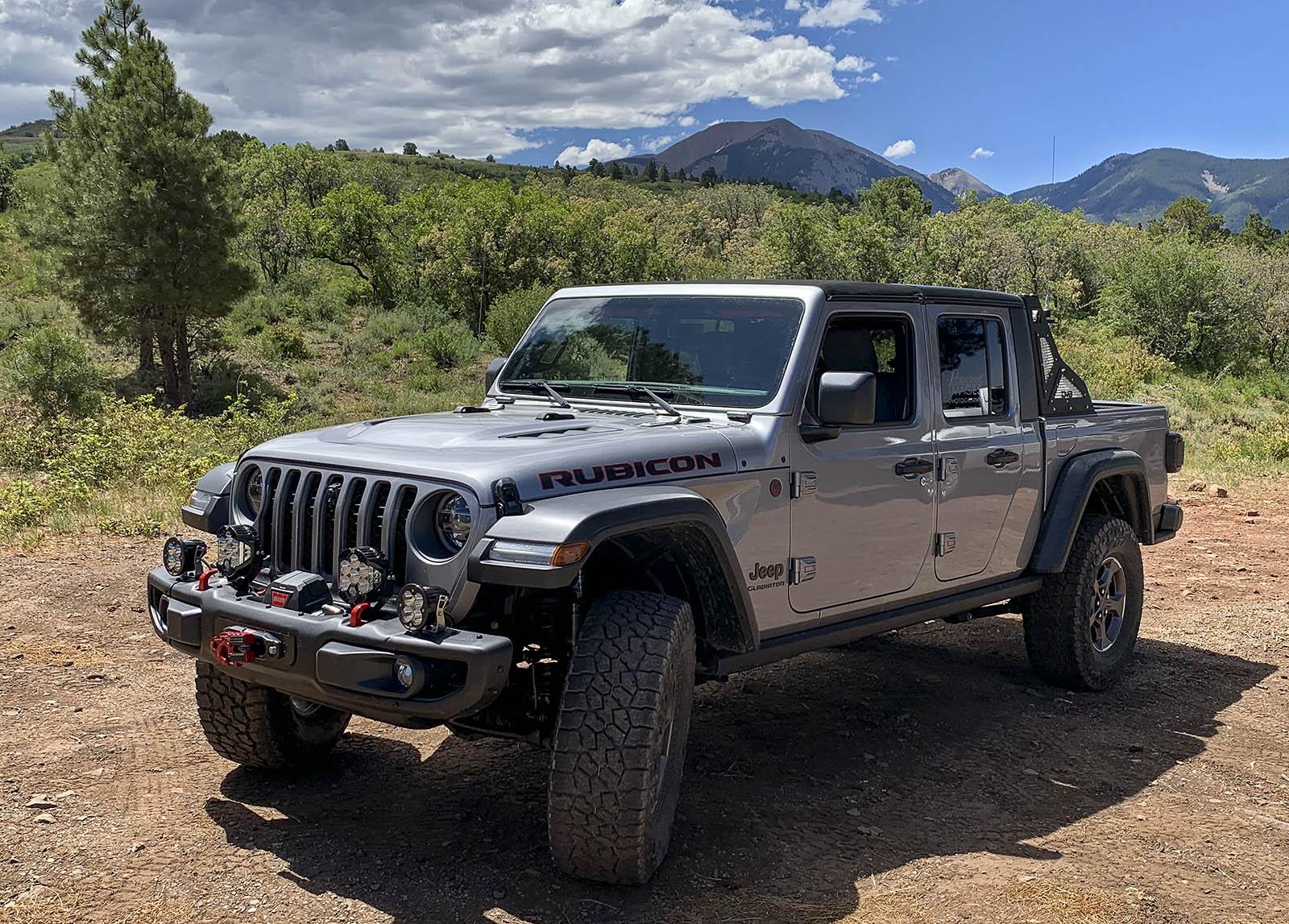

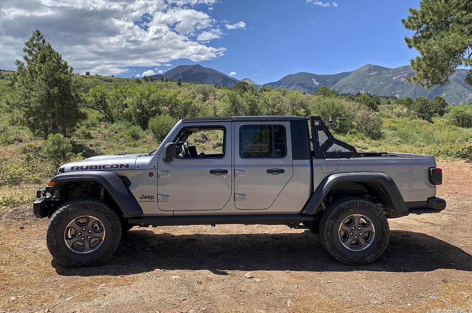

After almost a year and 10,000 miles, I finally decided to lift it...Mopar 2" with 35" Falkens:

How much better is it?
Huge improvement. I ended up buying a Max tow over the Rubicon because of the ride. I was not impressed with the on road manners of the Rubicon. The Mopar lift has larger diameter Fox shocks than the stock Rubicon Fox shocks & I think they are tuned perfectly.

This looks great. Did you add any other parts when you originally lifted it, or just the Mopar kit and wheels/tires? Were you happy with the ride? I’m curious if other relocation brackets, etc. are needed. Did you have to do any trimming? Thanks!
Thanks man. Sorry taking so long to get back, I was on a weeklong camping trip up around Big Bear Lake, just returned home yesterday.
originally it was just the Mopar 2” lift, I then installed 1” spacer on the front, after I installed steel front bumper and winch the rake was a little more pronounced so I added an inch up front. Then a Fox steering stabilizer. I also installed JKS Quicker disconnects which have no change in ride characteristics until you disconnect.

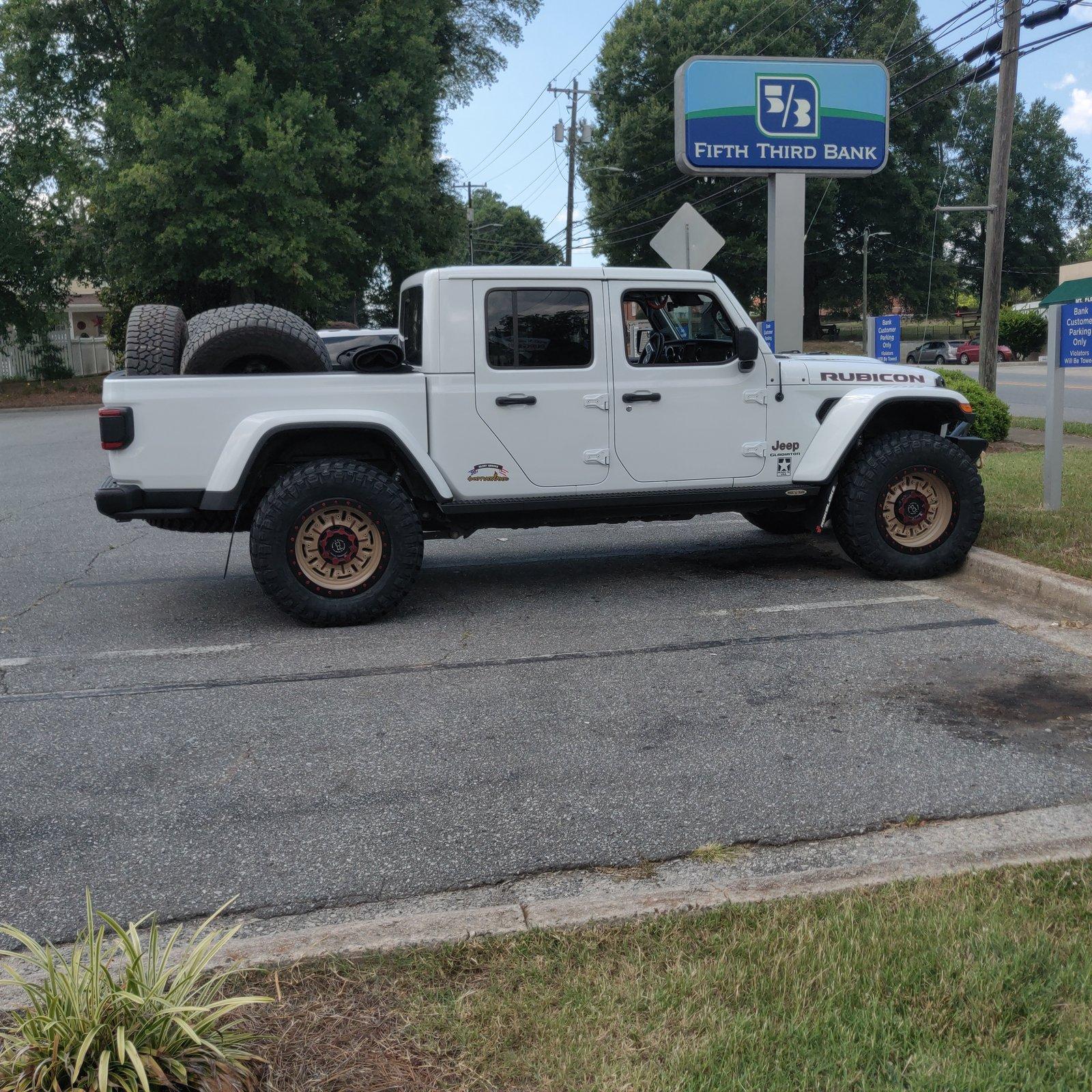

Looks great man! Big difference from Saturday with the stock wheels/tires!
Yeah I know. I was nervous I wouldn't like the sand color but they look better on than in the bed of the truck.

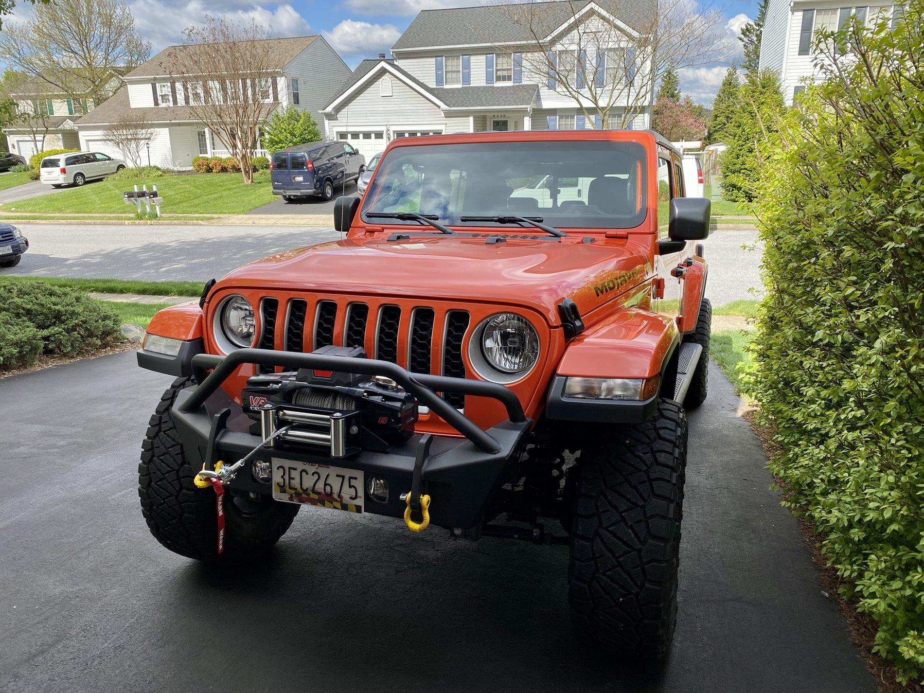

How's the bumper?

I was looking at the black rhino armory in sand. I think it looks great on the white.
Bumper is waiting patiently for the winch and plate to show up. Far more patiently than I am, that is for sure.

2" Mopar lift on 37's with Falcon 2 3.3 shocks.
