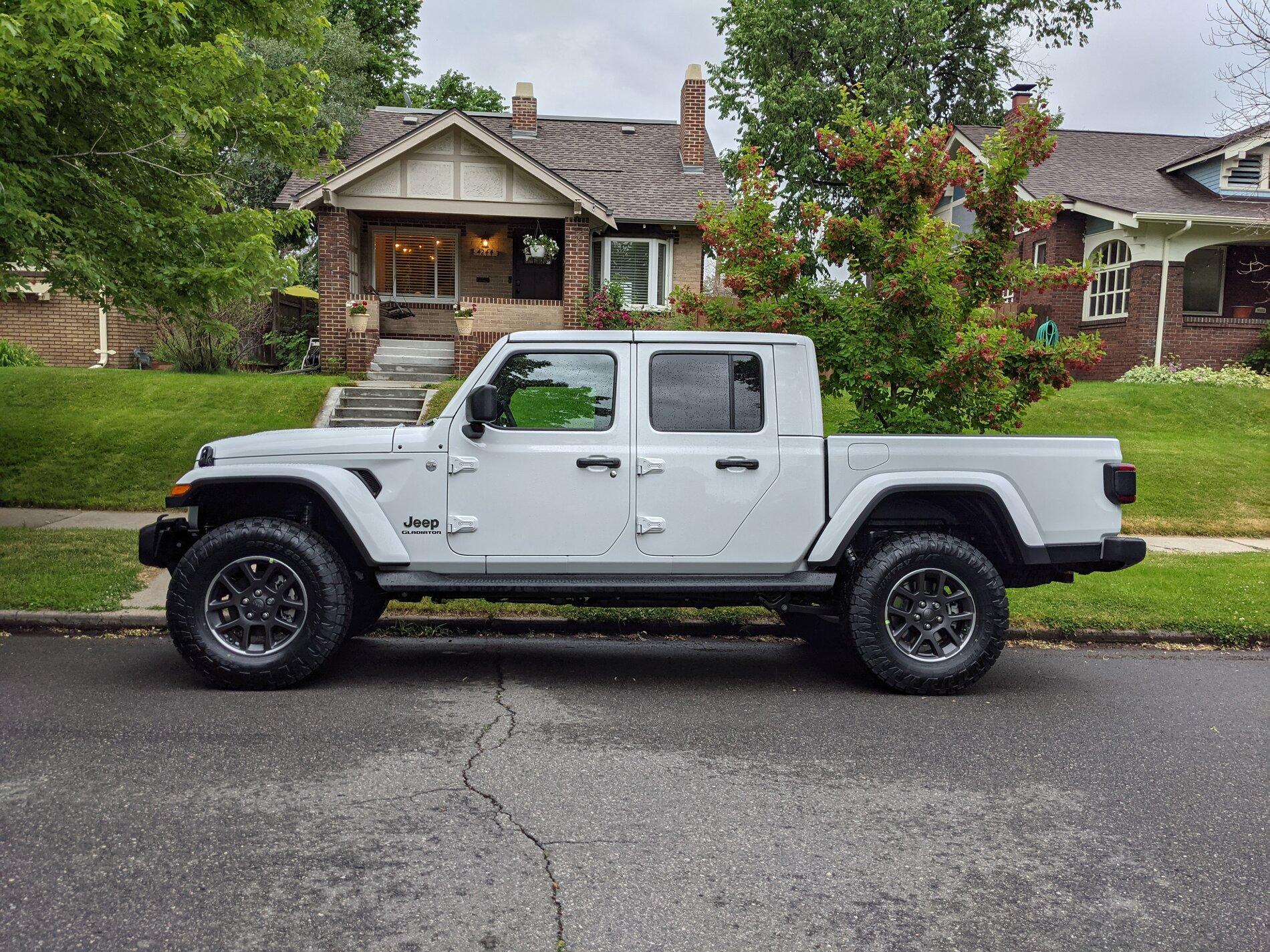

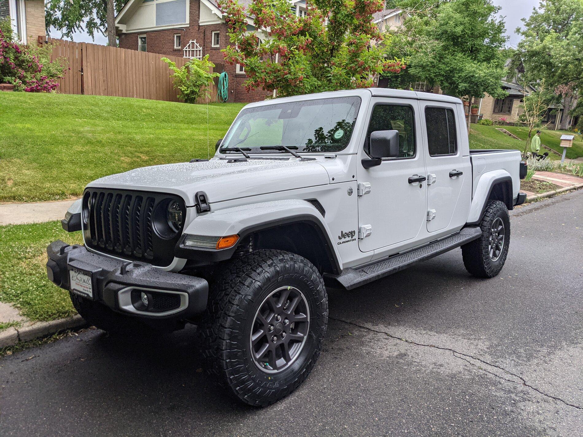

2" Mopar lift, 285/75r18 Toyo OC ATs, adjustable front track bar. I had the same setup on my JKUR and loved it, handled every trail I threw at it in CO and UT. I have an OEM steel winch bumper I got off CL and the Smittybilt X20 I kept from the JK yet to go on, so I'll see how that impacts the front before looking at maybe the 1" Teraflex spacer. I'll be regularly towing about 3k lbs so some rake is needed.
Jeep Gladiator Gladiators on Mopar 2" Lift Kit PXL_20210625_234034856.MP
Jeep Gladiator Gladiators on Mopar 2" Lift Kit PXL_20210625_234105948

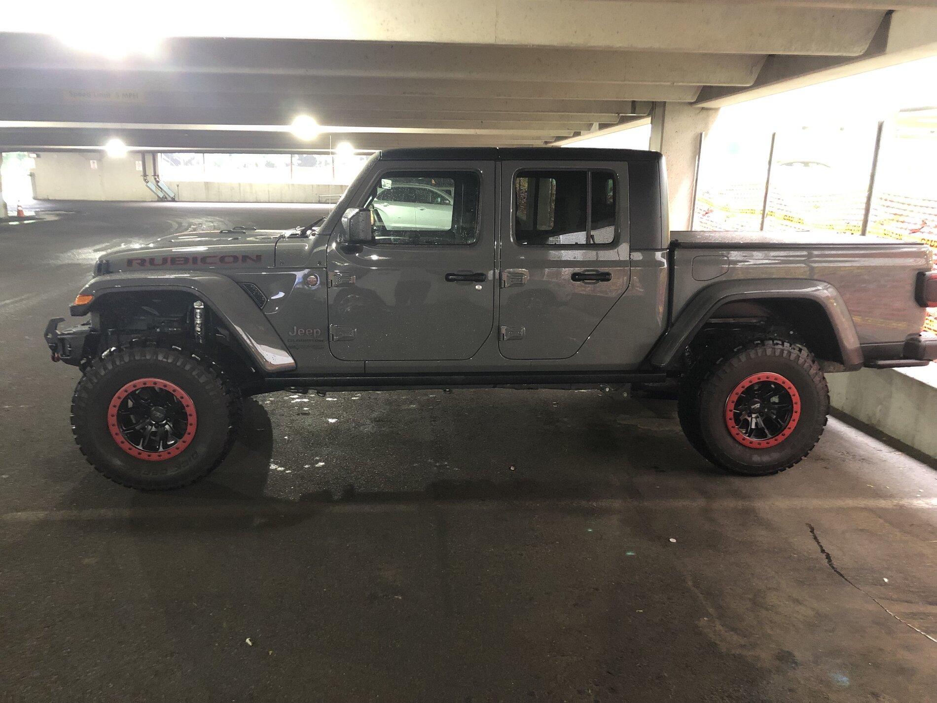

And now with Rubi flares. A complete PITA because they can’t be separated to paint unless you want to break the heat welds of the 2 piece plastic design. Not sure what you’re supposed to do if you damage one of the factory painted ones. If I was to do it over, I would have just gone unpainted

Just installed the 2" Mopar this weekend. It was a pita doing it myself with my garage setup but it turned out great! Torquing the control arms to 190 lbs is a bit tough on jack stands but do-able. Took it to the shop for an alignment and is driving great. Put on a Fox TS steering stabilizer to button things up and rides fantastic! Handling prior to the stabilizer was questionable after the lift and the stabilizer really firmed things up. 35" KO2s on stock LE wheels, Mopar 2" lift, teraflex 1" leveling puck (took out the 1/2" puck), Fox TS stabilizer and happy with the results. Winch is next to go in but deciding on which one...

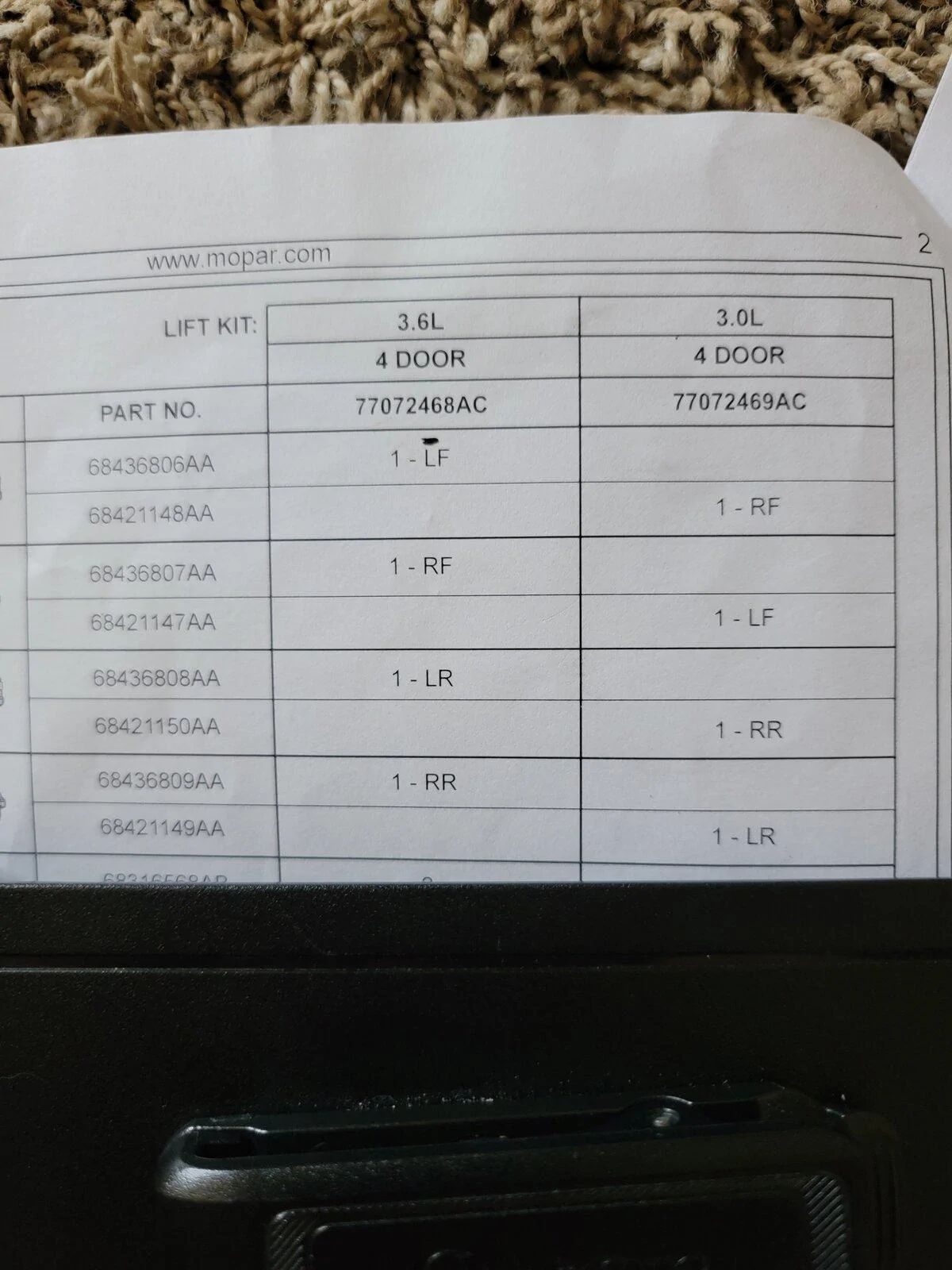

OK, looking for the Front and Rear Coil Spring for the Gladiator Rubicon 2" Suspension Lift , I have everything else and don't need to pay for the other parts a second time. Does anyone know the F7R Coil Spring part numbers for the 2" Lift kit
I didn't know if you have the 3.6L or the 3.0L, so I included both. If you can't make out the part numbers from my photos, let me know and I can post whichever ones you need based on your engine.
