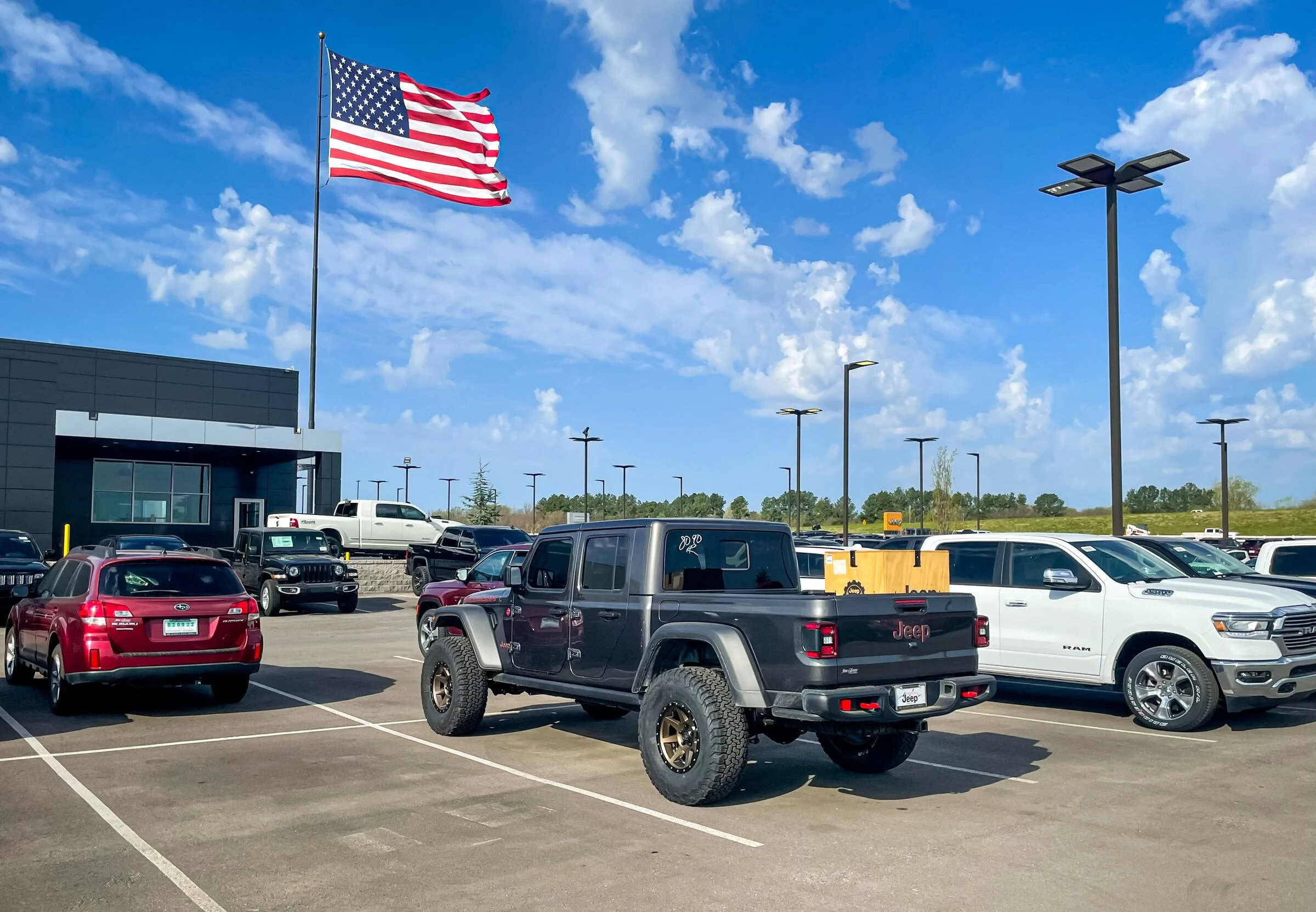

I'm running the Mopar 2" lift, 0.75" Daystar spacer in the rear to level out the truck with the added weight, 35" falken at3w tires and Falcon adapt shocks.

Yeah if you never plan on unlocking the front sway
hmm... I beg to differ. I have 37's with the MOPAR kit and have run trails with the swaybar disconnected and have had zero rub.

Negative. I've had my JT for 3.5 years. I've had the Mopar lift on for 3 years and 37s for two of those years. I offroad all the time. Rock crawl as well. And I disconnect every time.
