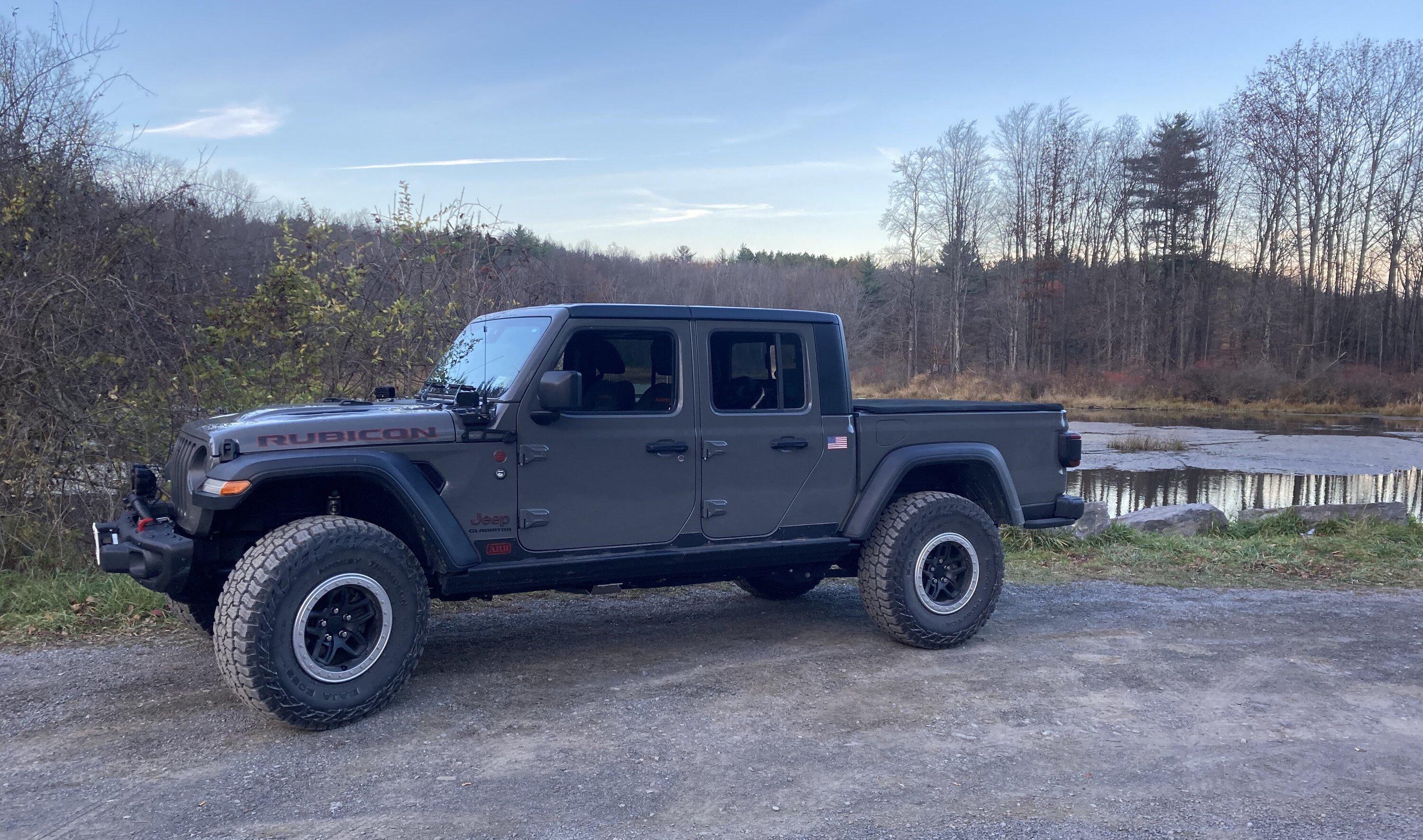

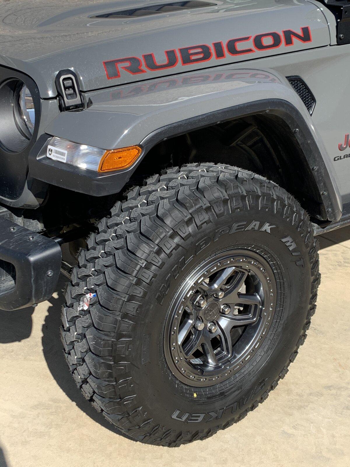

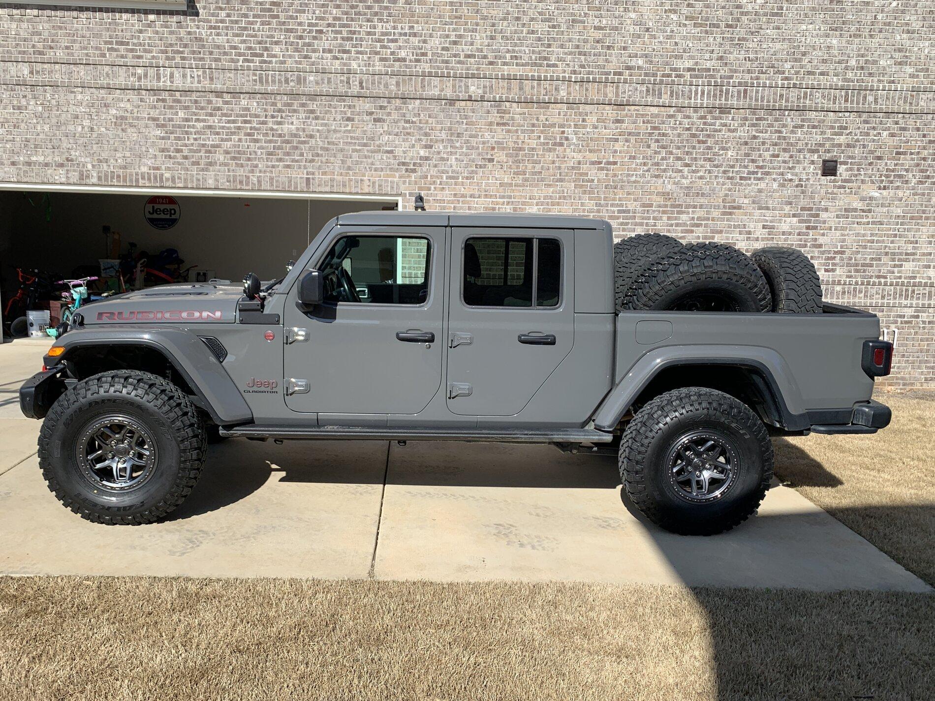

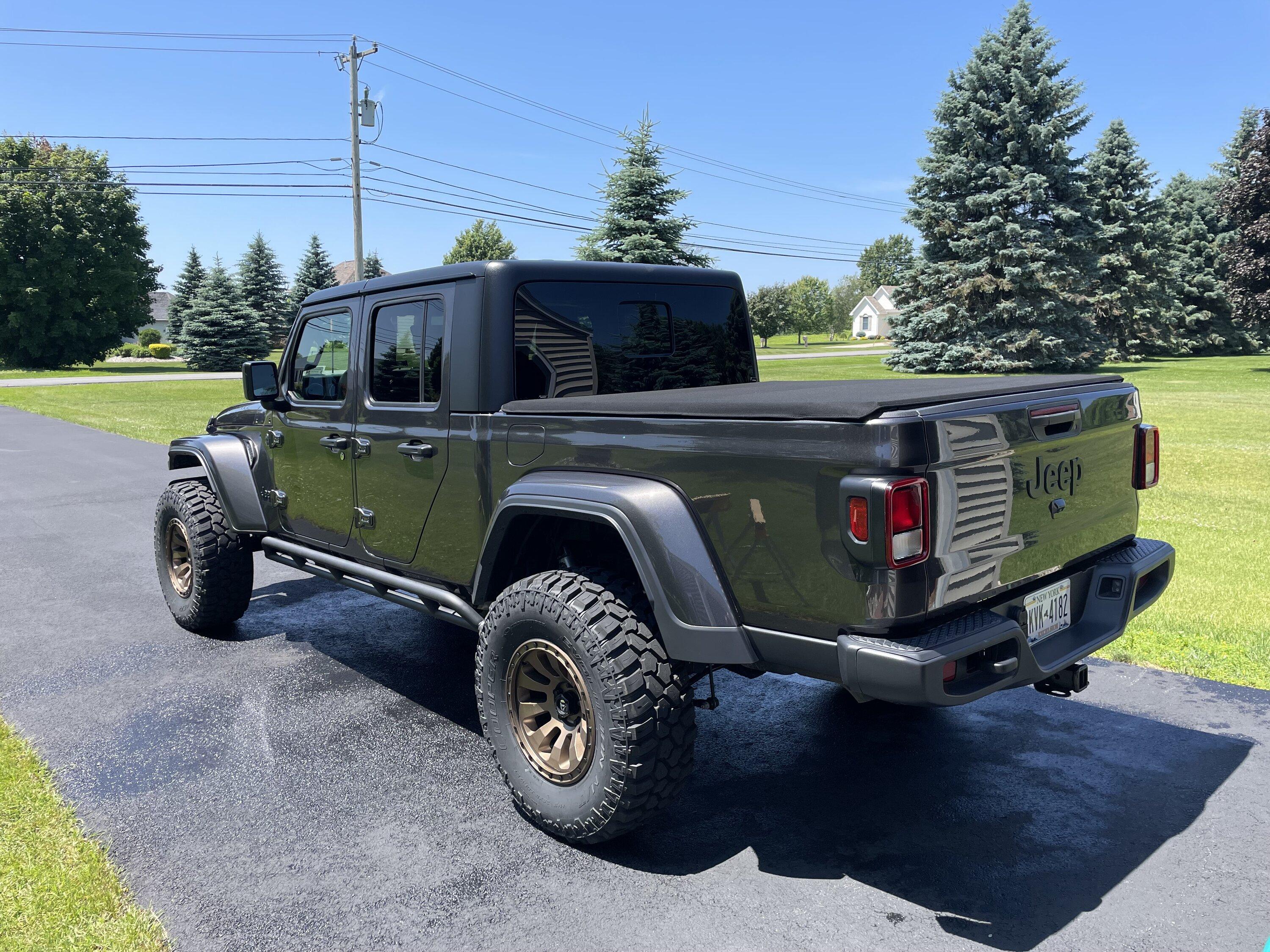

I installed the Mopar lift on my '20 JTR since I put the same lift on my '18 JLUR and loved it. Haven't had a chance to get it off road yet to see how it compares to the JLUR, but on-road is awesome. I have 37x12.5x17 BFG KM3's. 17x9.5 Black Rhino rims have a -18mm offset.
Did you do a gear swap?

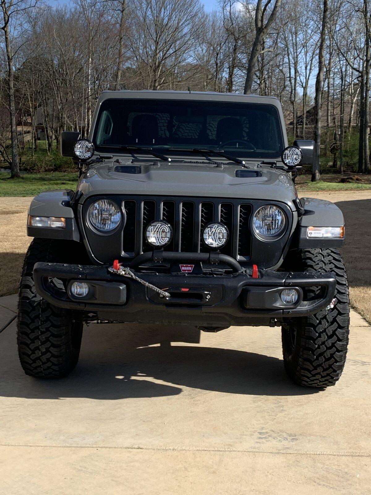

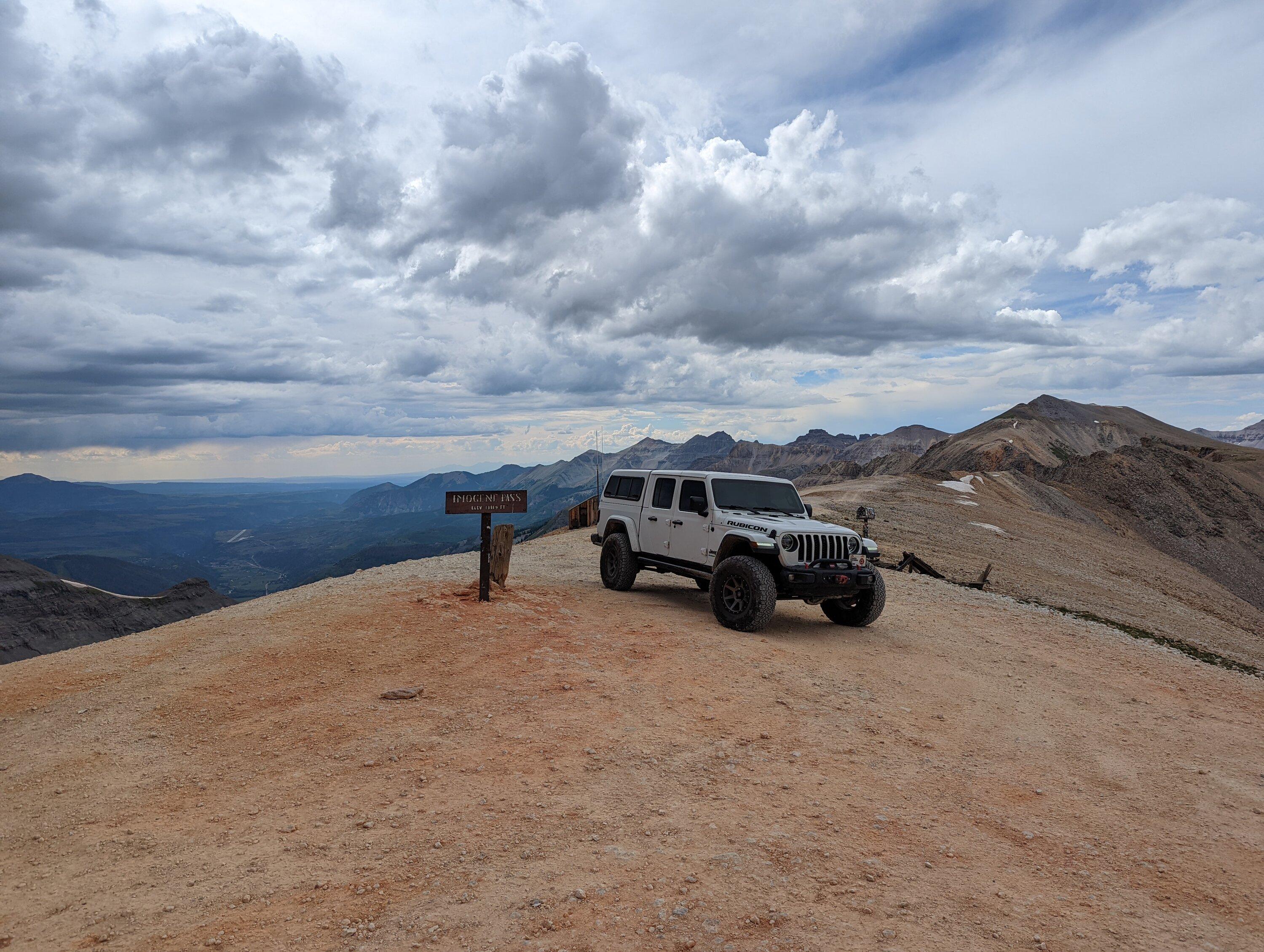

I’ve been running the 7707 2469 AC lift, which was the diesel specific Mopar lift that was released in November 2020. It’s got about 48K miles on it, highways, trails and some rock work. No issues. I ran 35” KO2s up until about 1K miles ago, when I bumped up to 37” Baja Boss ATs. All good.

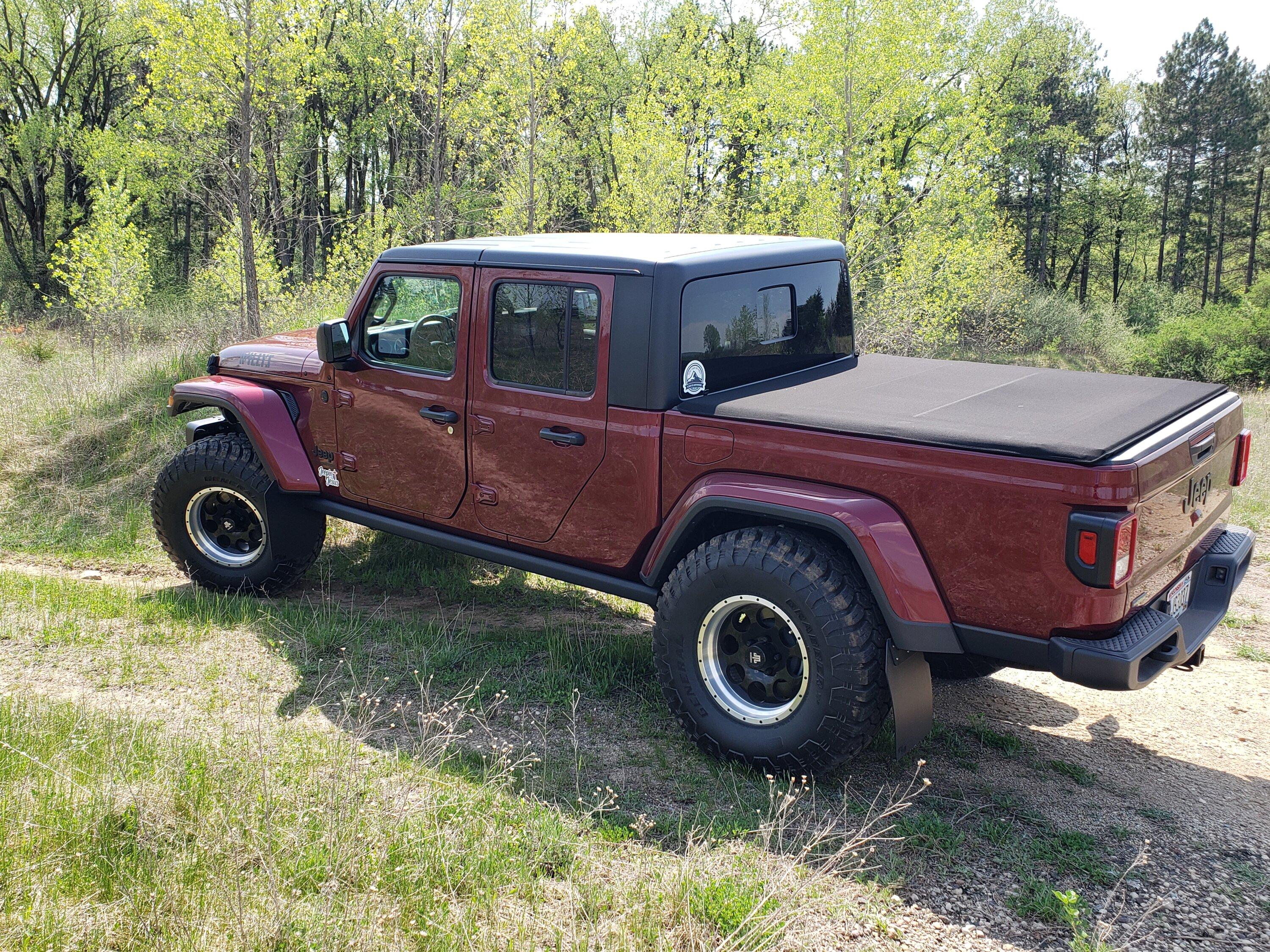

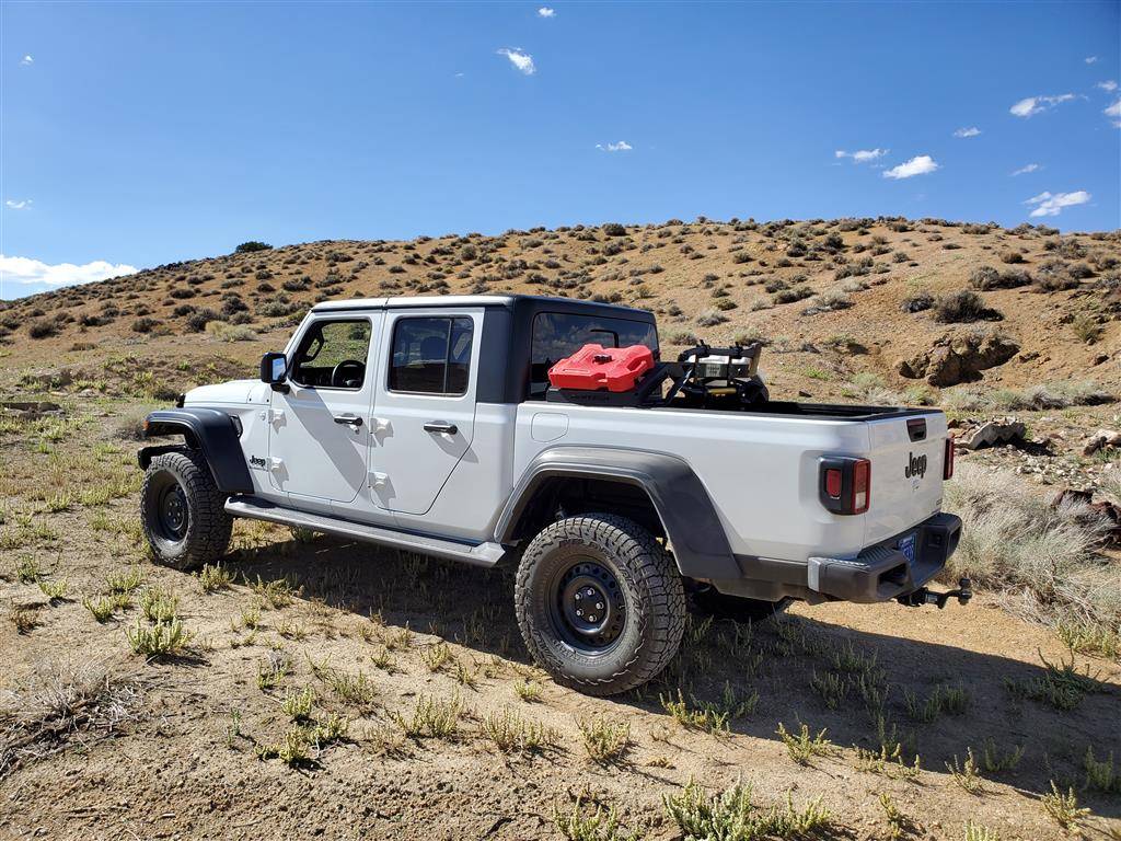

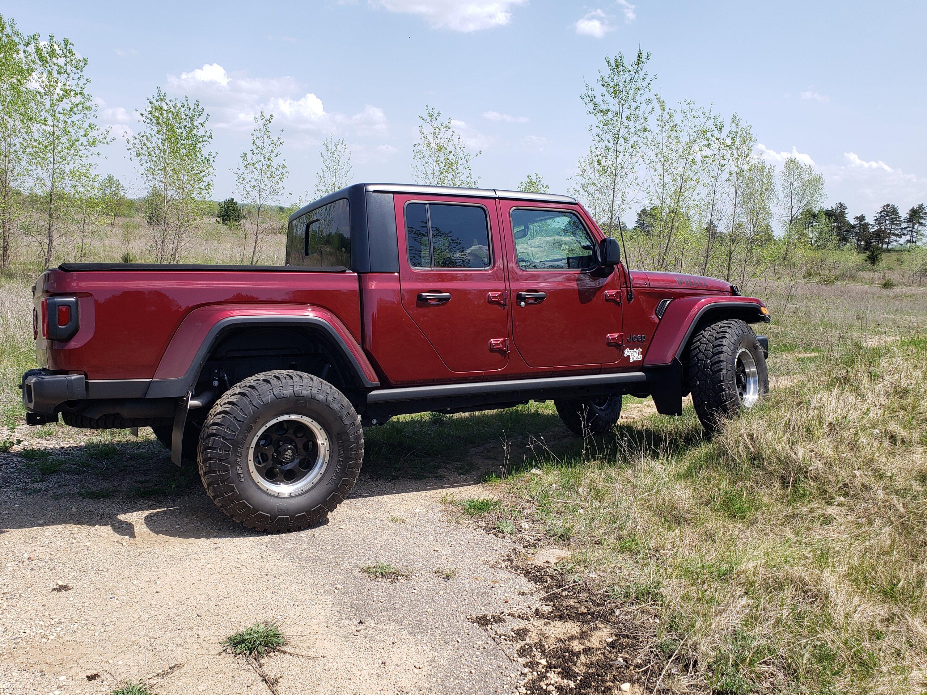

2" mopar with .75" spacers

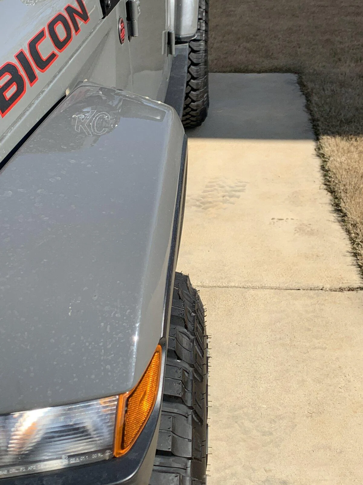

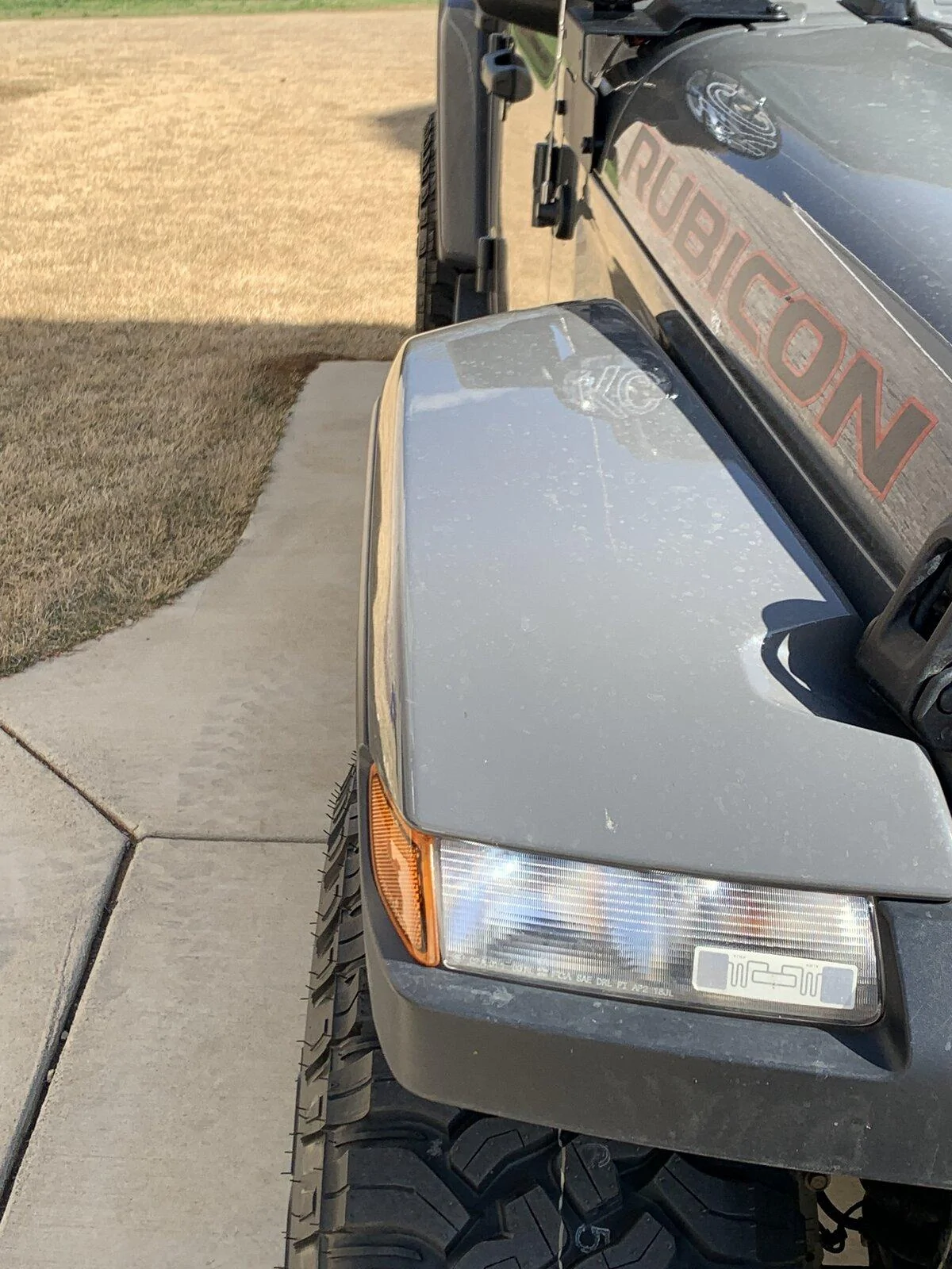

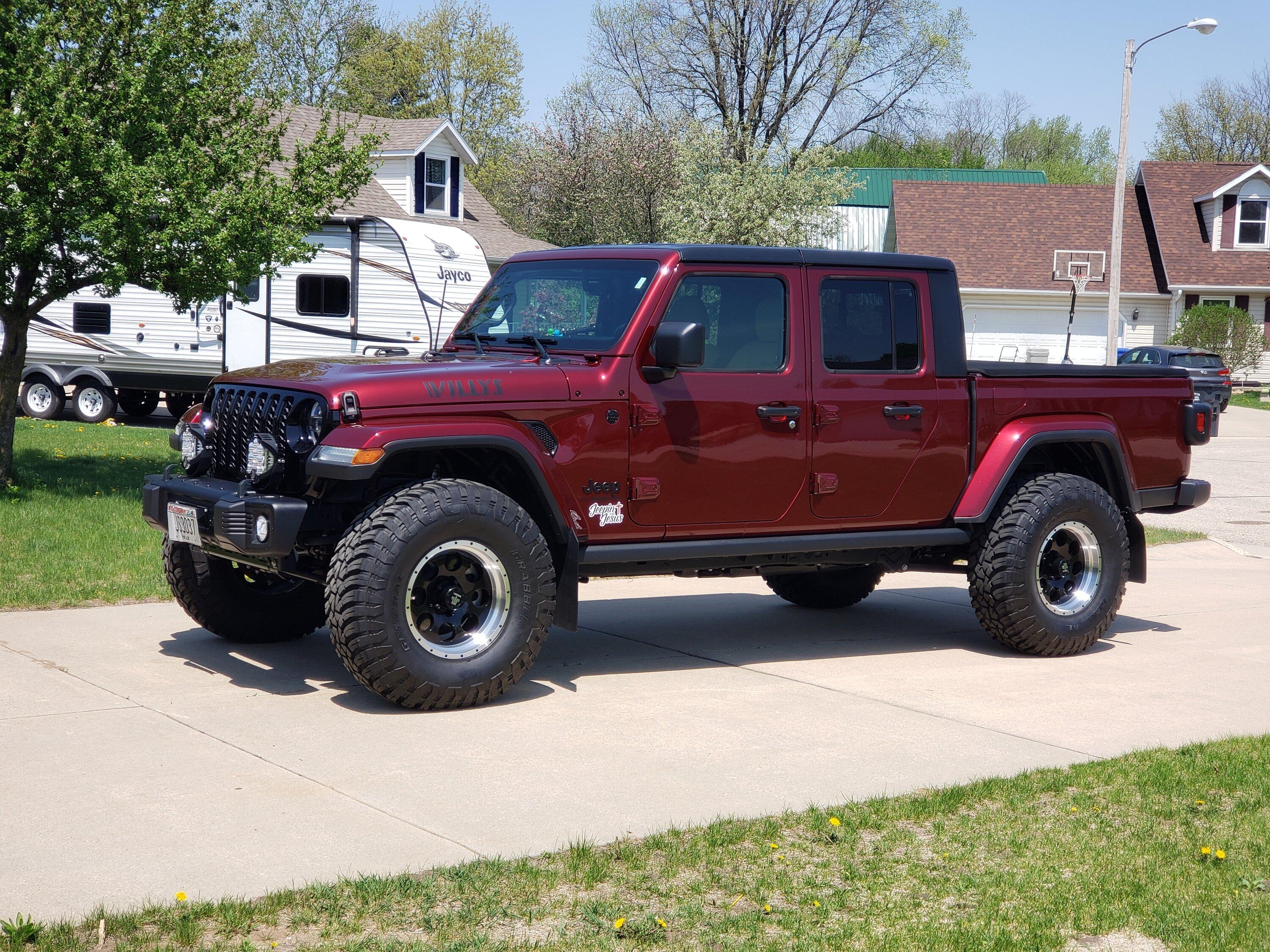

37x12.5x17 Falken Wildpeak MT01’s on AEV Borahs, in shop right now getting 4.88 regear. ***2” Mopar lift***
Did you notice quite a difference with the 4.88's?

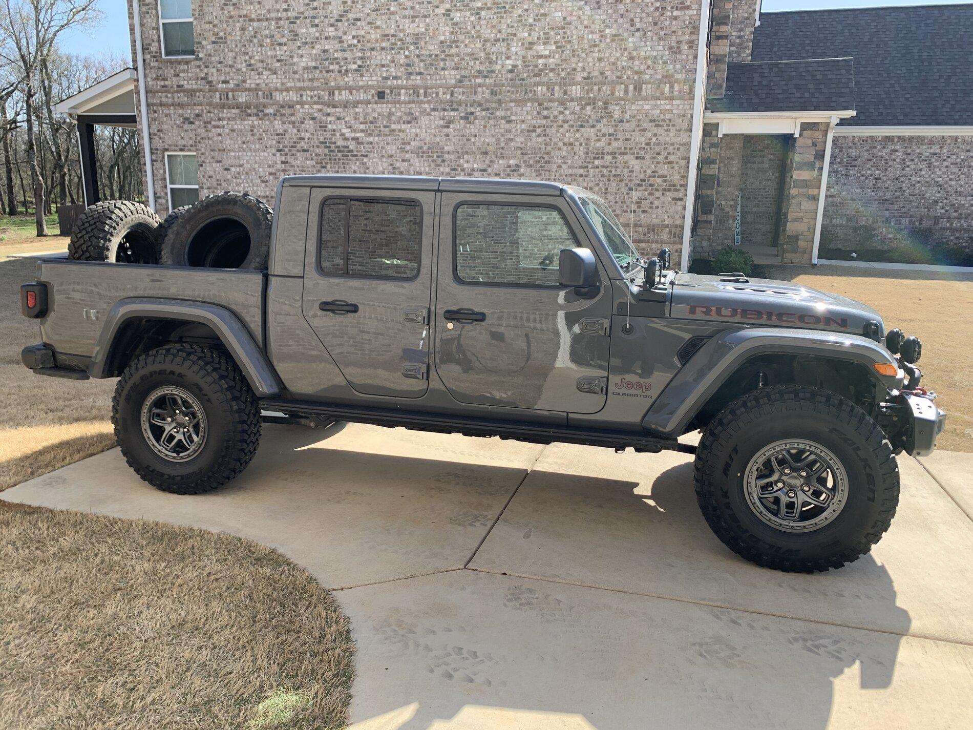

21 gladiator rubicon

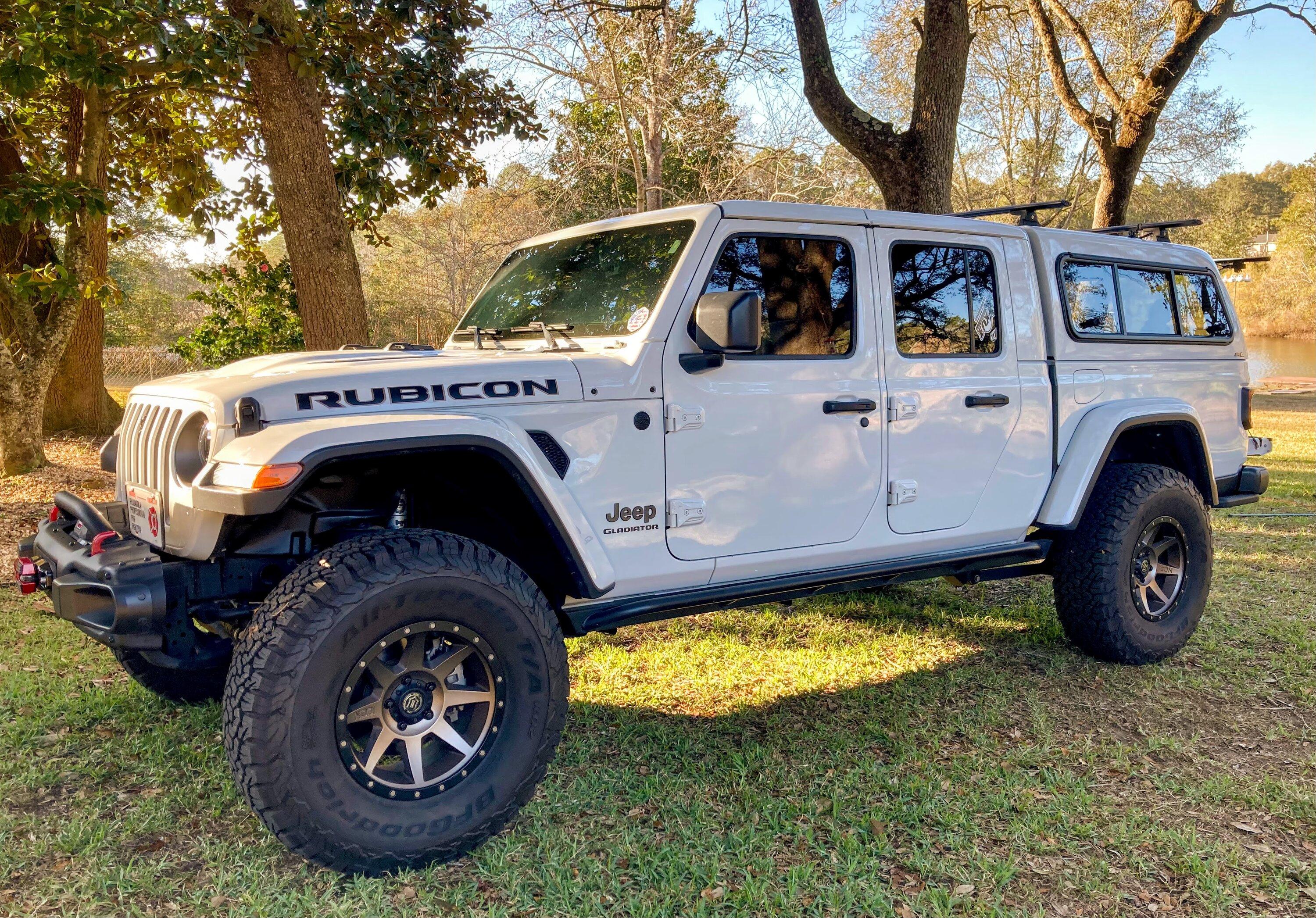

Mopar 2" lift, Daystar 3/4 inch spacer in the rear to level out the truck with all the extra rear weight, Falcon adapt SP2 shocks, 37s, -12mm offset 17x9 teraflex split spoke Nomad wheels, and 5.13 regear.
