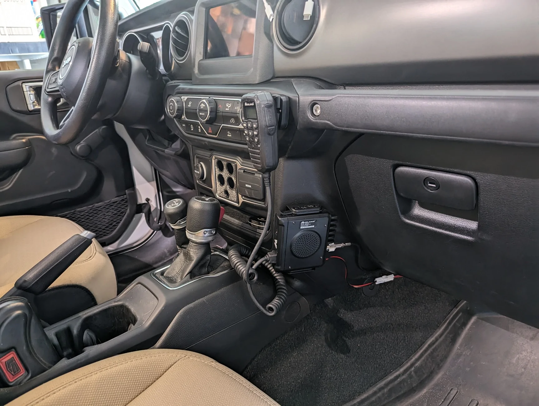

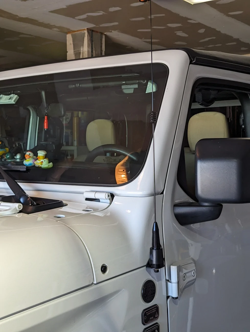

I do more challenging wheeling about 1-2 times per year. I have a Midland MXT275 mounted inside, and a MXTA26 6DB Gain Whip Antenna outside. When not wheeling with a large group or in remote areas, I store the antenna and radio under the back seat. (The MX275 is rather compact and is mounted on a quick release bracket attached to the side of the dash - see the photo below.)
I also carry two Baofeng handheld GMRS radios (UV-5R and GM-15) for shorter range use, spotting, and as spares for other drivers.
I previously used FMRS radios, but those were insufficient for some groups and Jeep Jamboree.
Yes, I licensed per FCC requirements.
