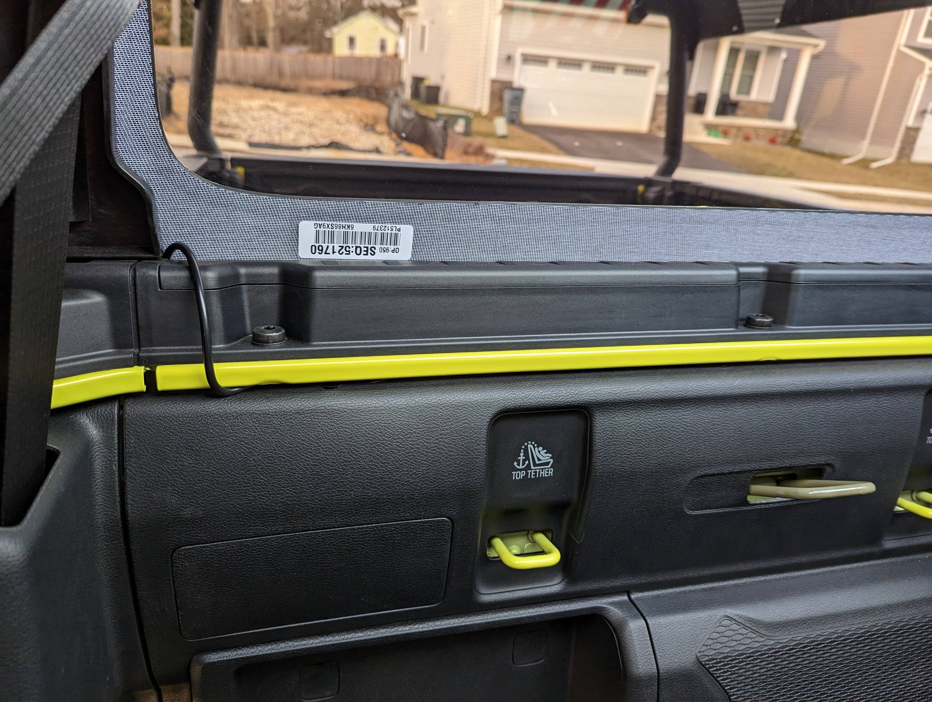

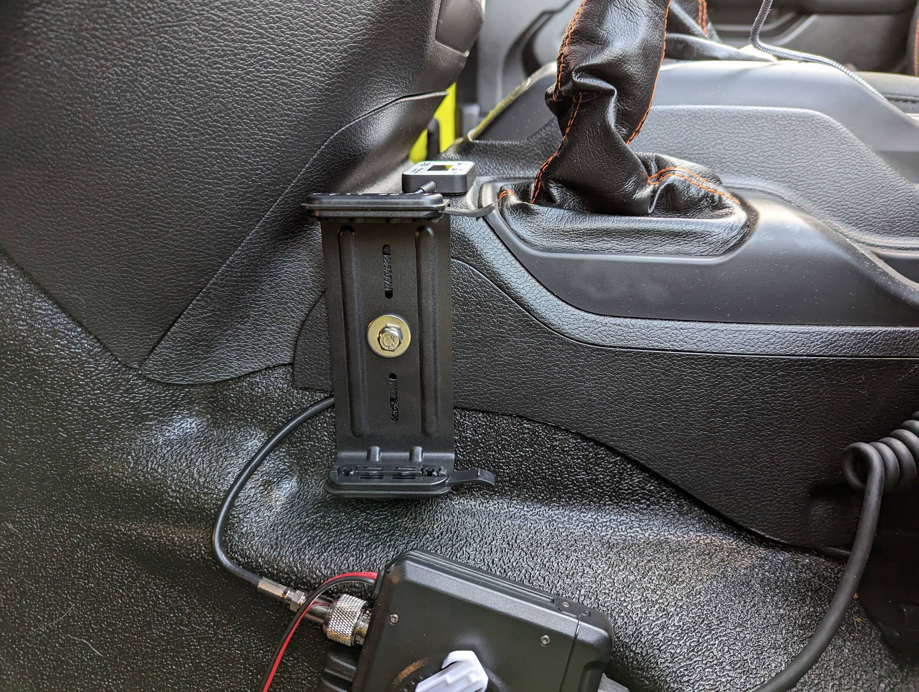

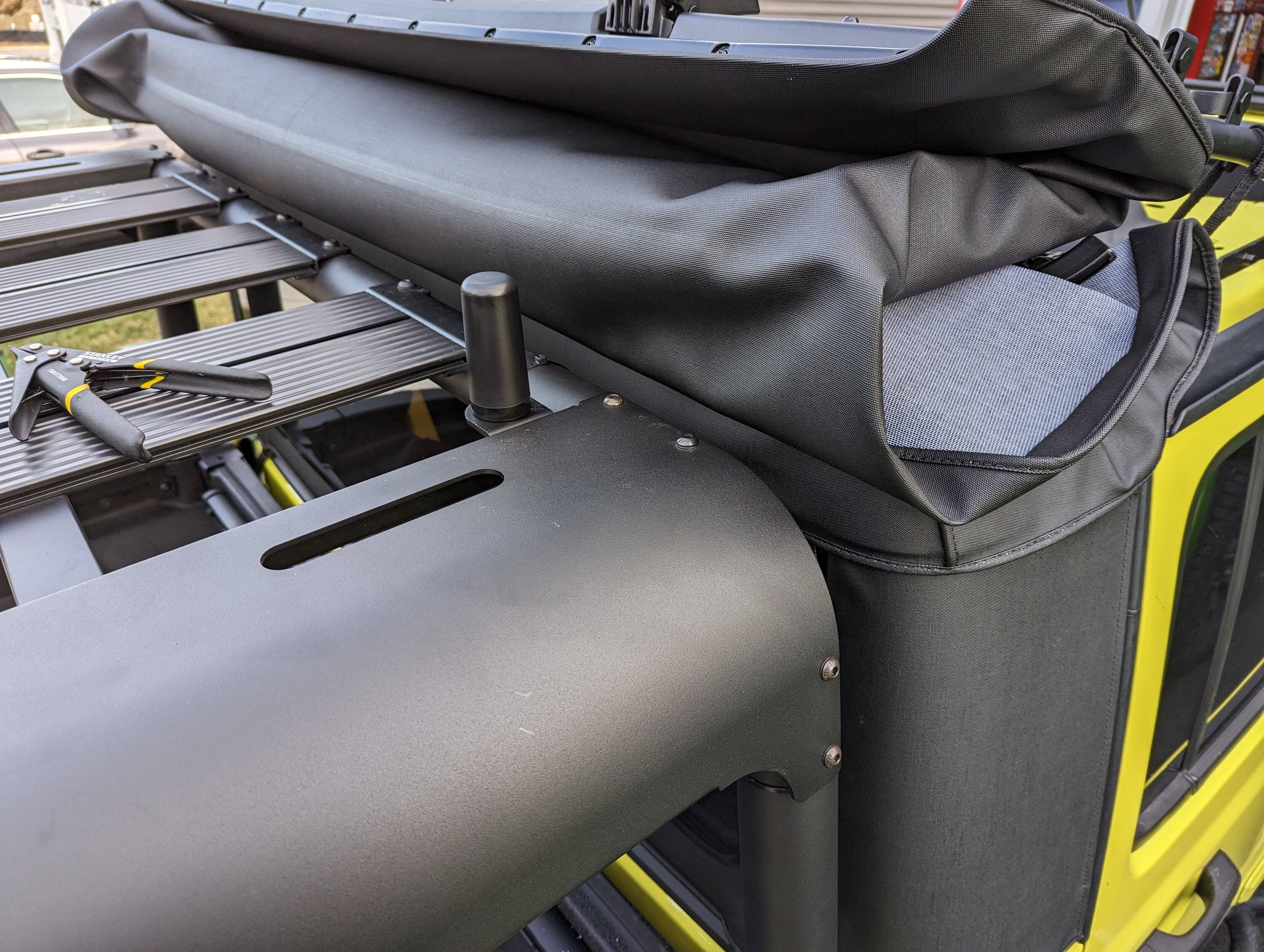

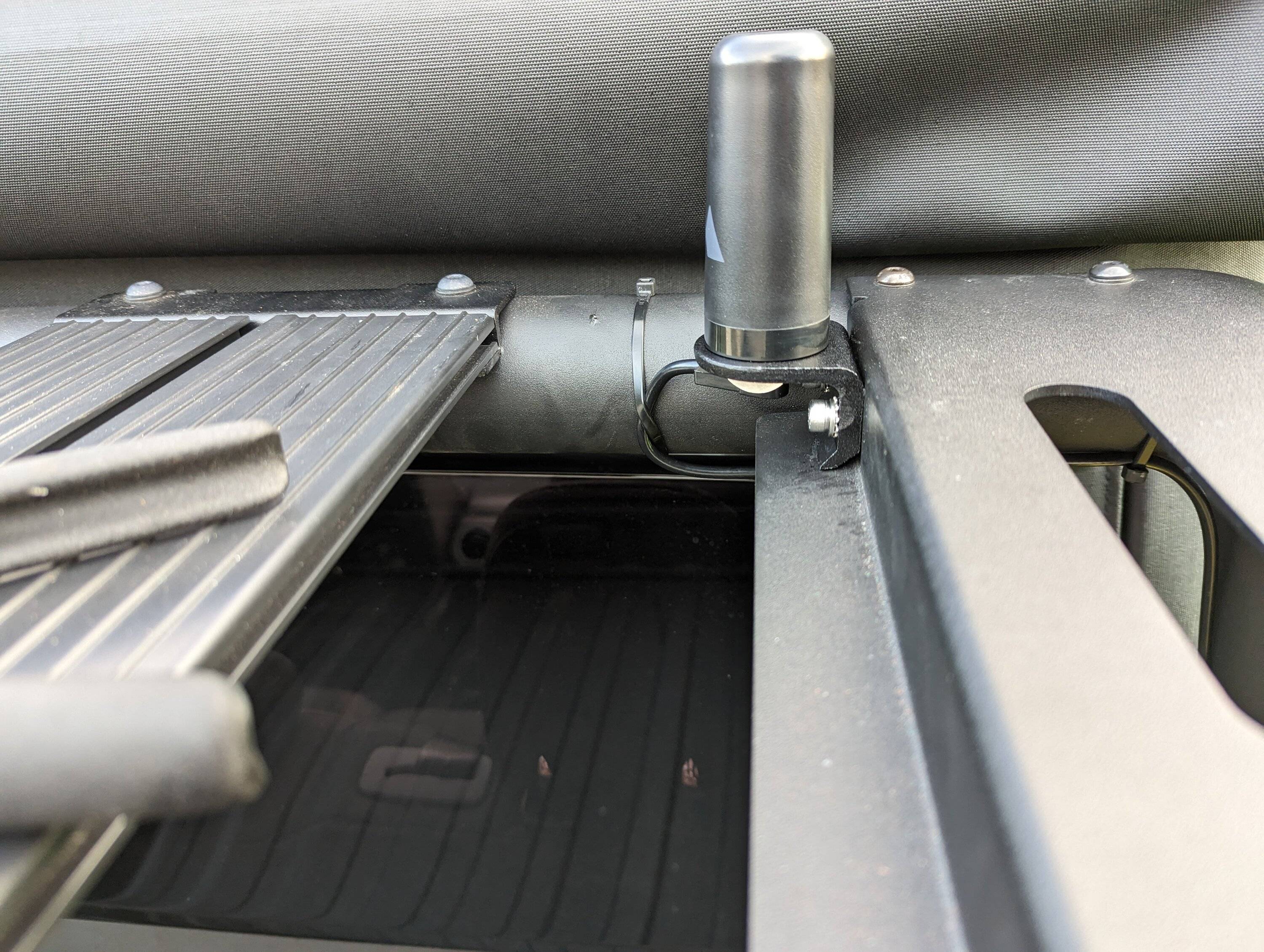

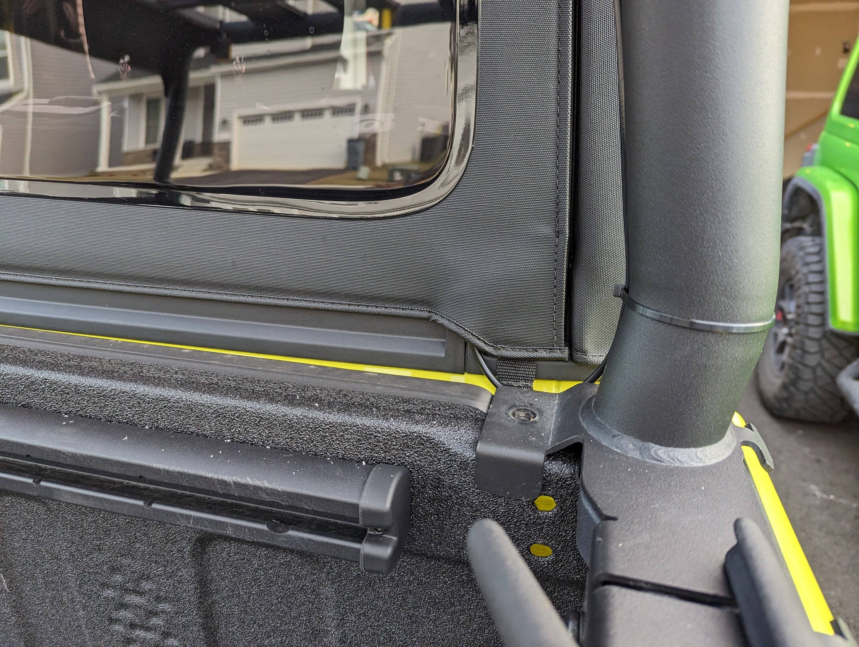

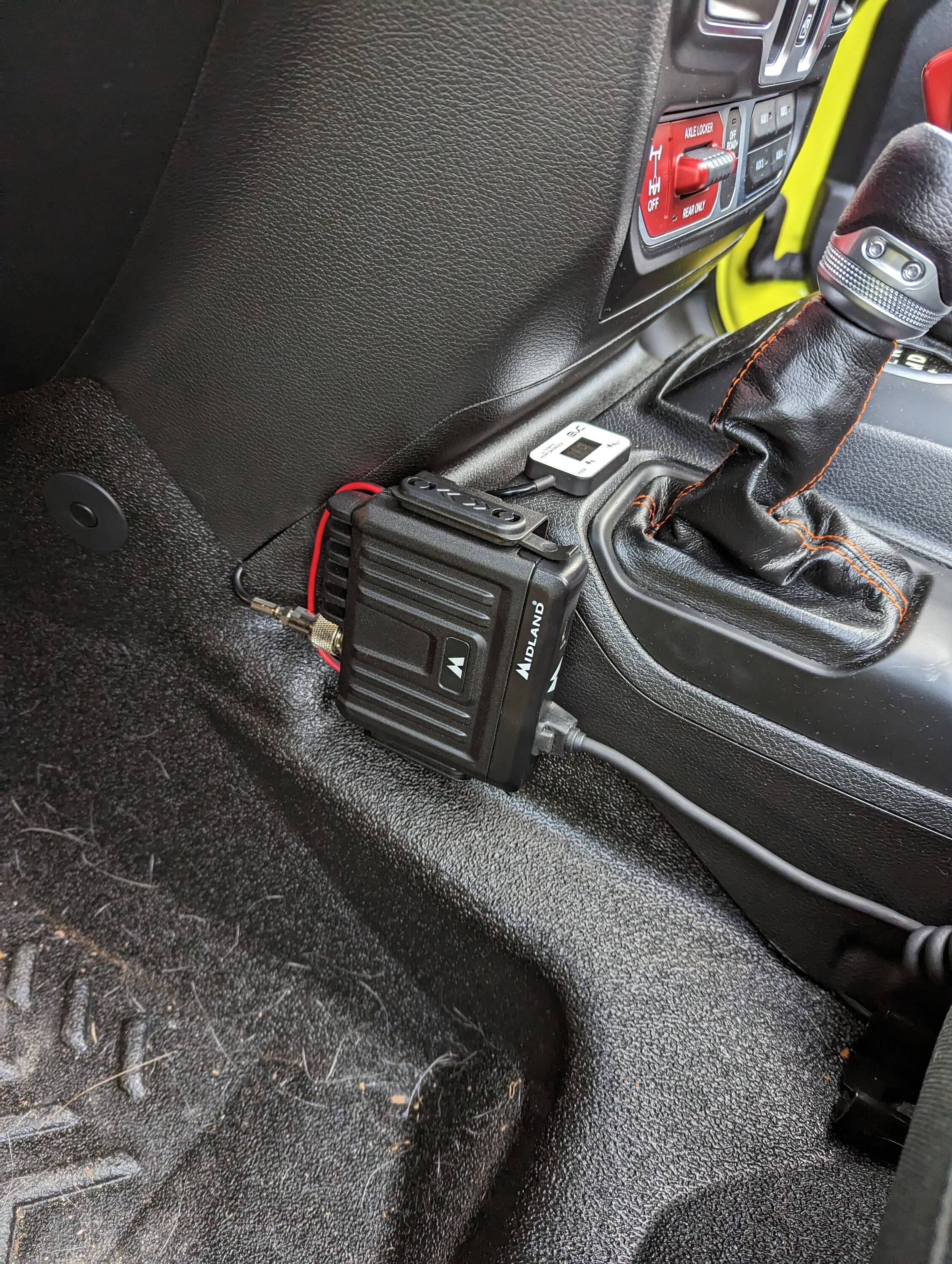

Got the antenna mounted, coax run and radio mounted. Waiting on the Quadratec power cable. I used the existing center console mounting point with some SS hardware I had on hand.
I'm super anal with running cable and wiring.
There is just enough slack in the rear window where I was able to snake the coax through so I didn't have to run it under the truck. Behind the back seat I just need some command clips to have it all tidy to my liking.
Pics or it never happened right.
Jeep Gladiator GMRS users PXL_20230205_215610211
Jeep Gladiator GMRS users PXL_20230205_214648730
Jeep Gladiator GMRS users PXL_20230205_214534069
Jeep Gladiator GMRS users PXL_20230205_214530234
Jeep Gladiator GMRS users PXL_20230205_214626741
Jeep Gladiator GMRS users PXL_20230205_215510017
