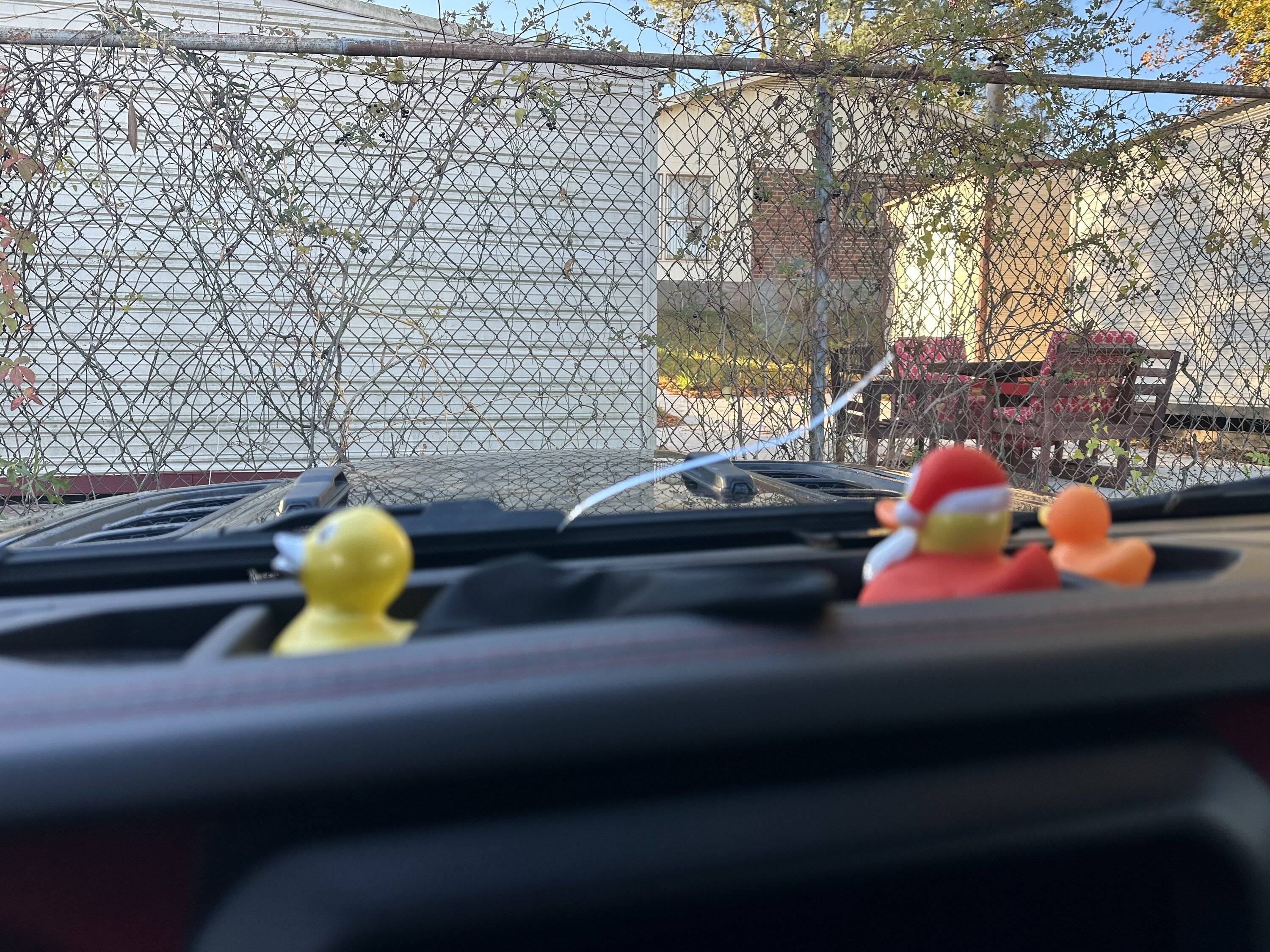

Happed to me today! 541 miles on mine. Just cracked for no reason pulling out of Lowes parking lot. Lol.
There's a reason - you may have a heck of a time finding or seeing it, but there's a reason.
I was certain my first windshield broke sitting there, with no reason, but a thorough cleaning and a bright light in the right spot showed the point of origination.

Yep. I found the tiniest of chip right where it starts.

I was dead certain mine was cracked due to flaw, that I'd get a new one under warranty - hey, it cracked sitting in my driveway! I looked and found no chip, so I went to the collision center. The guy was skeptical (not rude, but blunt) - he had this magic cleaning spray that took off bugguts and other debris like it was nuttin' - a couple wipes and that glass was SPOTLESS. Then he took a bright flashlight and followed the crack to within a couple inches of the top of the glass - and there it was, oh crap. Dang. The angle of the light had to be just right, but when it was, there was that tell-tale sparkle.

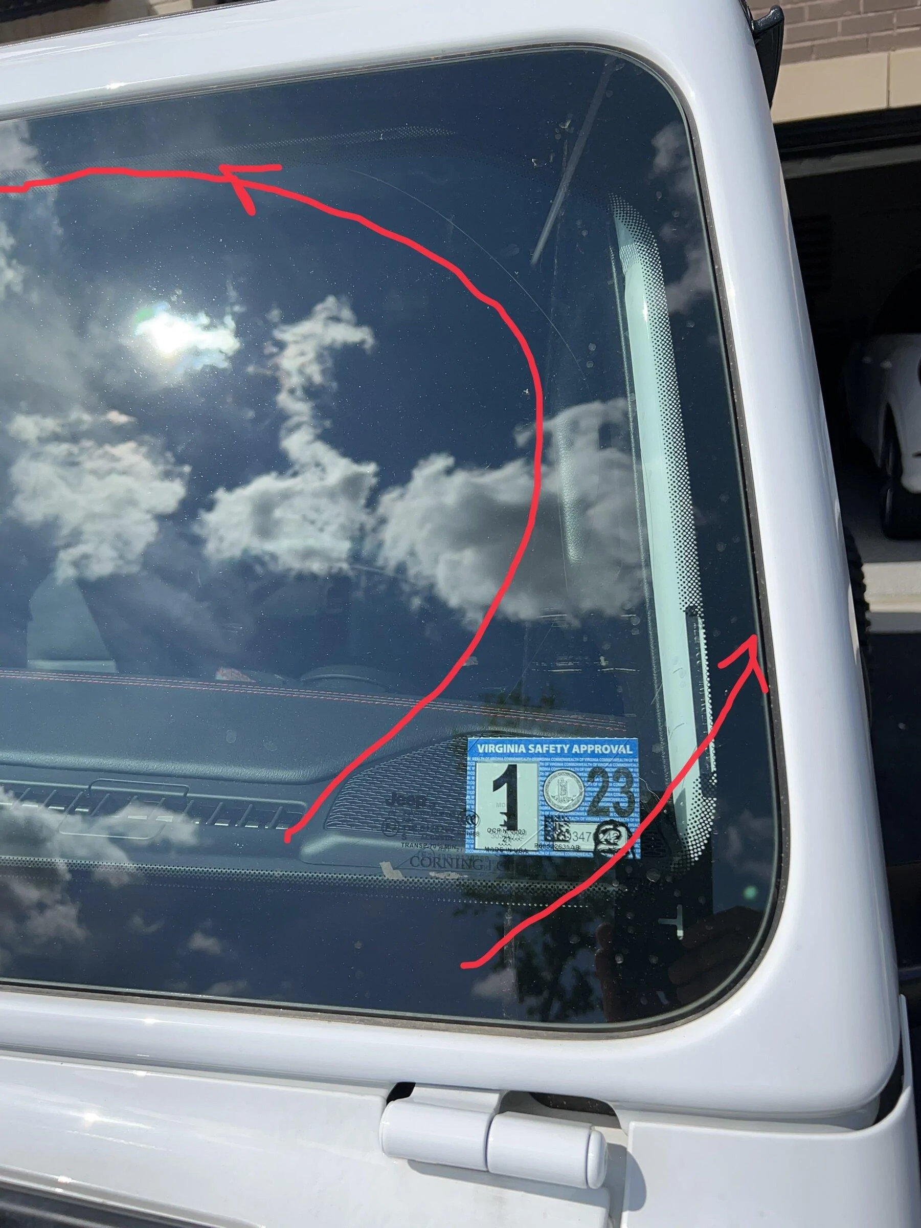

I was on my way to work with defrost on so I could see… loud pop, then it ran. Haven’t even made the first payment on my truck ?

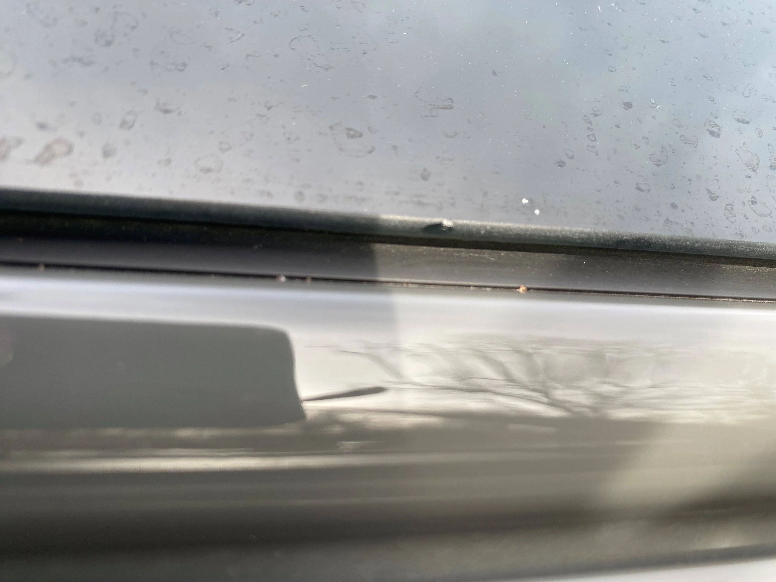

Here is a chip I have in the bottom of my windshield. The chip is extremely smooth and not jagged which is the only reason I think it hasn't become a bigger issue yet. Any imperfection combined with temp changes and/or pressure are a recipe for a nice crack.
Jeep Gladiator Gorilla Glass Windshield Cracked For No Reason chip-jpg
Whew! That's close to crack-causing, if it isn't at some point in the future.
