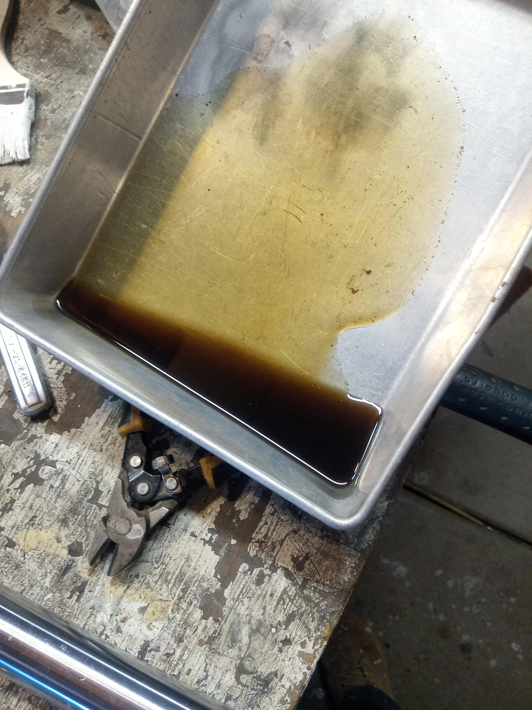

jac04/SP, I know the smell difference between gear oil and burnt gear oil, very different. Gear oil shouldn't get a burnt smell in 3k.

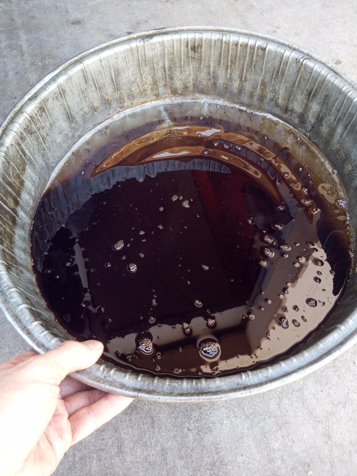

Here is mopars finest out of my rear diff at 4500 miles...... Coffee color and mildly burnt with some metal filing fully caking the magnet.

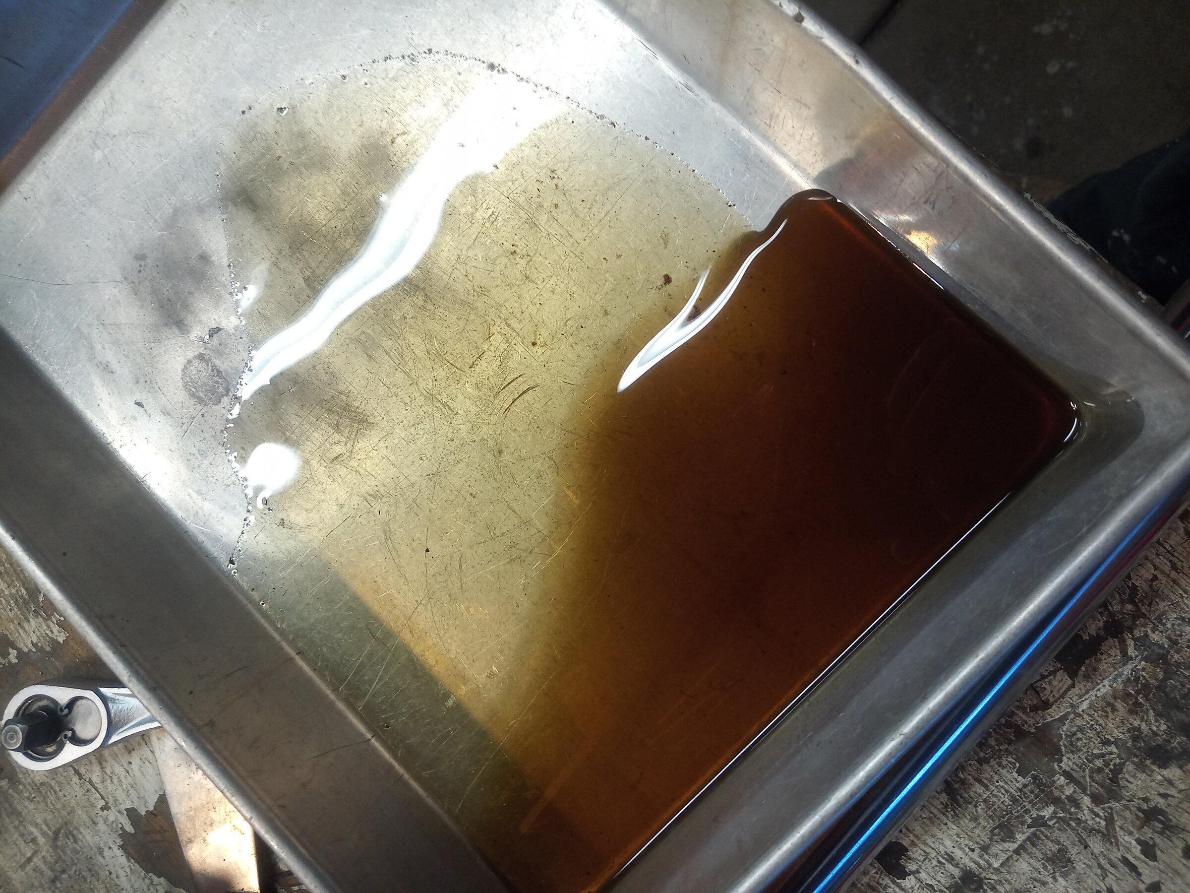

Just a follow up. Changed rear axle oil for a second time after 5k miles on it. Wanted to see if it was a oil issue or a axle issue causing the burnt oil. Plus wanted to inspect how much metal goo collected on the magnet from last time. Good news the metal goo is less and the oil (nothing fancy, shop bulk Philips 66 gear oil.) wasn't as nasty/burnt smelling or as dark.
Here are some pics of the drained stuff. (don't mind the chunks in the pan, i didn't wipe it out first, i just wanted to capture color)
Jeep Gladiator Gross gear oil @ 8k miles IMG_20220109_121852
Jeep Gladiator Gross gear oil @ 8k miles IMG_20220109_121903
and for all the busy bodies, yes i pulled the cover this time and hosed out the housing with brake clean. But it was hardly worth it, no debris/sludge, or anything else, just a fine black film covering everything.
The drain recess being the lowest point catches anything and gets drained out when you open the drain hole. Pretty simple exercise and I encourage anyone with a rubicon at the very least dump the factory crap (with all it's crap from break-in) and put in some fresh stuff, just drain and fill, don't bother pulling the cover unless you really want to and that will go a long way.

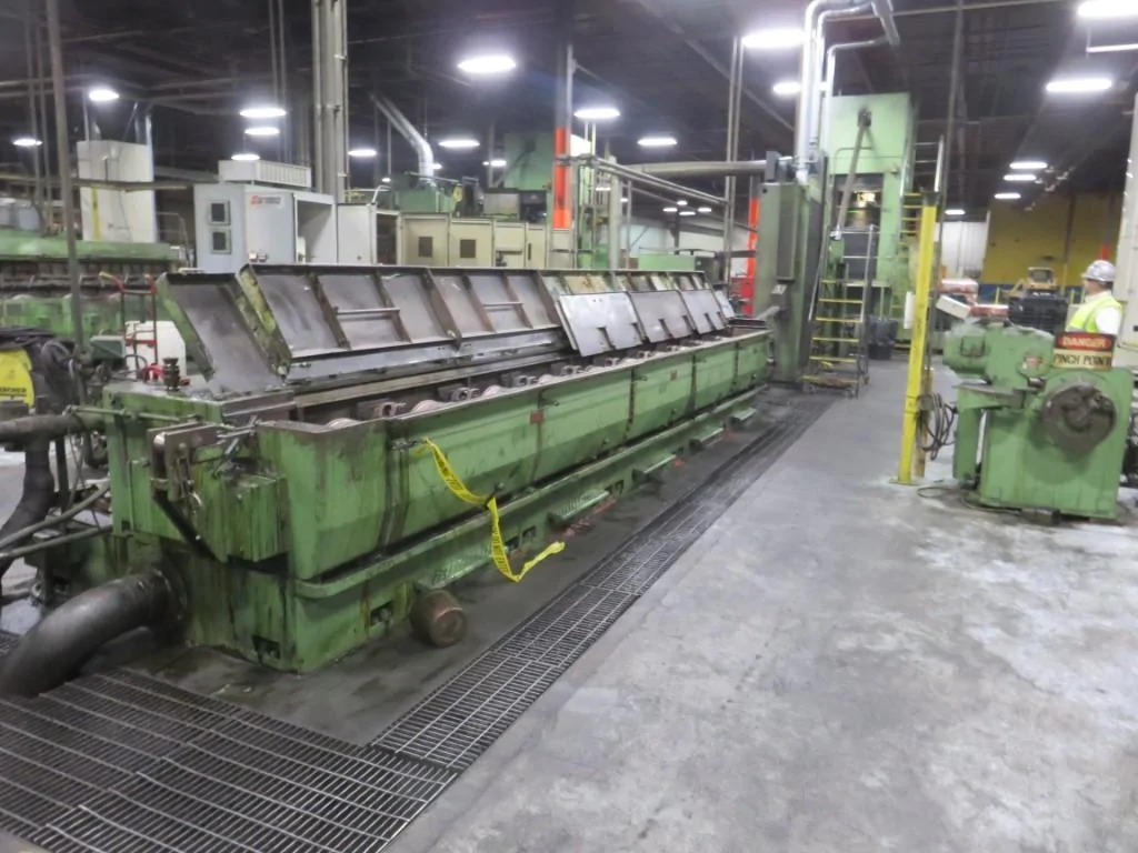

I was a master tech for many years myself and not saying your buddy didn’t have reason to be concerned. Looks and smell can be and are deceiving. I plan on keeping mine until i require something different could be a year could be 10+ having done gear oil changes by the drum … sometimes several drums per machine I feel confident mine will last till spring then I’ll swap it out. Here is a sample pic of my past career that machine takes 135 gallons of gear oil. Some of the gears and sprockets are more than 30 inches in diameter.
cool equipment but it’ll beat ya up working on large industrial shit.
