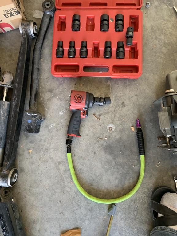

I installed a Clayton 3.5" overland Plus kit on my Gas JT Rubicon Manual, so, I cannot help on the diesel... but, in general, I found that a mini impact (air driven) with the swivel sockets was my most appreciated and used tools. Depending on clearance, you can use it both on the bolt side or the nut side for the control arms.... and of course, you need a torque wrench and some series strength to torque down those lower control arms at the end of the process... Here is a pic of the tools that made it a lot faster and easier.
