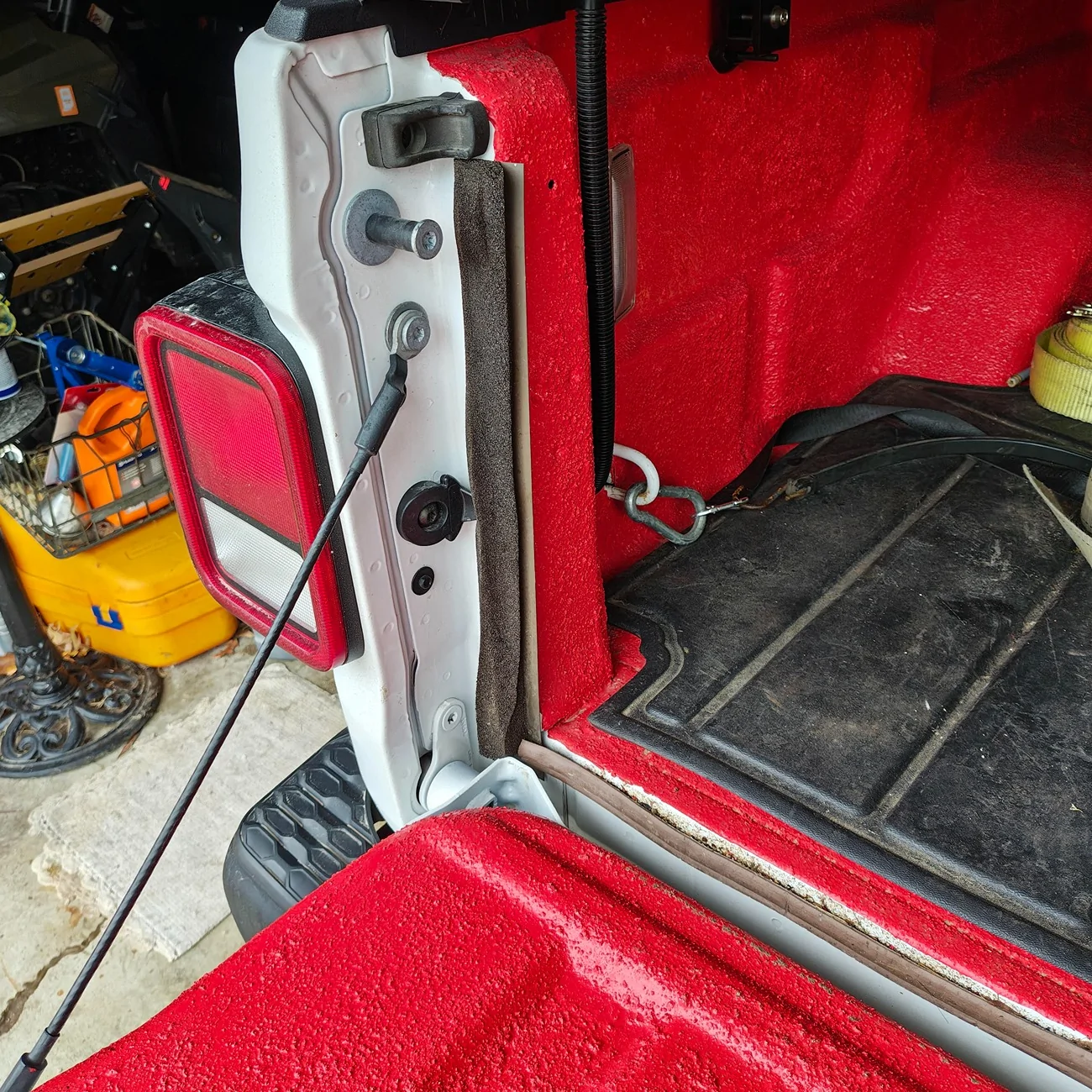

I just went to Menards and bought one regular door seal and one expanding door seal. I have enough left to do it a few more times when it wears out.

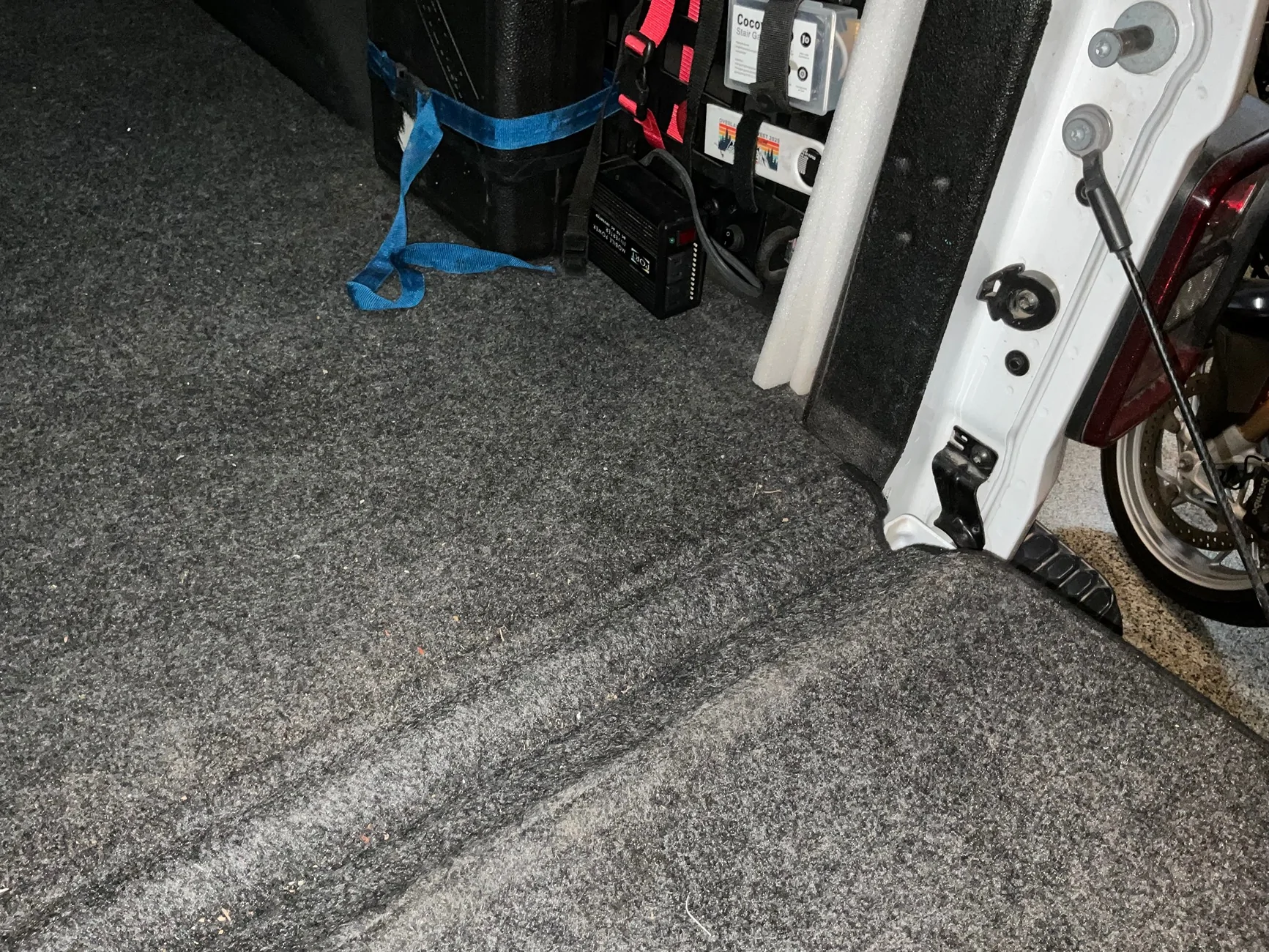

I have a full bed rug in my bed: it’s one piece that lays in the bed and extends onto the tailgate so that when the tailgate closes, it’s seals along the bottom edge completely. For the vertical parts of the bed opening, I used this product from Amazon. Together, the bed rug and the foam seal keep nearly all dust out of the bed under my cover. I know you didn’t ask about the bed rug, but just in case that has been on your radar: the one that extends into the tailgate does wonders to control the dust ingress.

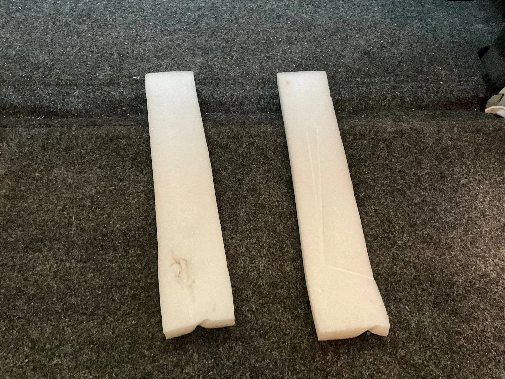

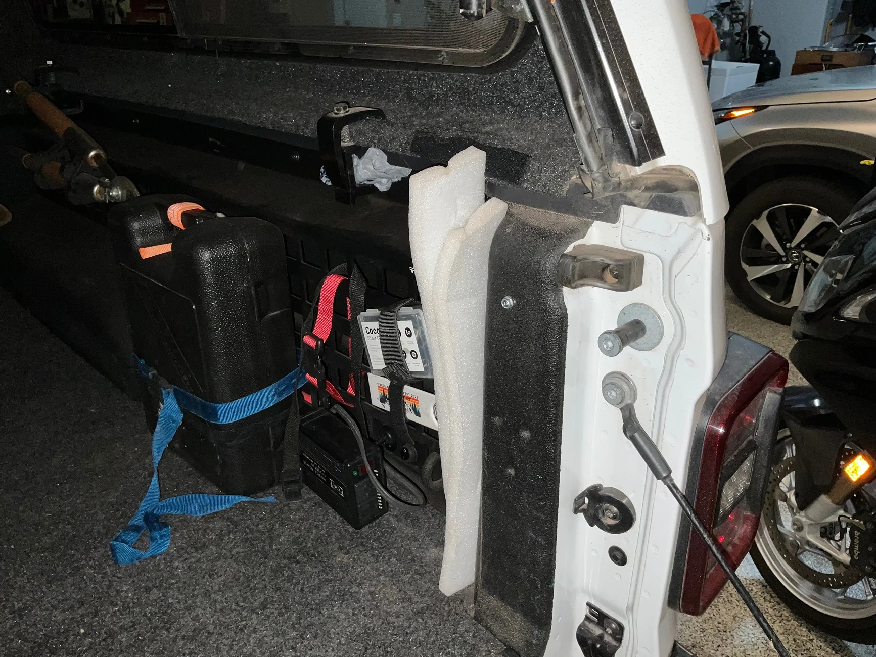

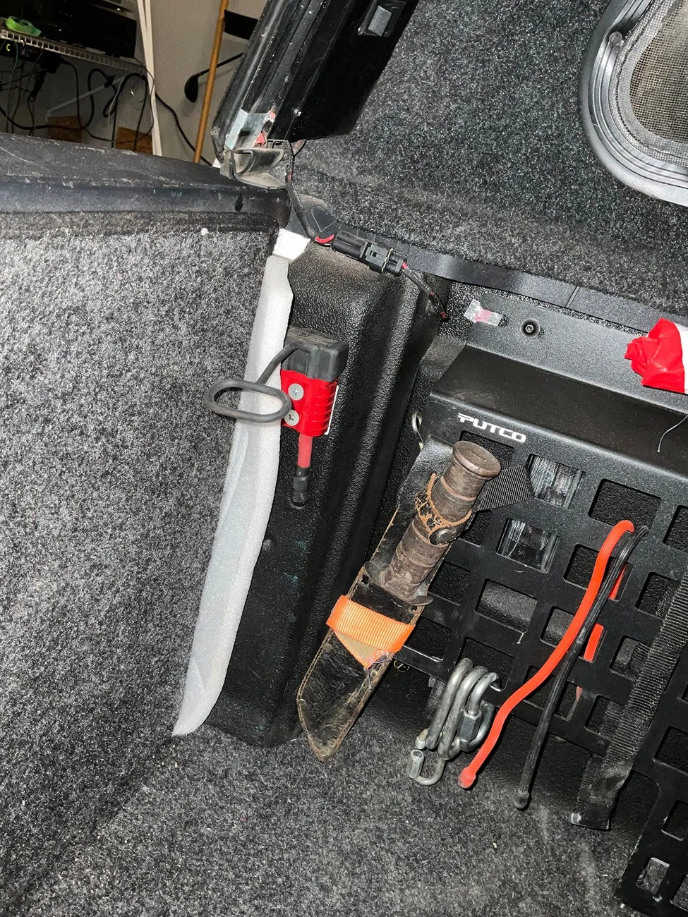

I went super cheap! The bedrug seals the bottom of the gate. For the sides, simple packing foam! Whenever I’m in the dirt I just place them on the vertical and shut the tailgate! Works real well.
