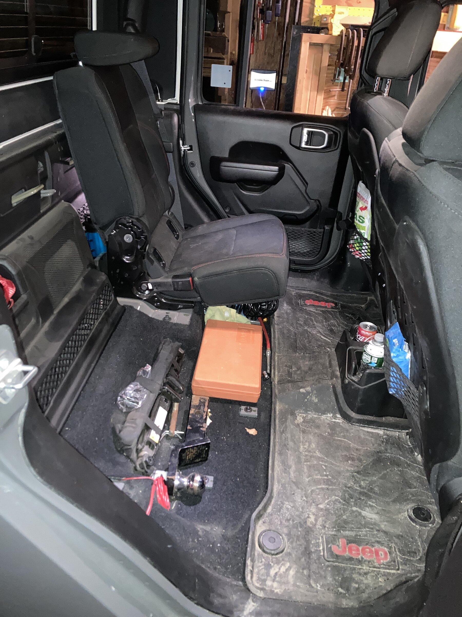

The 60 side of the backseat is out. Ready to pick up the Goose Gear platform at OK4WD. Once I found an E14 socket, the seat came out with no issues. Bolts were a little stiff, but nothing like the monsters that were the body bolts!

Not sure if the floor mats need to come out, but I’m sure that will be obvious in a few days.
Now, time to put in a few thousand highway miles. ?
How did you separate the benches. Mine are stored at a friend and I can't really have a look... so a little guide would be great that when I go there I can just go to town and have all the tools with me.
We took the entire row of seats out but did it with a larger metric nut, I wasn't able to, but our friend managed. Now have the e14 sockets also.
So far we have the seats all deleted with a platform but I am pushing our friend to make it so I can reinstall 1 seat if my nephew comes to visit.
2 small 10mm head bolt attach the seats together at the bottom plates

BTW: the heads are accessed from the driver side

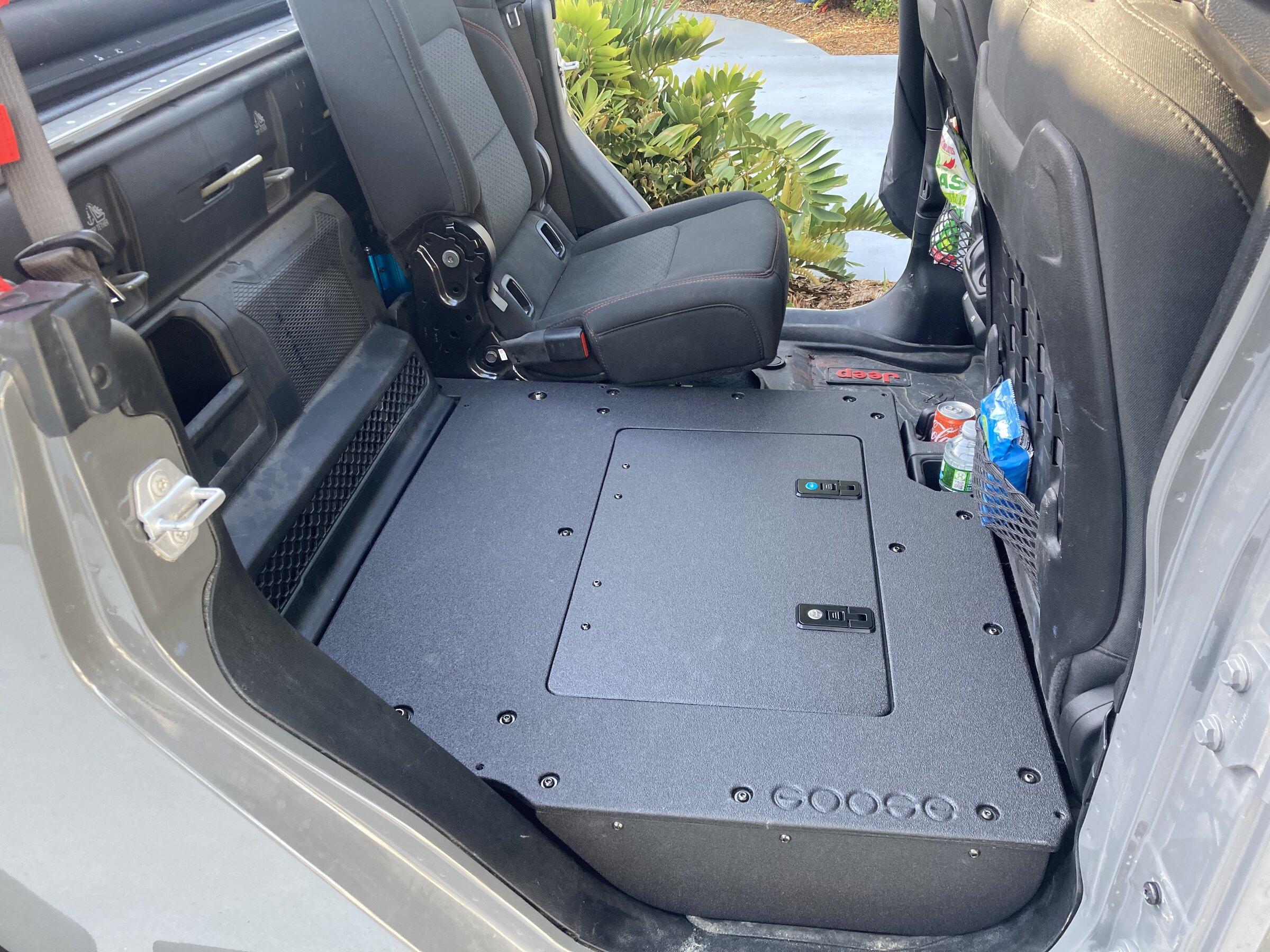

I did get the Goose Gear platform in. I’ll add a few observations when I get back to my laptop, but the short version is this thing is great. Perfect fit. High quality. And a stunning amount of storage space underneath. I was surprised how much I could get in there.
So far, I’m loving this thing. Glad I took the leap.
