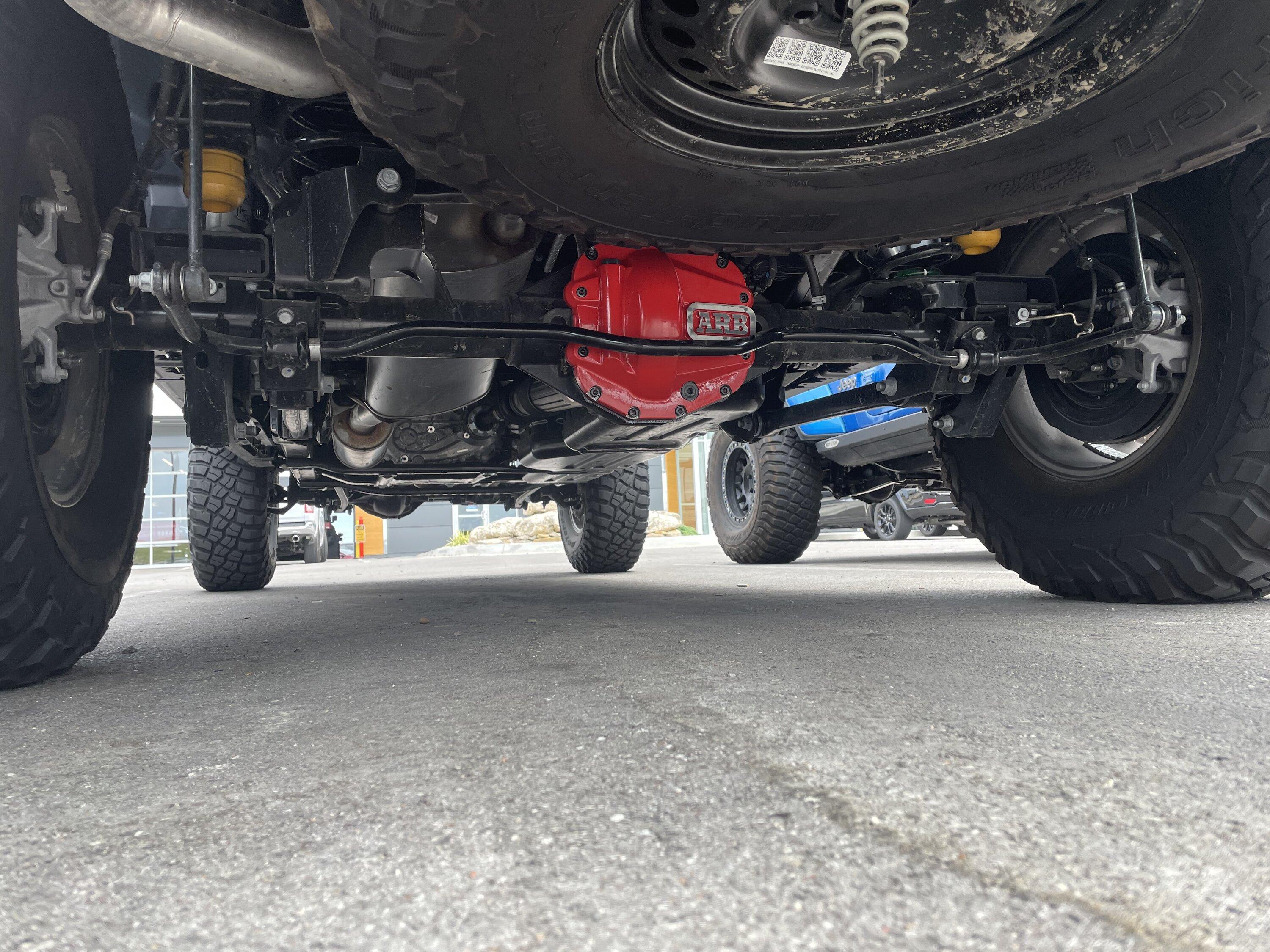

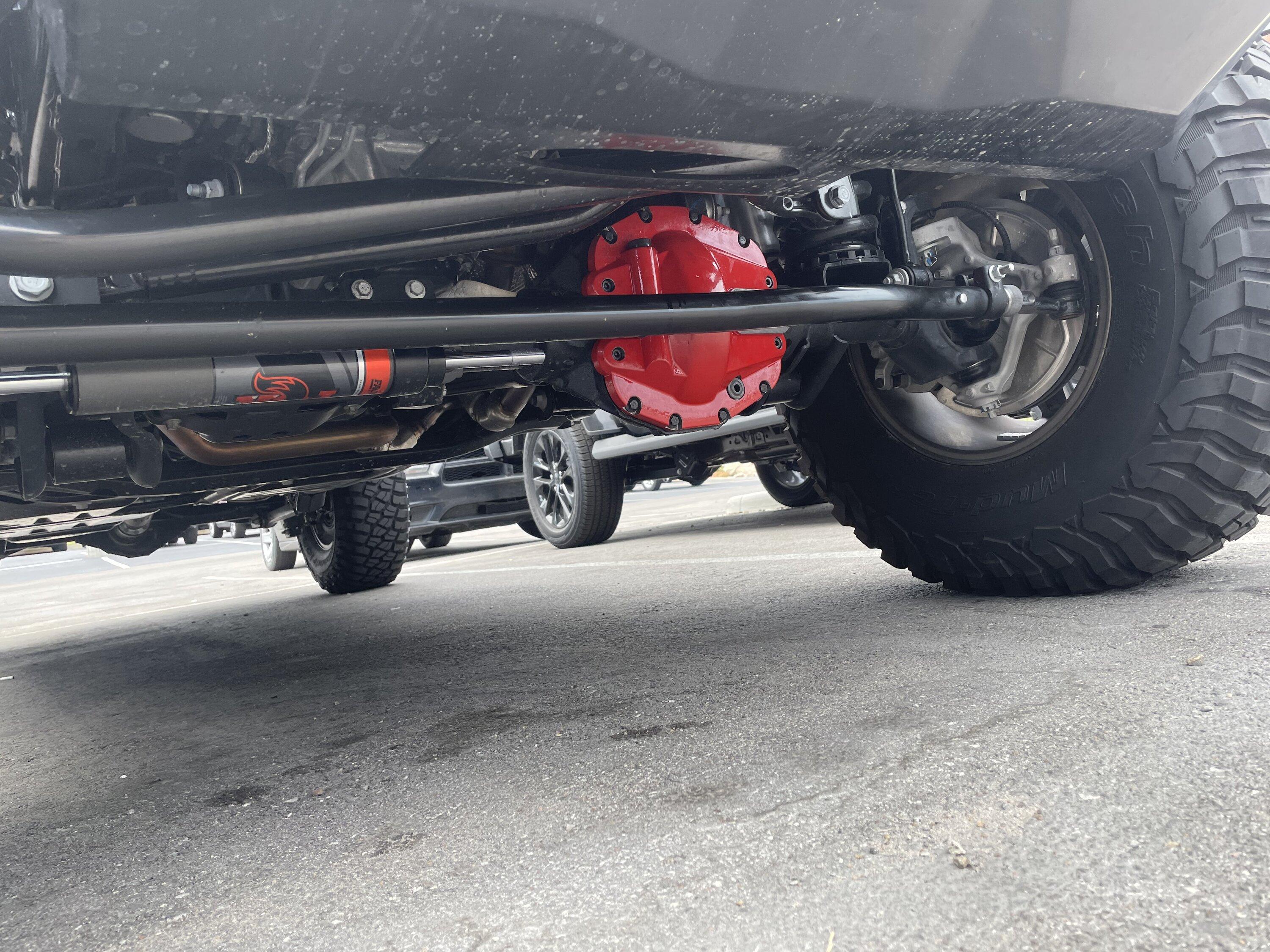

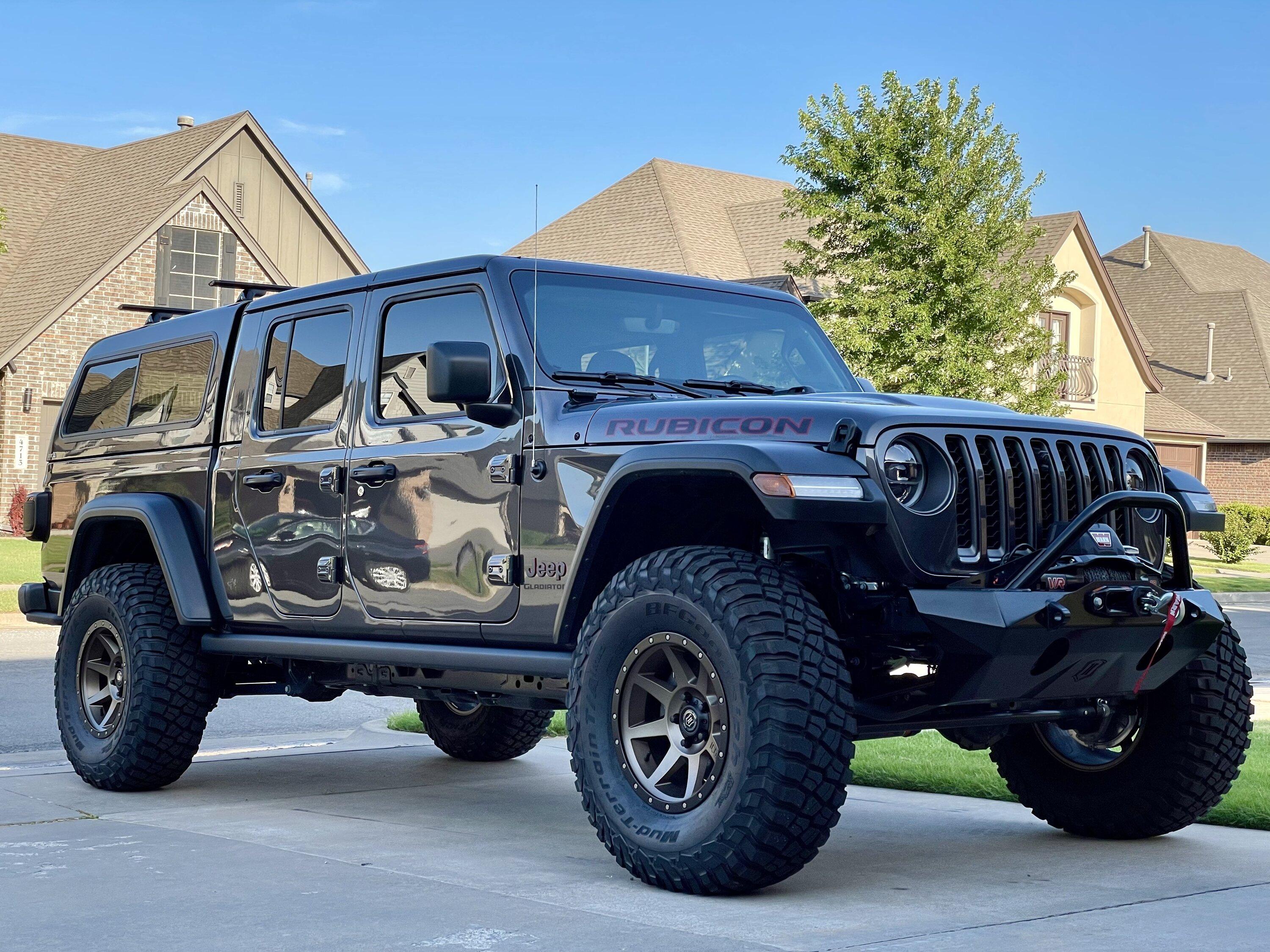

A bit late on starting this as the build has already started. I ordered it back in February and took delivery in March. 3.6L Rubi with most options minus bumpers and Gorilla Glass. Unfortunately I have been working overseas and will be for another month. I had the dealer start on the mods since I have a good friend who runs their shop.
Done:
  • Window Tint
  • 2" Mopar Lift
  • 4.88 gears
  • 37" BFG AT
  • Icon Rebound Wheels
  • Icon Bumper
  • Warn Winch
  • Fox ATS Stabilzer
  • ARE Camper Shell
TO DO:
  • I need to settle on a rear bumper for it.
  • I purchased the rear Gladiator emblem and the black vinyl wrap and need to install that when I am back.
  • Ordered Rigid 360 4" lights for the pillars along with the KC Lights pillar mount and the wiring harness to go to my existing AUX switches.
Here it is the day it rolled off the truck.
Here it is after the Mopar lift, Icon wheels and when I first put 35" tires on it. I received this pic and had him change it to 37's.
Here it is with the 37" BFG AT's. Way better.
Finally the ARE shell made it in along with the Icon bumper, winch, and my Fox ATS Stabilizer.

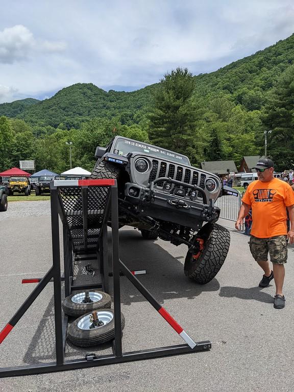

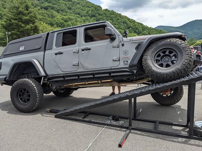

Very similar to mine. I stuck with the 35s, so I'm geared to 4.56. I did end up replacing the Mopar lift with Clayton springs and arms (3.5 rear and 2.5 front). The Mopar lift sagged more than I wanted with the cover, even with 3/4" spacers.
Jeep Gladiator My Do-It-All Gladiator PXL_20220611_170315335-XL
Jeep Gladiator My Do-It-All Gladiator PXL_20220611_170220402-L
