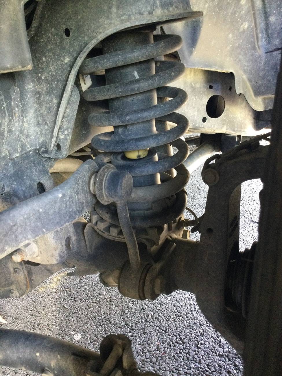

can you please see my photo and see if this looks right, my front bump stops are practically touching at the front is this normal? Is there a way of knowing what the gap should be? Please help.

No, not normal. You should only hit your bump stops when hitting a big dip, or when flexing out while off-roading. Mine is gas, not diesel, but there is approx 5" between mine.

The long jounce tube's are necessary to clear the oil pan with the front diff. That small gap and subsequent poor ride are common in the diesels and the JLs with the xr package. Our 2022 JLUR had 2.5" of uptravel before the bumpstops touched, brand new. That's just how Jeep builds them. In reality to properly fit the diesel it needed a lift and the longer bump stops. Throw a 1.5" to 2" spacer on it and it will ride so much better. If your spacer kit comes with added bump stops, do not add them on the front. It's not a warranty issue as that is the design by Jeep however piss poor it might be.

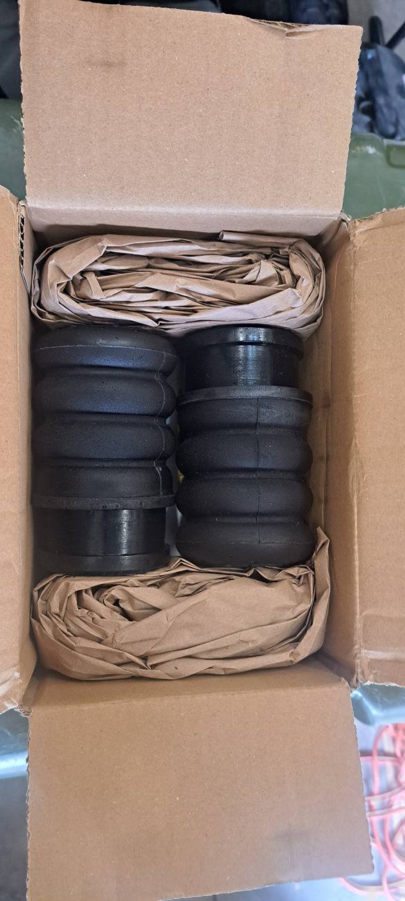

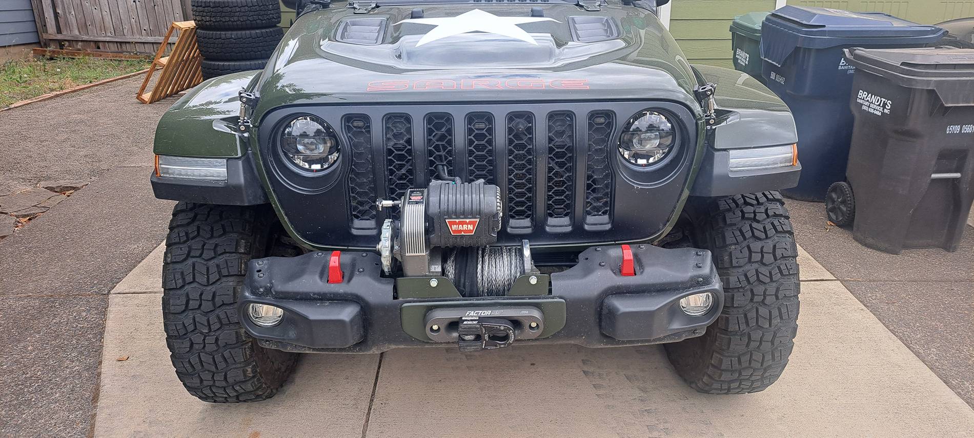

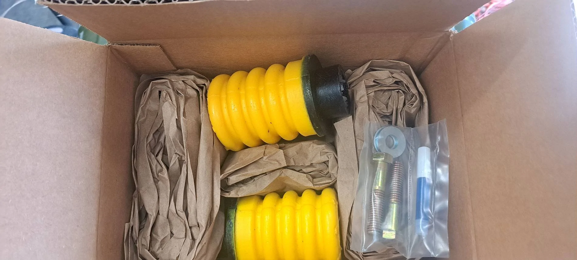

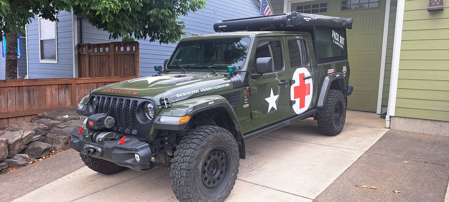

Because the diesel gladiators are front end heavy, and I'm old school with the 8274 winch,
I went with the sumo springs front and rear, love them.

Really nice setup you have there. How are those Sumo Springs working out?

Epic set up, did you stick with stock shocks? just change springs..?
