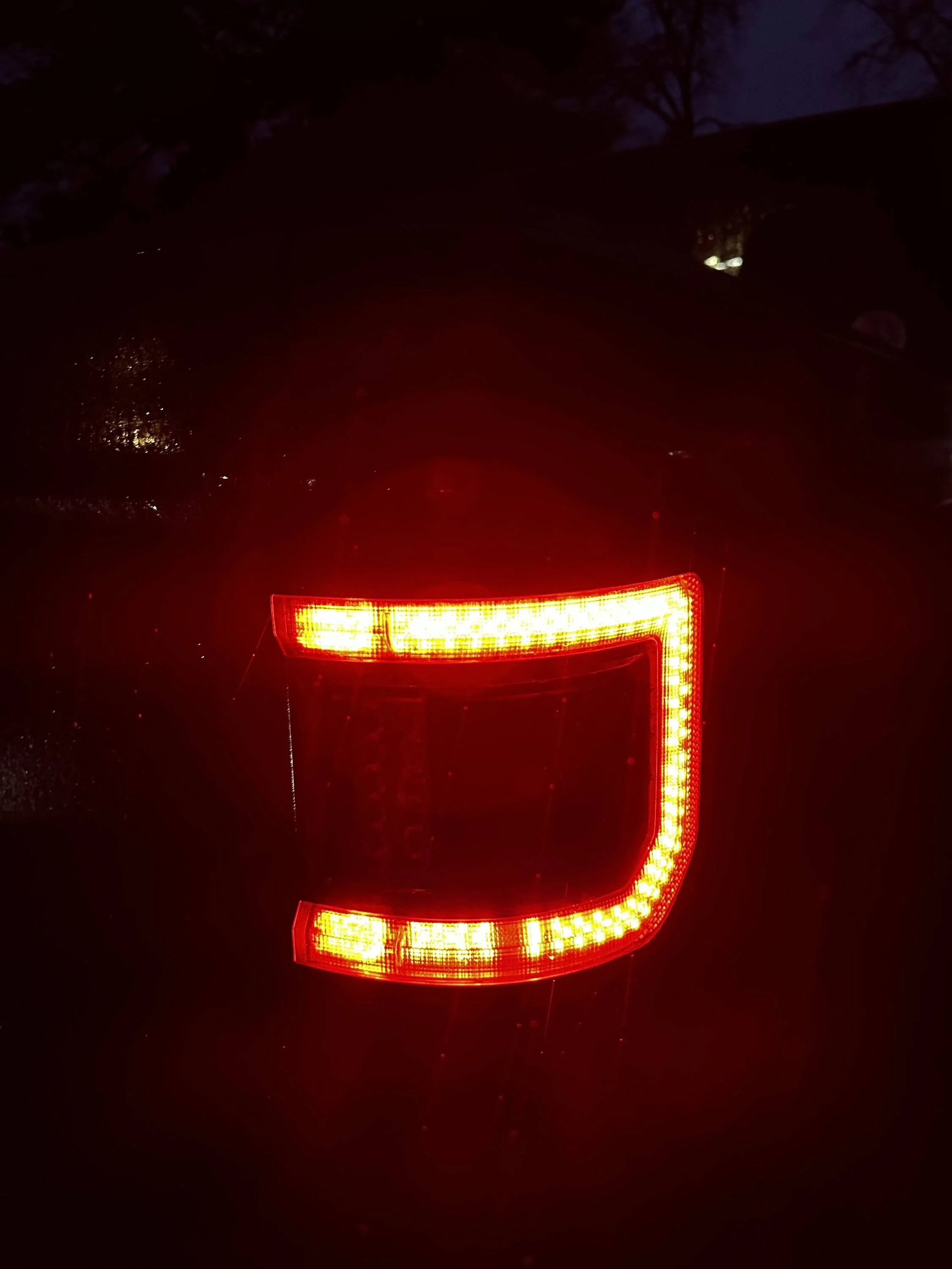

Hi everyone-
So I'm having a bit of an issue with my Oracle tail lights. No, this is not a "bash Oracle" thread and I don't want it to turn into one. I am good with electronics and repairing them. The lights are also over a year old and out of warranty anyway. My goal here is to understand, replicate, and repair.
When off, there's no problem with the lights. The brakes and turn signals work perfectly fine and when not in use they're off, no issues there.

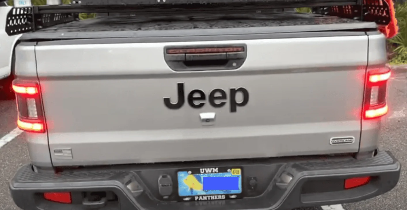

The issue appears to be with the running lights on. In the first photo, you can see how the passenger light is brighter than the driver light. It's not at 100% brightness, but it's significantly brighter.

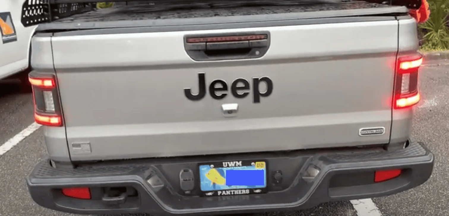

The second photo shows with the brakes/turns on, and both lights are on evenly as expected. It's not easy to see in the photos, but yes the passenger light is just a bit brighter than it was in the first photo. Also, when the running lights are on and the passenger turn signal is activated, the passenger light does blink ever so slightly. So the issue is really just that the running lights on that side are too bright.
I took off the lights last week and attempted some bench testing with the hopes of reverse engineering a fix. I thought it would be straight-forward: Apply 12v to the pins in the connector to identify which is brake/turn and which is running, test them under various situations, and then go from there. But on both lights, no matter which wire I supply +12v to, they both go to 100% intensity. Similarly, if I test the truck side of the tail light connectors, it appears as though they supply 12v as well for each wire. Granted I don't have my nice meter with me, but I can't tell the difference as it sits now. I can't figure out how to get just the running light on the bench.
Admittedly I might be overlooking something or have skipped a step in my testing and troubleshooting so far. Does anyone have any insight that could help me out with bench testing and eventual repair of the light?

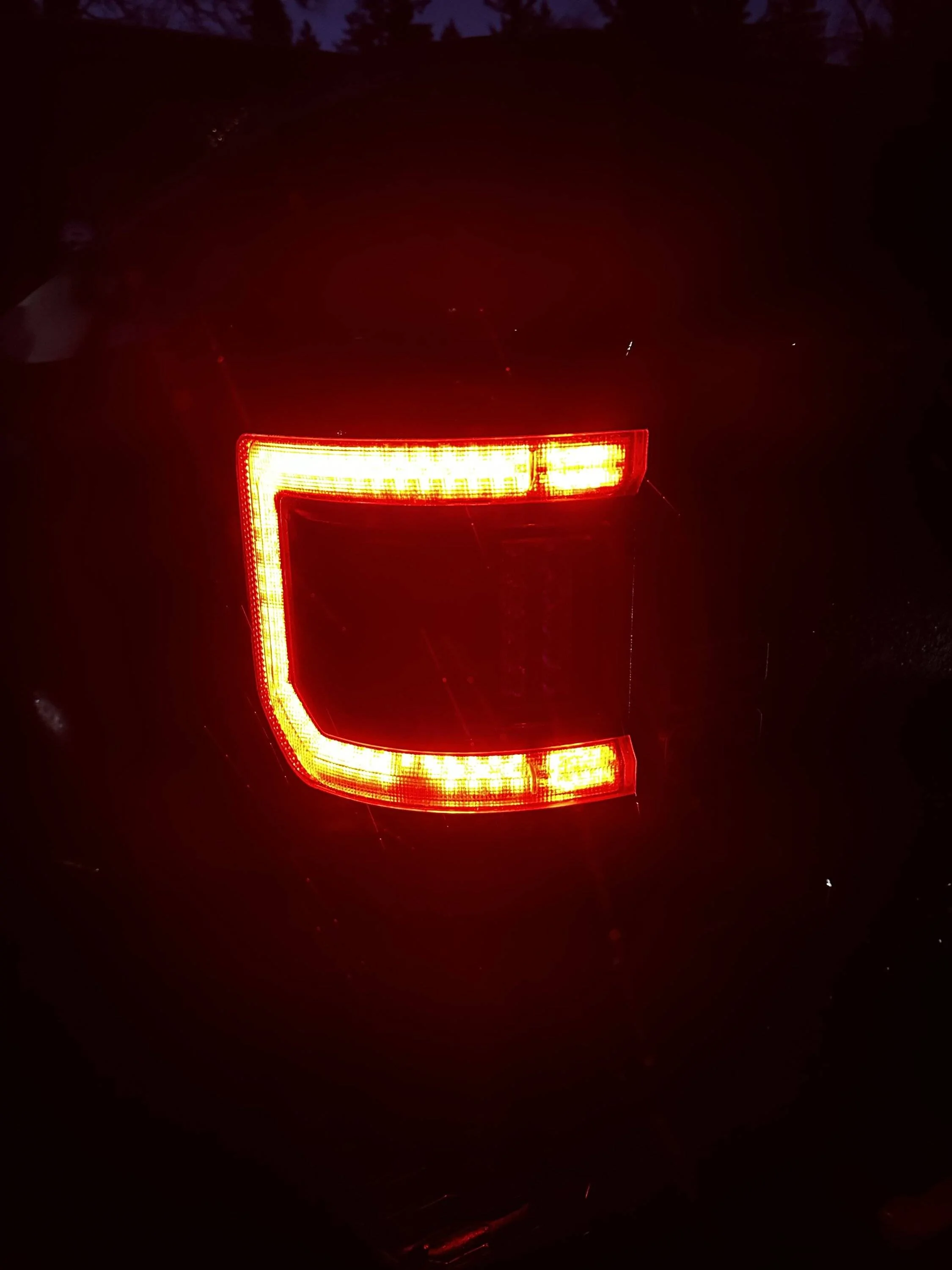

Maybe you can sort mine out as well. Purchased March of last year, LED’s are dying, just like the last set. Moisture seems to be the problem once again. Can you help?

Please take a moment to fill out our online warranty request here: https://www.oraclelights.com/RMA and someone from our customer service department will be in contact with you shortly. Thank you!
