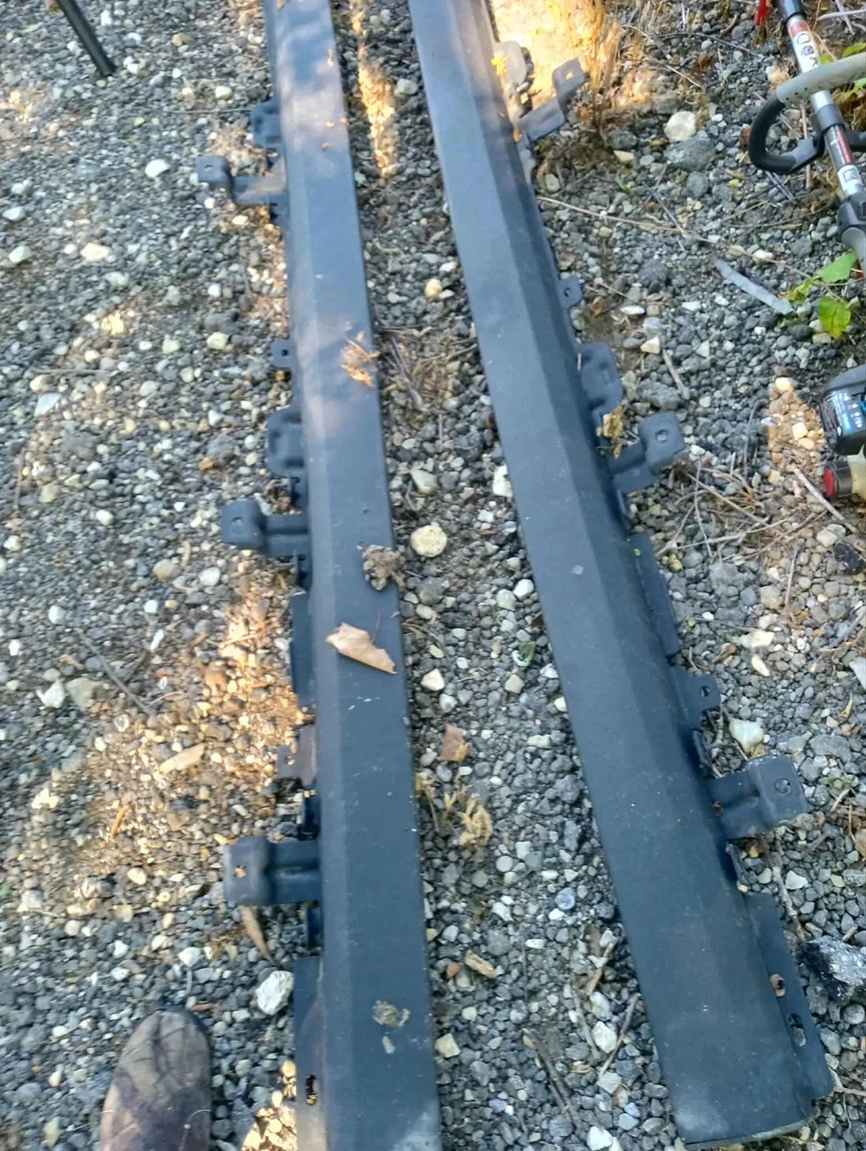

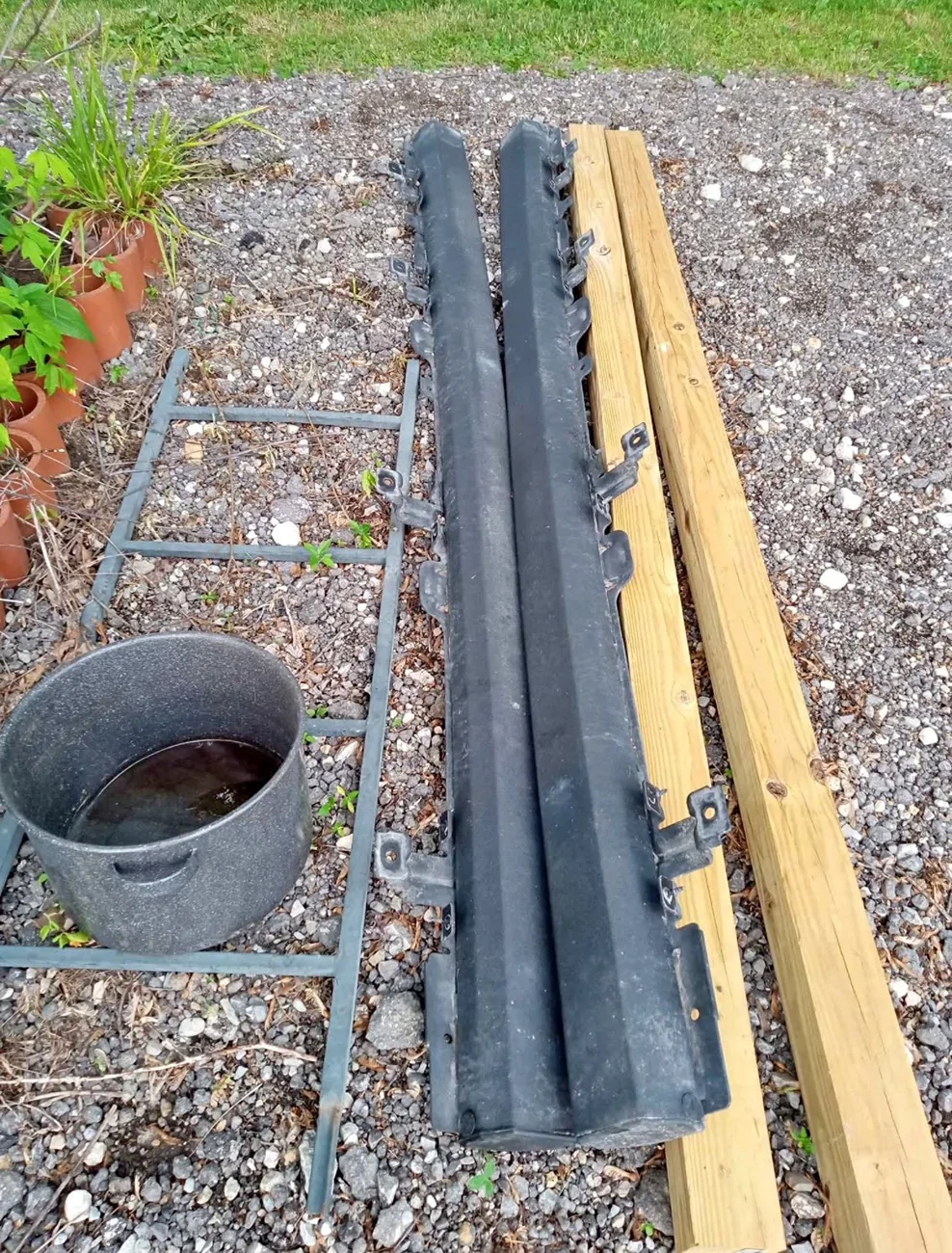

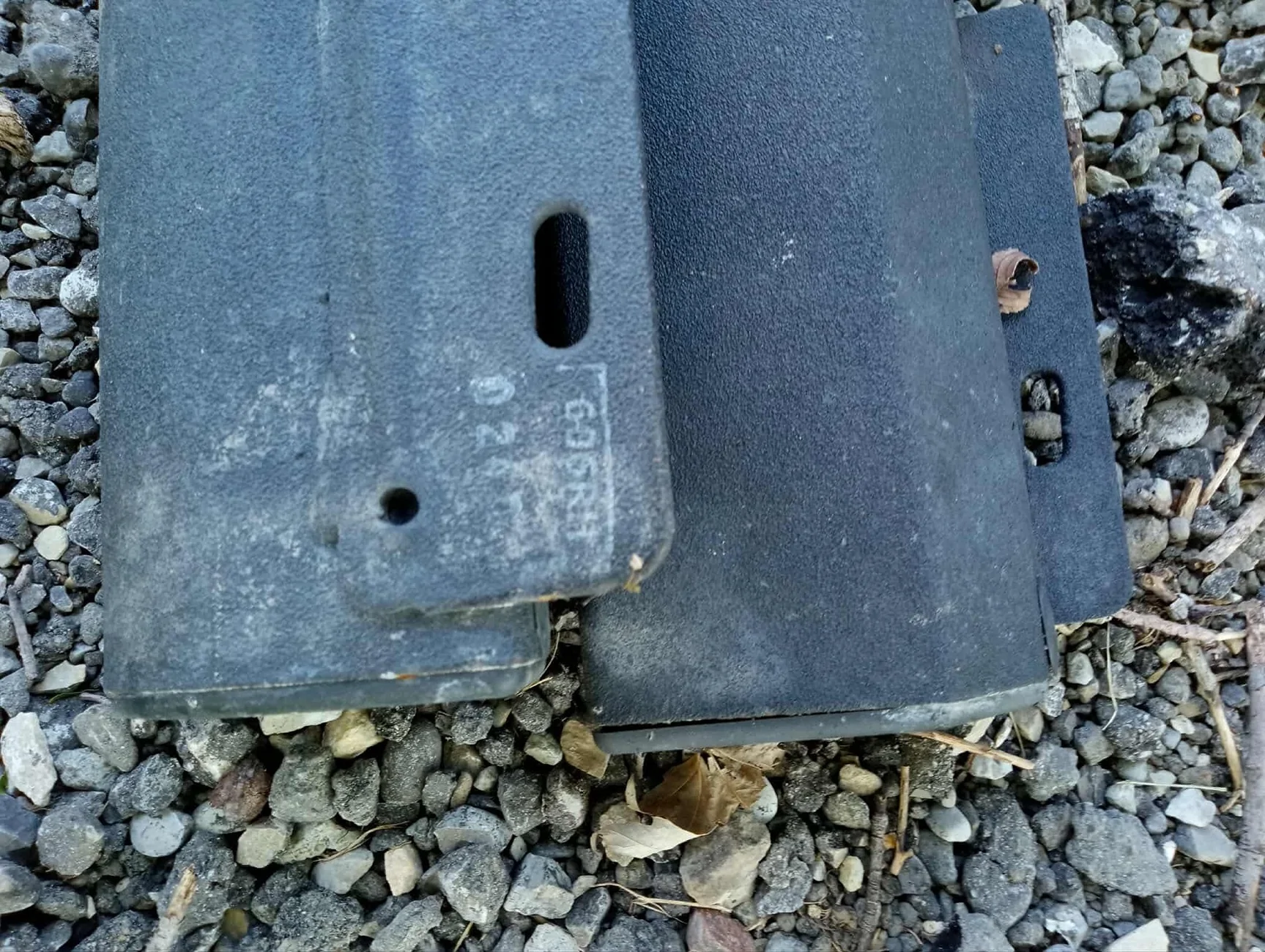

Hello,
I am wanting the OEM Step Assist Rock Sliders, and I think I found some, but the guy doesn’t seem to think they are the right ones. I’m pretty sure they are, but it’s a 3hr drive and I want to be positive before I waste both of our time. Can anyone on here help verify them for me? Here are the pics he has sent:

They do look like my Mopar performance rock rails that are wider than the stock Rubicon ones

The way those photos are taken, it’s hard to tell. You’re looking at the sides. The bolt hole/bolts mount horizontally. Those looks like the standard ones that I pulled off my ‘21 JTM.
Maybe find some YT vids of someone replacing their standard ones to get some visuals?
Nevermind, I was wrong; those are the tops; yes, those are the performance ones. There are like 3 protruding pieces where the bolts mount vertically, and then like 8 bolts/studs that mount horizontally. The horizontal ones will go through the pinch seem and the vertical ones will mount to the body.

I just took a closer read. You're asking if these are step assist rails. These certainly have a wider top than the standard rubi rails.
Thanks! The pics he sent were throwing me off and I couldn’t tell the angles.

They look like the standard ones to me, and not the performance ones that are more like a 2x4

I just went out and looked at them. The rails pictured above do not look like them. No sill studs in the pictures above for one thing.

NOPE! They sure look like standard rock rails not the optional Mopar Performance Step Rails, they both install the same way same bolts but the top surface is maybe 5-6” wide and bottom is wider also and they work as rock sliders pretty good . Do not drive there , get him to take another picture from the outside view to see condition but also you are looking for a groove down center, and a much wider step area. I don’t have good pictures but these show the grove I am talking about. I love mine and they are holding up great for me a poser!….Jack
