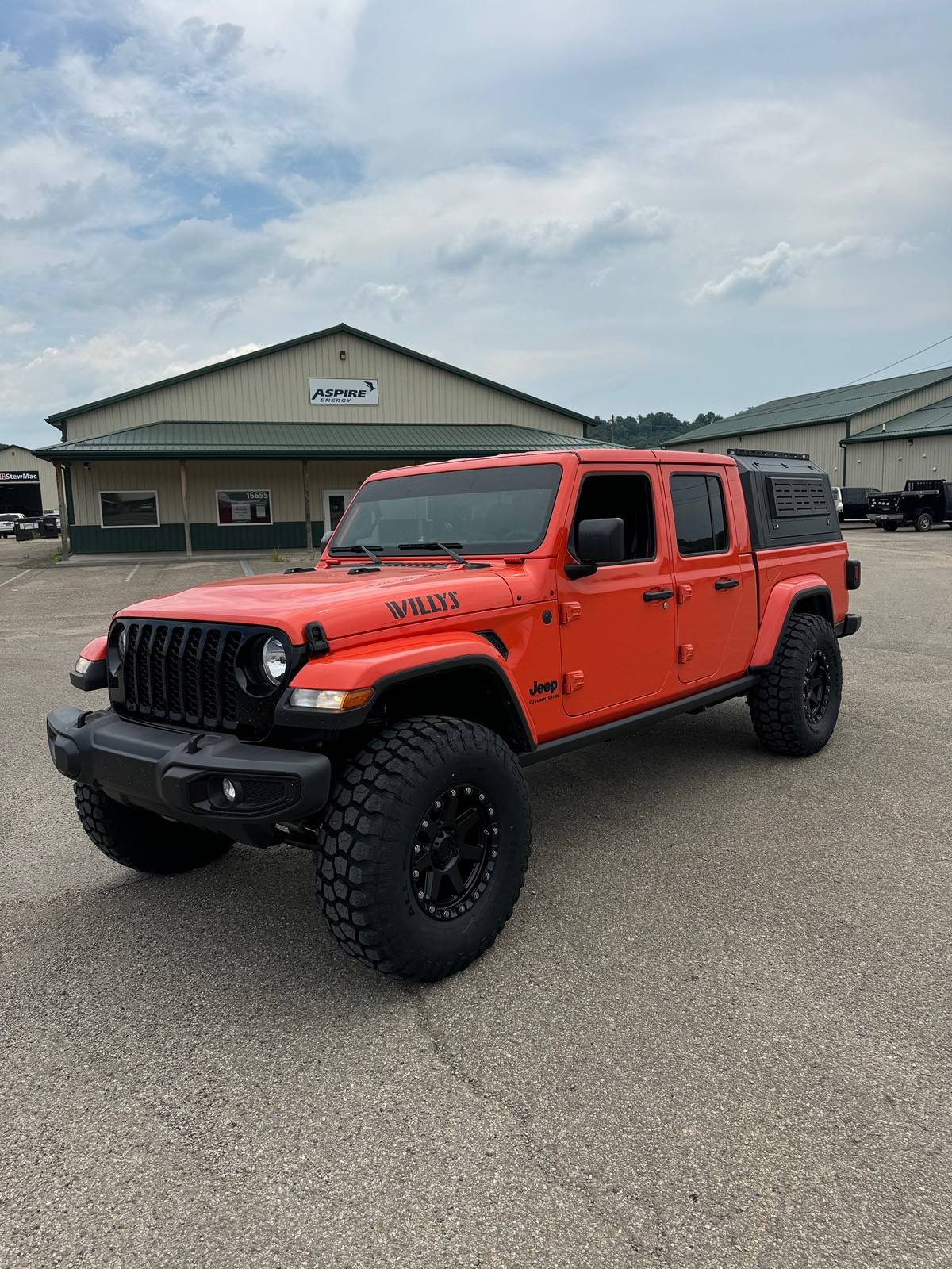

First post here, so hello everyone!
I just got a 3.5” rough country lift put on my diesel gladiator and 37x12.5 17 tires. Since I have a heavy metal topper, my rear is about 1.5” lower than the front. Giving that ugly appearance I don’t like with the front up more than the rear.
My question is, is there any add-ons that I can do to get myself a couple more inches in the rear (spacers, etc)? That won’t mess with my rough country kit? Any help is appreciated.
Thank you!

Either spacers or different rear springs.

I think you’re gonna have to mess with your rough country kit… your truck will thank you. The more of that RC crap you can remove the better it will be.

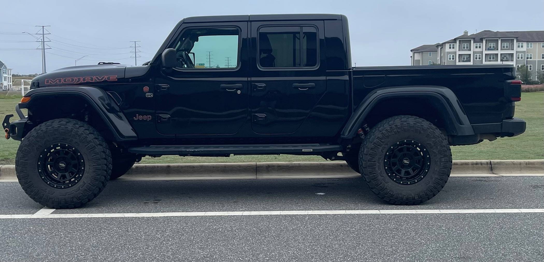

I have the similar RC kit for the Mojave and had to replace rear springs with Rancho HD.
https://www.gorancho.com/products/rancho-rs80139-coil-spring-set
I added some more parts not in their kit to correct the rear. Track bar, driveshaft carrier spacer, upper control arms, rear brake lines.
RC kit

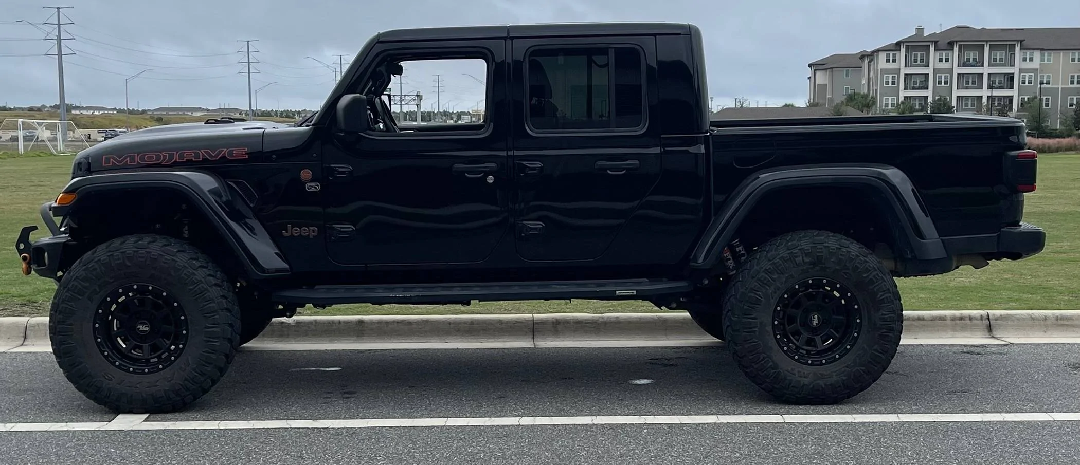

Jeep Gladiator Help with lift issue in rear - diesel gladiator IMG_7392
RC with new rear Rancho sorings
Jeep Gladiator Help with lift issue in rear - diesel gladiator IMG_7398
