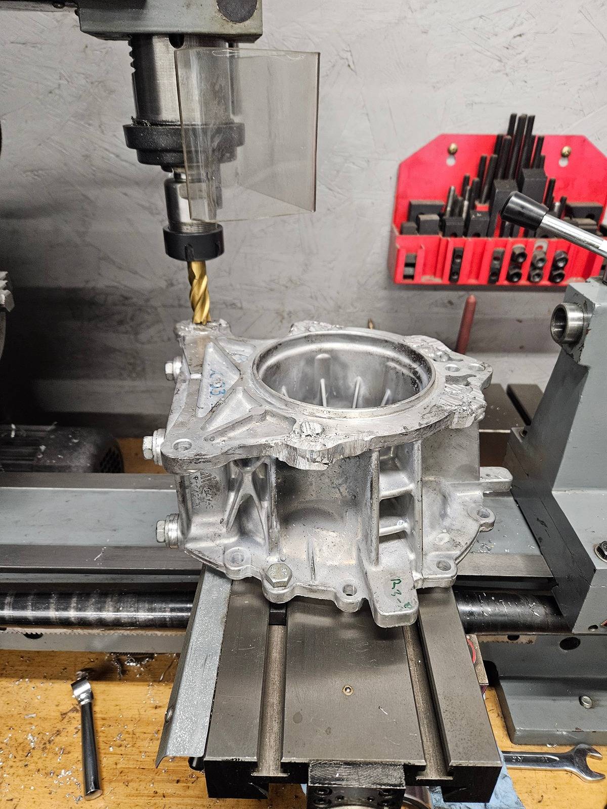

Hello i true i sended a message to them from suggestion i got from member but
I cant see in my sended mail so i will try to reach them by phone today they tune seem to be very apreciated . The thing here is a blend from 2 vehicle in one pcm so there no real product as per that date that i know on the market that is suited for this application yet i think this need to be customised
I took information to my local dealer also and is not afraid to do pcm adaptation that could be an other solution for now
As per your build a tricky one for will be around tranfer case to tranny adapter, seem prety close when looking and cherching on net but i discover that 8hp70 have rely different bolt pattern than 8hp50 there only 2 bolt over 7 that fit you need to weld and machine to fit 5 others but on the center the shouldering is the same so you cannot go wrong on alignement there
