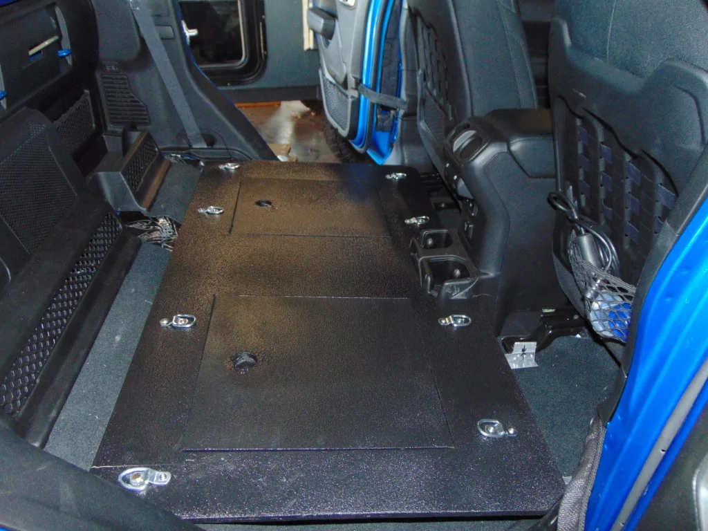

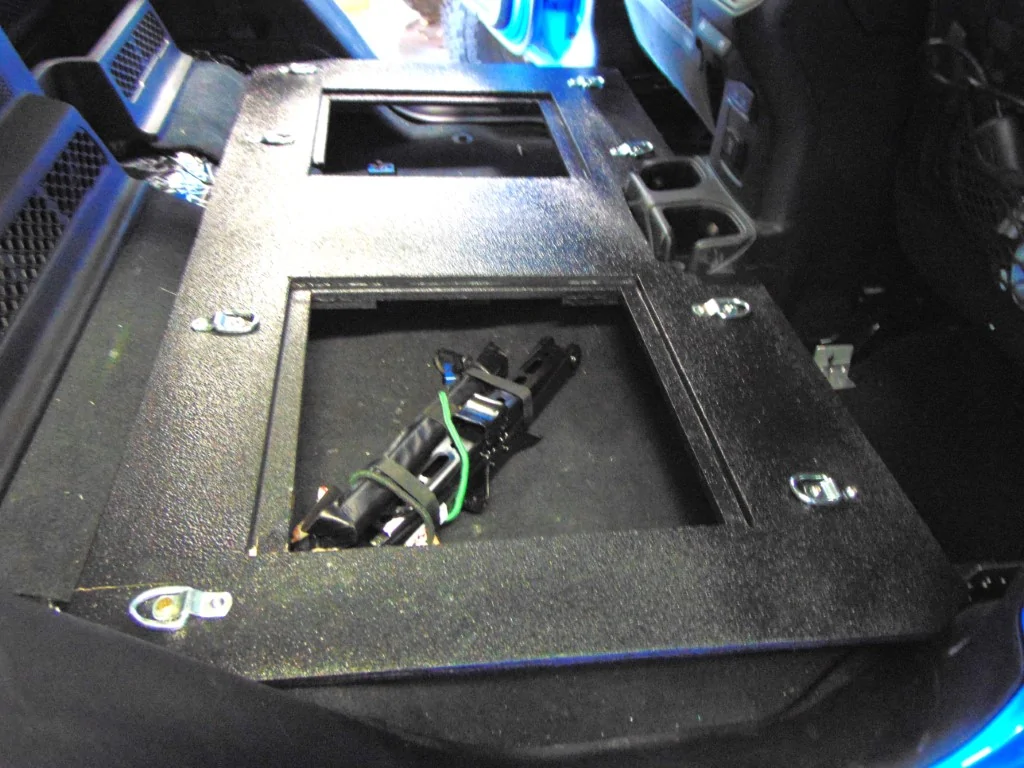

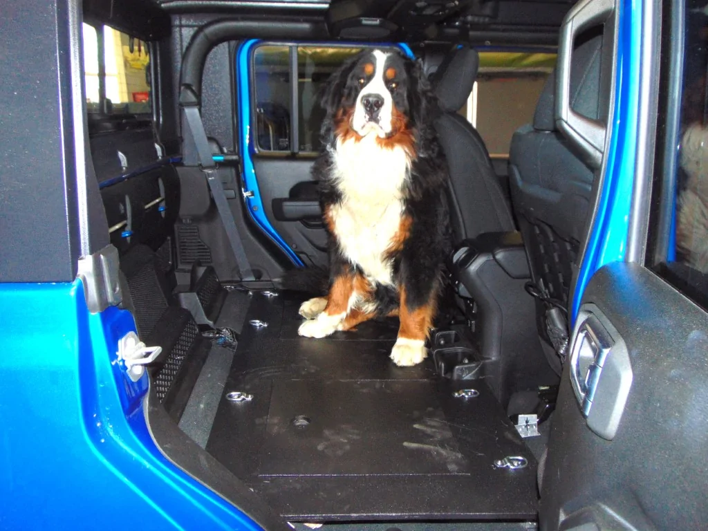

I don't know if you've mentioned what's happening inside the truck, but if you're doing a rear seat delete you could just roll the tire in there 🤷‍♂️
Completed some time ago.
And no, the pup would not be willing to share his space! ;-)
Ha ! I just started to make a seat delete for my pup. . Fellow AV8R as well. Following this thread. I found a 392 SWAP place in Florida 25k out the door. And also this is my first post on this forum. New to Jeep.
