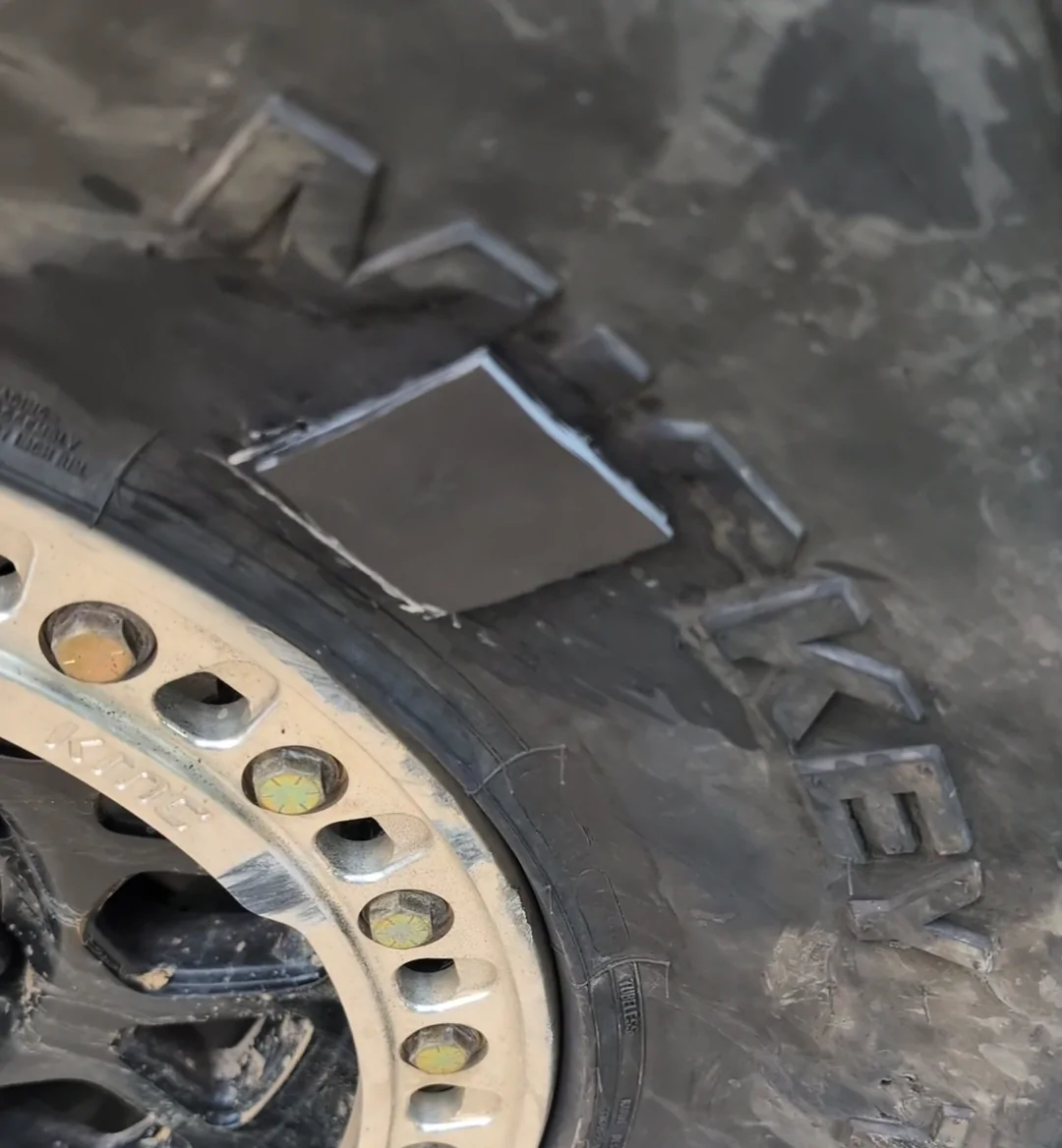

If you insist on carrying a spare, I love your tail gate option you found.
I stopped running a spare when I went to 40s, I carry a plug kit and a GlueTread kit.
I can attest to the GlueTread kit working as described. I cut a month old 42" tire on the sidewall at Windrock and with sanding (a whole lot of sanding to make it smooth), it did adhere to the sidewall and held air from Oak Ridge to near Nashville where I live.
Jeep Gladiator Starting a 6.4 Hemi swap Screenshot_20250706-200919
Technically it still holds air, but it sits at my friend's shop as the spare for anyone who needs it.
I bought a new GlueTread setup as soon as I got home, added a Dremel to my tool kit so I can make the sanding easier next time... The hard part was the letters where the particular gash was.
[/QUOT
That's impressive!
And real-world experience.
So, I have wanted to delete the spare, but it just seems odd, for lack of a better word, not to have one. But when getting to the huge tire sizes, carrying a 130-pound spare that gobbles up precious space becomes a real factor.
I ordered that glue tread kit as soon as I read about it, almost a week ago. It will be a permanent part of my kit from now on.
I also like that tailgate replacement, but...
It will cost a couple of thousand. It will add more weight and mess with the center of gravity. I don't like any of those factors...
