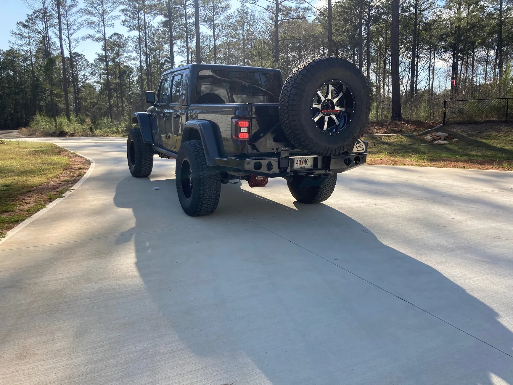

half a billion years ago when i was into drag racing, the mindset was "there is no replacement for cubic inch displacement"! 2" of height gain 36" to 40" is of the same mindset and it yields immediate results. if you can find full under body skid plates for your long arm system, you would be completely amazed at where you can go without fear of damage. yes, you still do it at 1.6 mph but it is so much more enjoyable.
the increased rotating mass of the larger tire does present the possibility of a myriad of problems but so does losing sleep over exactly when will our sun burnout. process your concerns accordingly. at 79 mph with 40s and 4.88 gears i'm at 2150 rpm in 8th gear. if i'm heading up a grade or have a strong head wind the jeep will select the best gear. as you stated you own the 5.13s and you are sensible when off road. i agree with your assessment of the d44. i drive mine with the same mentality with a strong bolstering of the fact i do not have d60s. also, i'm always in m1 - m2 when in 4lo. so much easier when braking.
i did not want to give up bed space for the spare as the gladiator is my only ride. i went with the Expedition One S3 bumper tire carrier and a cheap amazon hitch skid plate. departure angle problem solved.

yes they are Maxxis AT 40x13.50x20 and i enjoy their on and off road manners. they are my second set. i put 40k on the first. the lowest price for these hides is at walmart.com! who would have guessed.
when i did the build i installed jeep's heavy hitch. it is compatible with the new bumper.

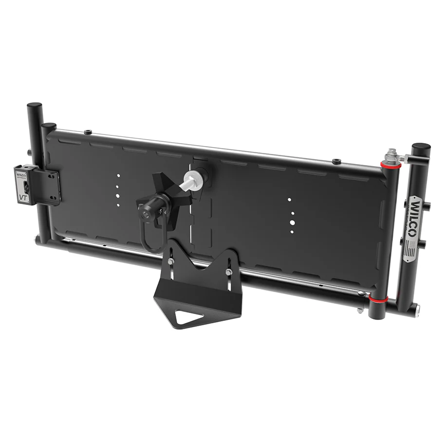

I was immediately faced with the spare tire dilema. Good news: The underside of the bed is gonna get a lot cleaner.
Bad news: No place to put the spare that doesn't take up bed space or add a ton of weight
Then...
I found this:
Jeep Gladiator Starting a 6.4 Hemi swap gladdy 1
This is a cool tire carrier that replaces the rear tailgate. What I like about that is the fact that at least I lose some weight while gaining some with this replacement steel part which has to weigh a bunch more than the tail gate.
Jeep Gladiator Starting a 6.4 Hemi swap tailgat

That is one of the nicer options I have seen, better than the bumper mounted ones. But it still puts a lot of weight way out on the backside.
I just don't run a spare unless I am making a trip.
