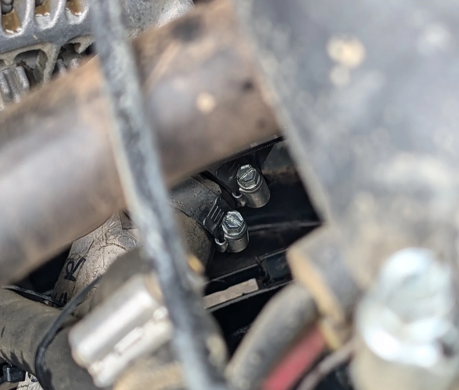

Since you are waiting on your 6.4 swap, I thought I'd share my most recent drama with mine...
And no this is not because of the rain or a car wash...
There's a unique bend in the coolant hose, that apparently solved with a coupler right now and two hose clamps that apparently aren't going to work out....
Jeep Gladiator Starting a 6.4 Hemi swap DoubleClam
Best picture I could get of where the leak is occurring. Had to get into an O'Reilly's and grab a gallon of coolant pre-mix to drop in her. Looks like one more thing to add to the punch list to get straightened out.
Oh man! That's no fun. Well, at least you get to burn your hands and skin a knuckle or two getting in there. You have that to look forward to! ;-)
