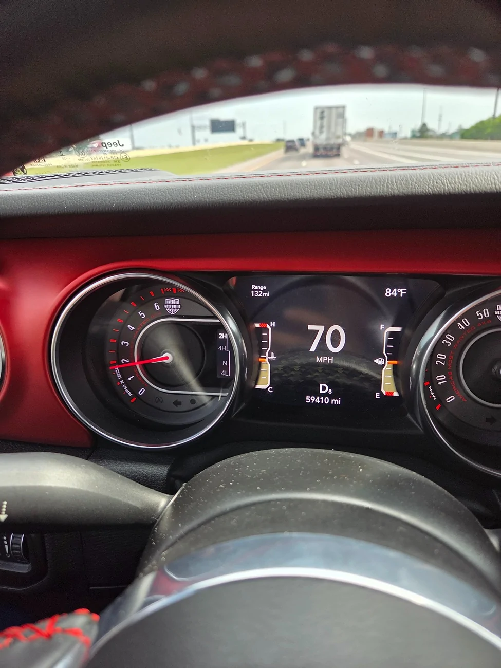

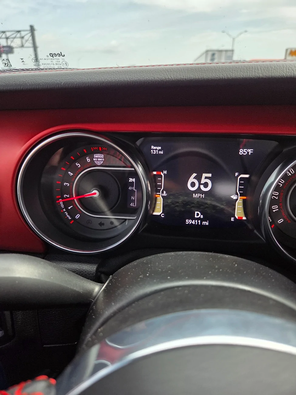

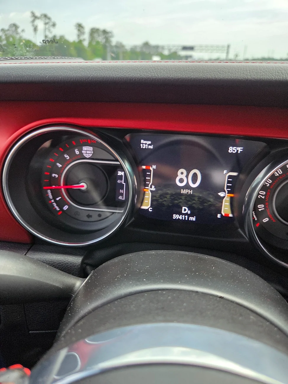

What is the RPM at 80mph?
My Jeep is an AEV JT370. It came stock with 4.56! But I felt it was a sled, so I went with the recommended 5.13. That sort of worked in the same way as putting lipstick on a pig. In the end, you still have a pig.
I placed those 4.56 gears on marketplace where they stayed for almost two years, then sold about six months ago. Perfect Dana/spicer gearsets.
Of course, had I kept the 4.56 gears in the Jeep, well, I wouldn't have kept the Jeep, so it is what it is. The more I think about it, 4.56 seems like the right spot to land. That and stay with a 37"-38" tire. I DO NOT plan to go to much heavier D60 axles. I'm keeping the M220/M210, which are filled with some pretty good parts.
