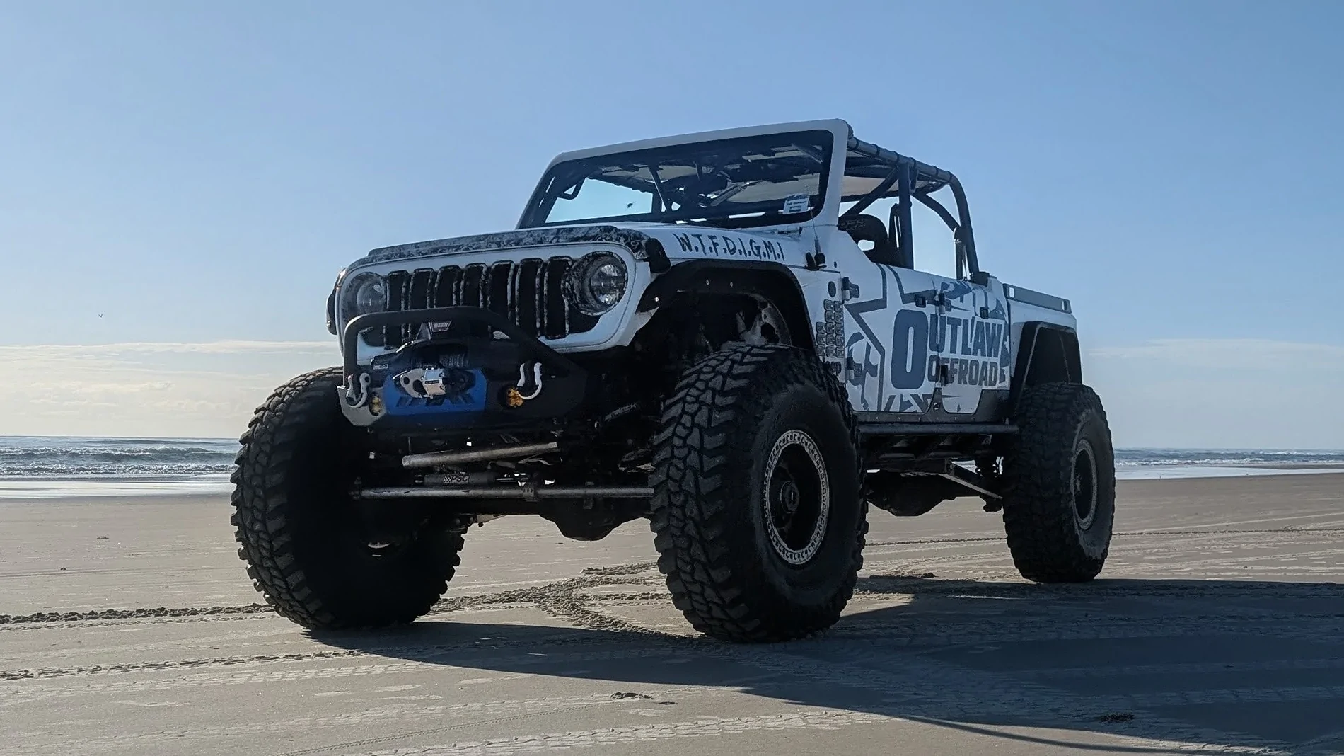

Someone else's thread and don't want to derail it much but 22 Gladiator on ECGS tons, RK long arms, and a 426 Hemi Stroker.
Motobilt armor all the way around.
Just because I run the brand from my friend's shop, doesn't mean I'm sponsored..
I funded this build.
