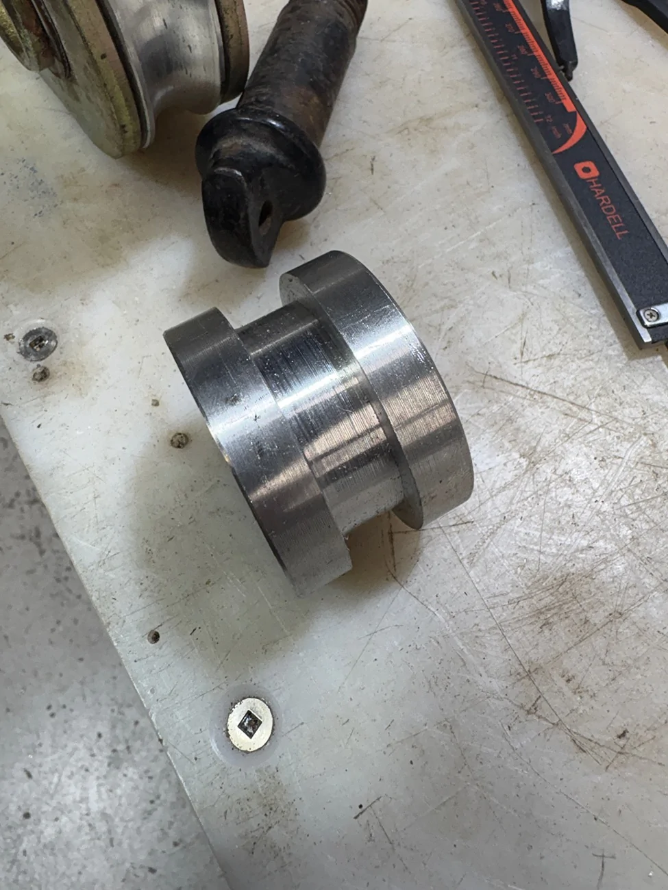

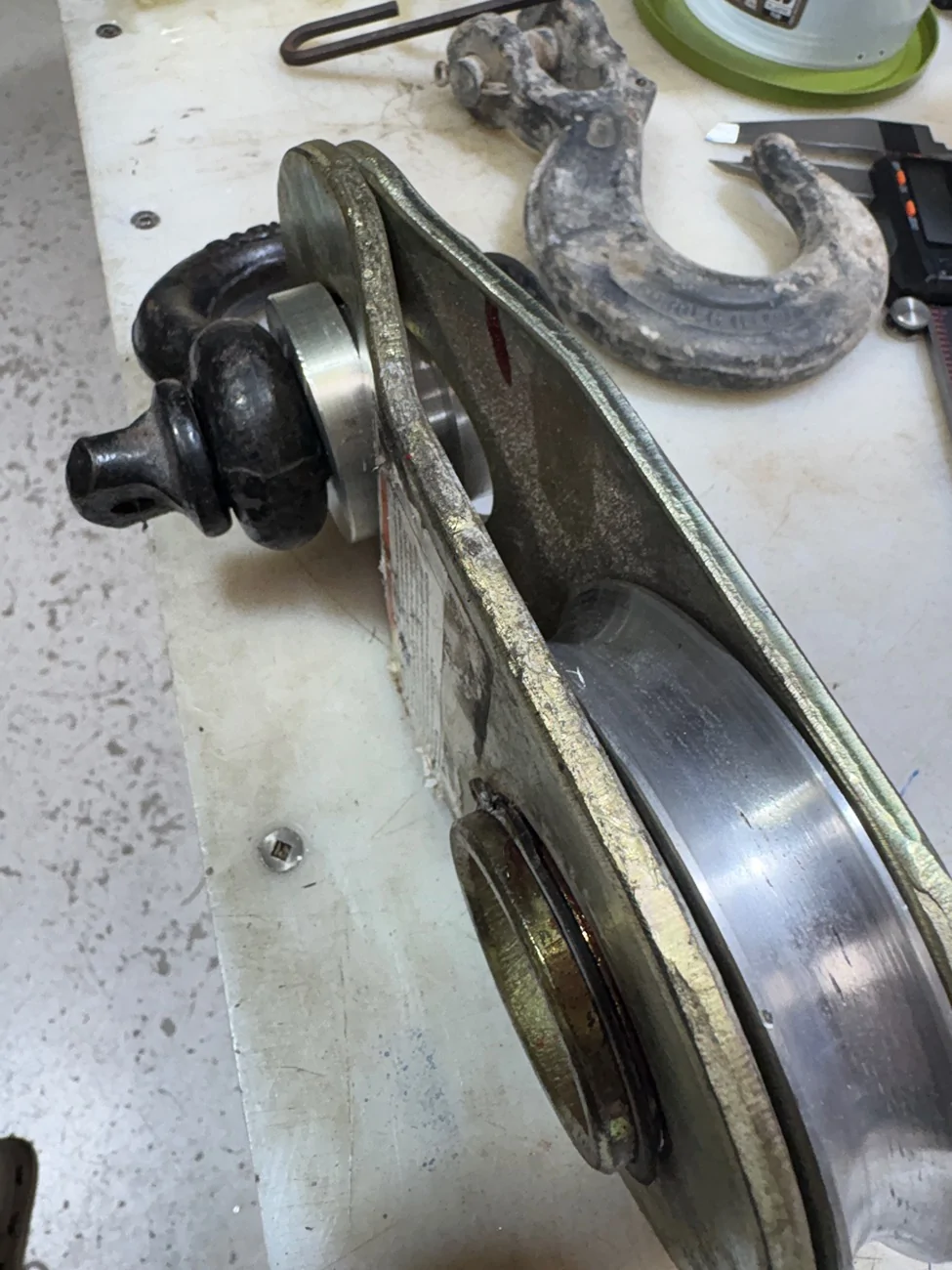

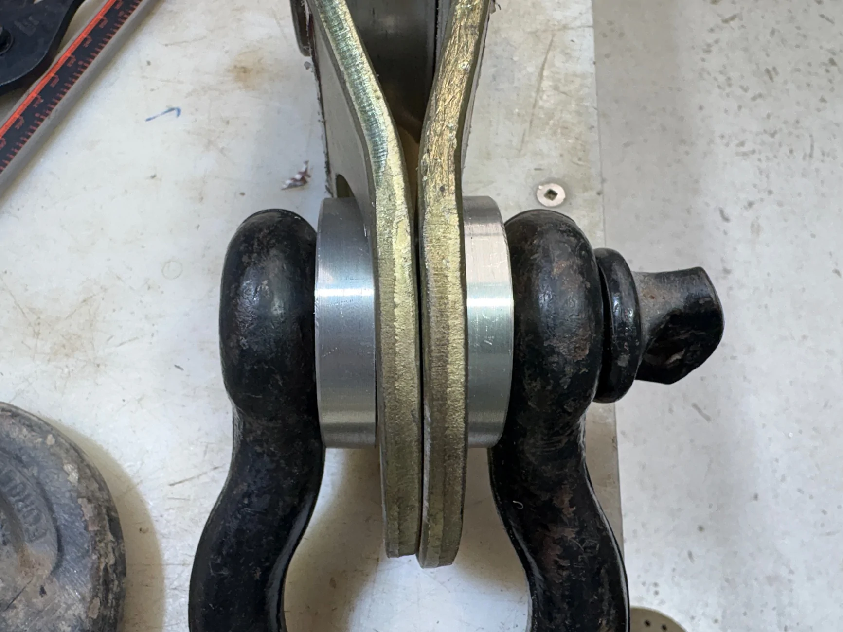

I’ve got a $29 HF snatch block, yesterday while I was using it, the rope slipped between the cheeks and got boogered up. Got to looking at it and figured that there was too much slop when using a standard D shackle, which allowed the cheeks to open enough to slip the rope between. Fortunately I’ve got a good shop, so I made a spacer/retainer on the lathe…

Thanks! FWIW, I don’t use a ring because there’s just too much friction loss. I measured it with a load cell…. Nearly 20%!

i‘ve used the same HF snatch block for years and never had an issue, even under some extreme side pulls. Did something get up inside the snatch block to cause the line to jump off? Once your set up for a pull, line in the proper locations then add a little line pressure to ensure everything is correct, then you can put a full load on the set up. I’m very interested in how this happened, so I can avoid the same.
I think what happened was when I was pulling, the vehicle being recovered got traction temporarily and slacked the line; I didn't catch it out of the sheave until after it bound up. When I winch people, I always ask for them not to "help"..... They rarely honor that request.

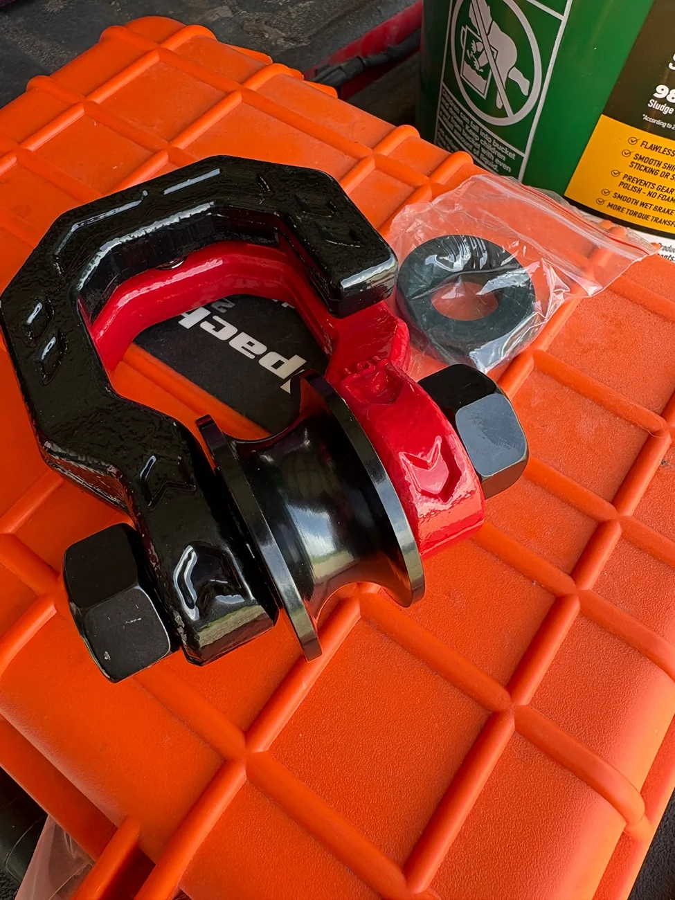

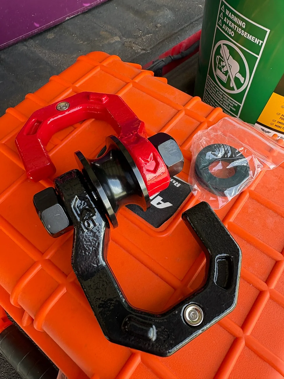

Just picked up this snatch block/shackle combo off amazon. I think there is a lot of potential for rope jumping track.
