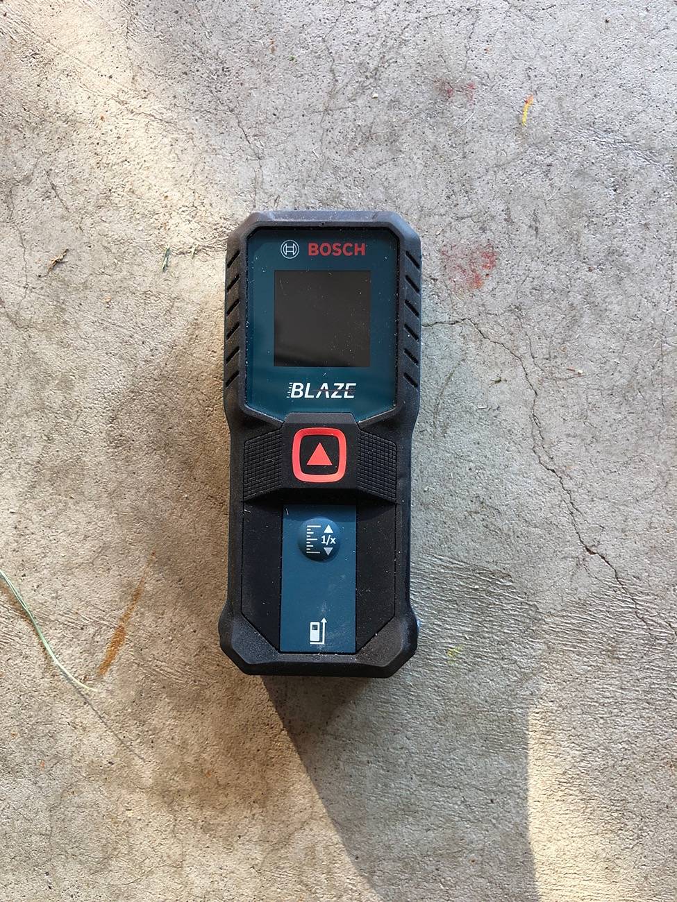

Sorry to hear that; If you are mechanically inclined, you can use one of these to do your alignment on a solid axle w/out too much fuss
