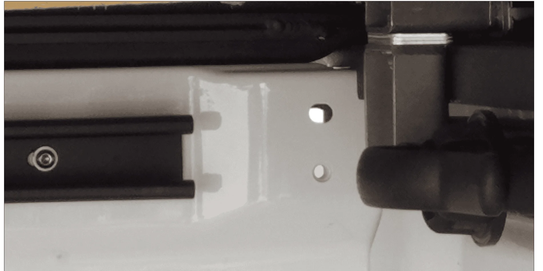

has anybody seen another member mount something through this hole in the upper corner of the bed? I can see daylight, so it might be accessible from the backside.

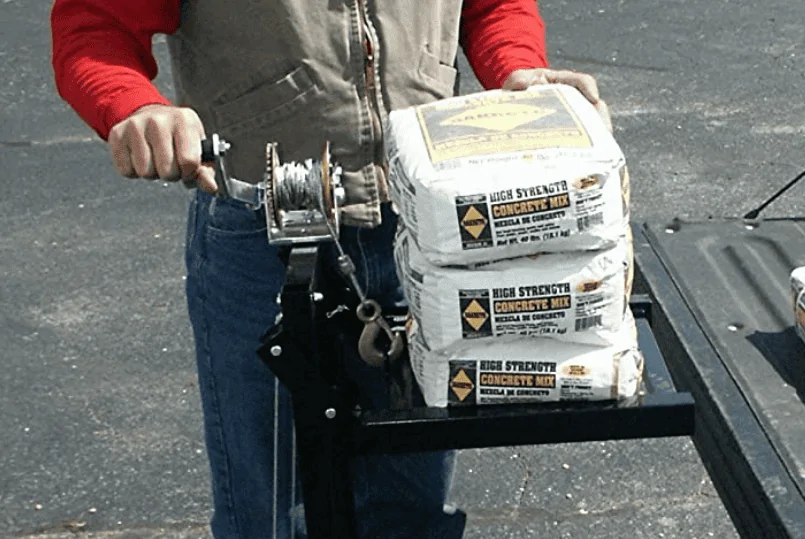

hmmm, the idea is awesome, not sure the design is great. I'll look into this more. Thanks for the link! In case anybody is interested its only $103 on prime.
EDIT: I think i'm actually going to buy one and either use it as is or possibly modify it a bit. If it turns out to be complete crap, amazon has free returns on this item.
This fits the bill though. light weight, portable, looks like faster deployment than the hitch hoist that Rokon showed as an option. Don't put my $4k+ topper in danger, no welding needed.......YEAH!
Might make a slightly bigger platform that sits on top of the black tray and put a cheap plastic kids sled under the deer to slide it into the truck.
