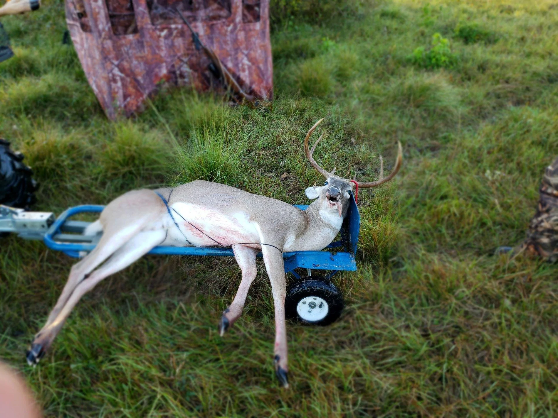

Hope I don't get busted for this picture...I made this deer dolly to tote behind the fourwheeler so we could roll our harvests up...
Jeep Gladiator Gladiator Deer Hoist:  Calling all engineers 20191102_083810
...might be a little steeper angle hooking it up to your JT until you get it to your hanging spot, but the physical lifting to get 'em mobile is the same.

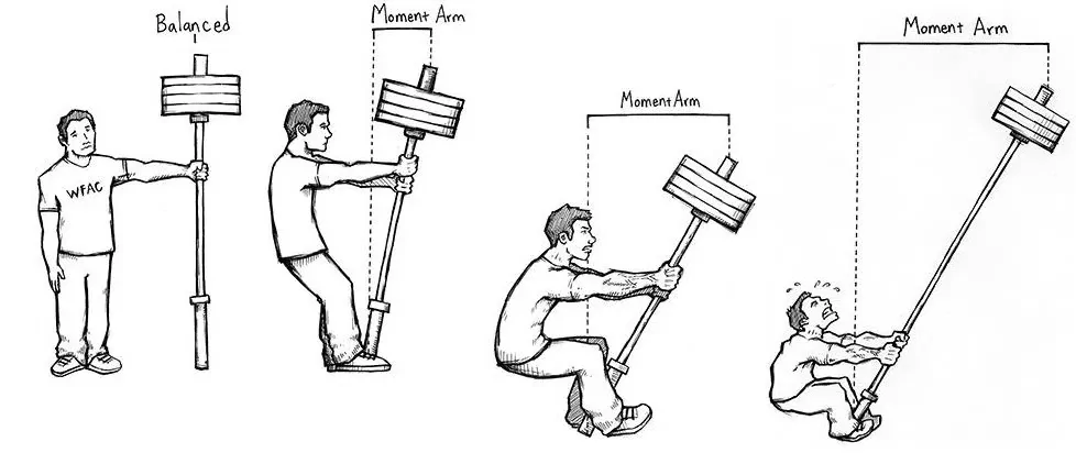

Engineer by profession, dork by choice. This is the whole reason you use a breaker bar on your tires not a 3/8" stubby ratchet. The farther from the base of your lift, the "heavier" your lift is.
nice rig! nice buck. is that a 6? that's the largest 6 i have ever seen.

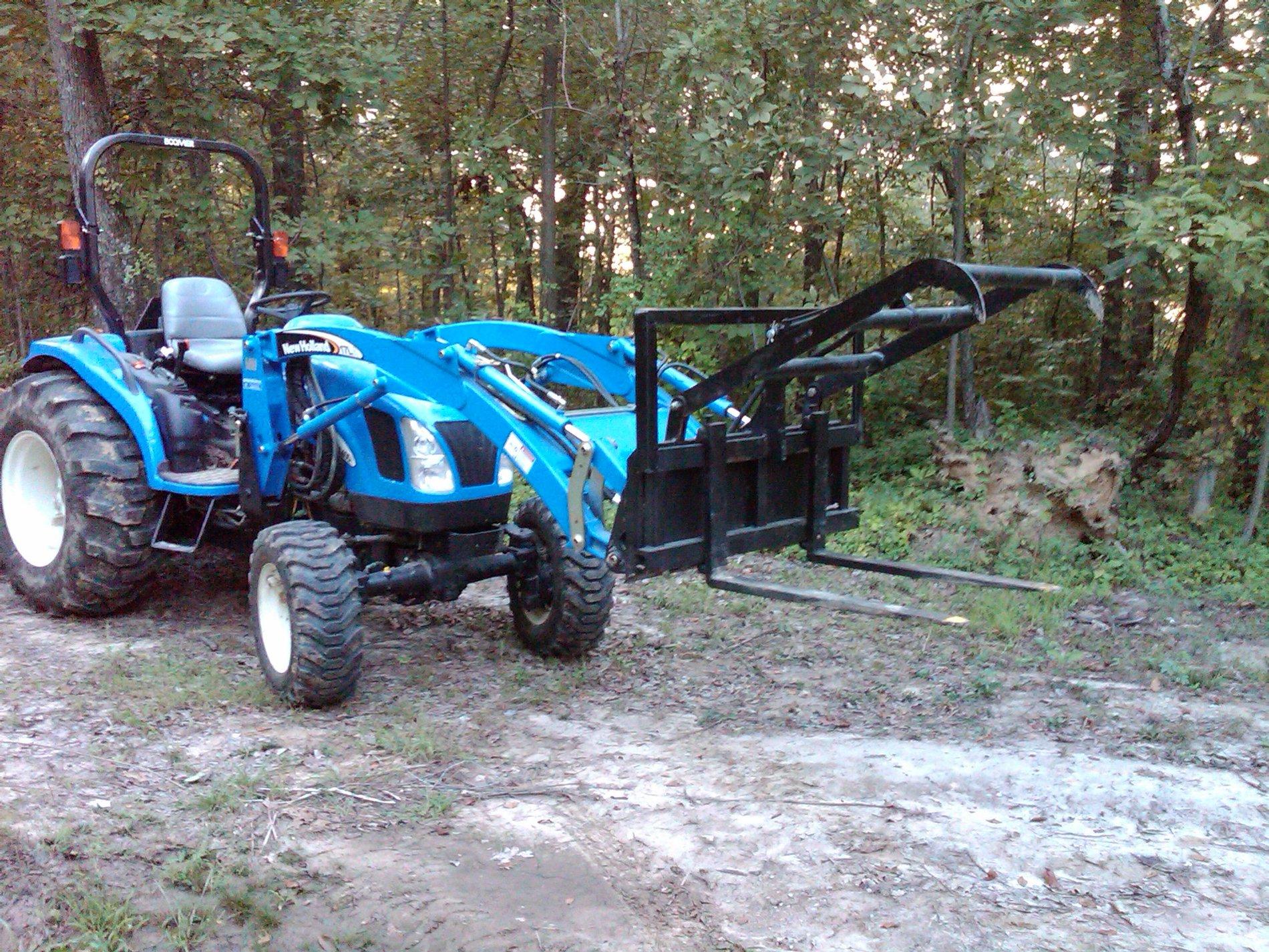

What about this......?
i saw that one, i think its only rated for 300 lbs (fine for most deer, but I think over time it would break, somthing rated for 1000lbs could handle 300 lbs all day, maybe that's a dumb non-engineer thought to build it overkill), also it blocks your access to the middle of the tailgate I believe.
