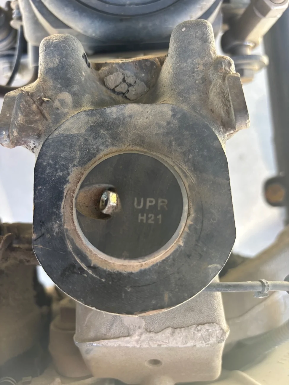

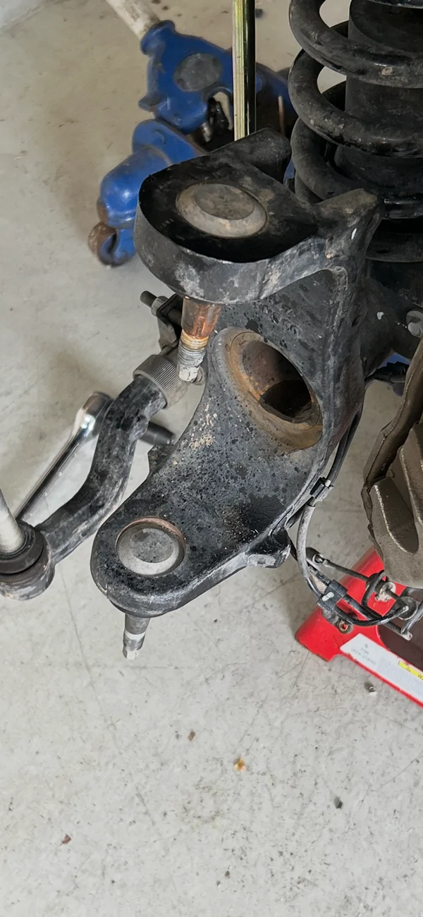

Slight thread Jack: Can somebody post a picture of stock ball joints installed on their Jeep? Trying to determine if mine are aftermarket or not. :like: :angel:

post a pic, there are only 3 decent ones (and the mopar performance ones that aren't any better than the stock ones.
I’ll be out working on it after I get the dogs taken care of. $50 says they are Synergy. PO went a little dippy on Synergy stuff for the front end. Not that I mind at all.
JT1
Nov 13, 2020
747
723
Oklahoma
2021 Gladiator Willys
Synergys are pretty easy to spot, they have a cut bevel with a needle zerk on the top of the uppers and lowers.
Dynatracs have a snap ring around the top of the upper ball joint.
Baller Joints have a giant nut on the upper to keep the knuckle from separating from the inner c if you blow up a front axle shaft/lose a unit bearing.

100%
Keep them greased and they should last a long time.
Yep. Need to get another needle end for a grease gun. Only one I have is on the gun for the RCV axle shaft grease and that gun only hits the RCVs. That grease is SPENDY!!! I’ll just pick up a Mini and stencil “Balls” on it. I like having job specific grease guns. Saves me making a mess trying to switch in and out grease tubes unless I have to. I always end up covered in it. :CWL:
I still hate needle fittings, but I hear you on multiple setups for grease guns.
