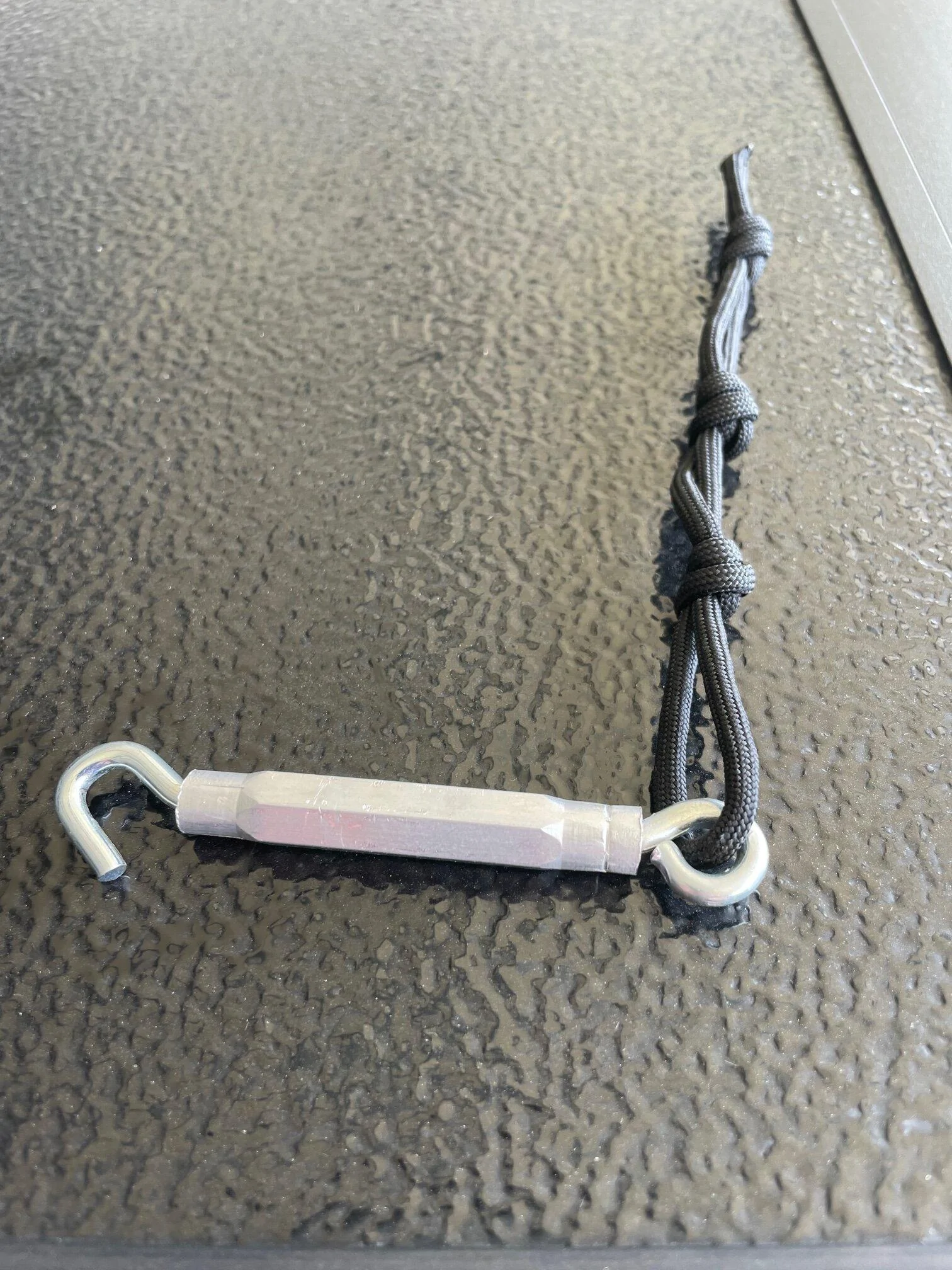

tossed this together today,,,,,, those suckers a tough
  1. para cord over the hook for the nylon strap
  2. hook through the check strap
  3. open the door
  4. adjust length for front and rear doors by the knots
