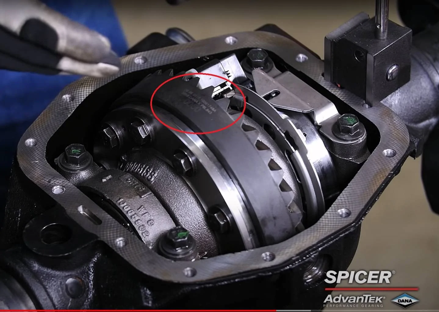

The ratio should also be etched on the side of the ring gear
Okay I was just under there. Consider me a rookie:). Where is the ring gear?

Located under the differential cover front/rear. Will be either etched or stamped in the ring gear.
What @JTenn described is a easy way to get a close estimate without having to pop the cover off. To be 100% accurate, best to pop the cover and check.
You're awesome! Thx!
