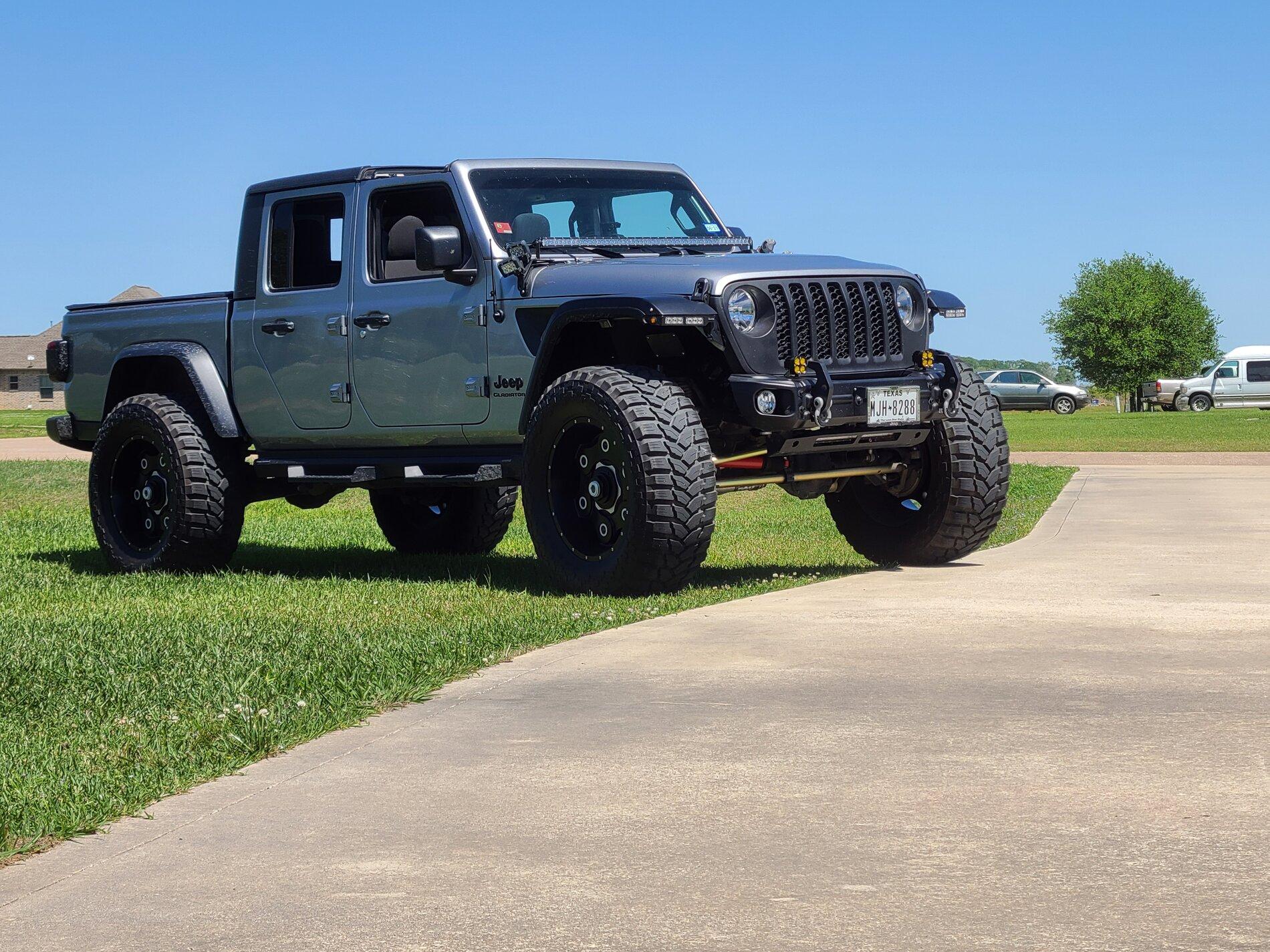

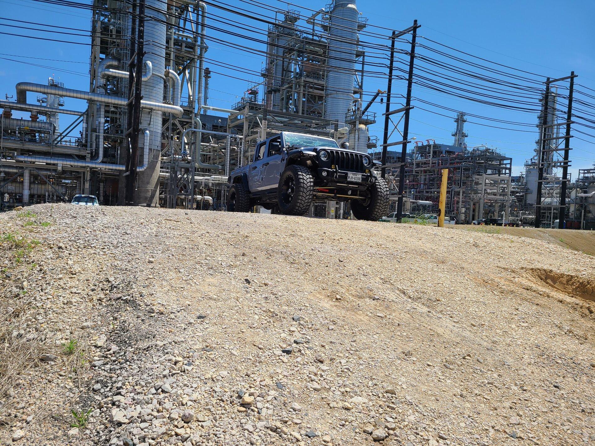

I've been running 40's for about 10k miles and have had no issues with the steering. I do not rock crawl or do anything approximately close to that...its a daily driver and weekend beach cruiser.
How’s the steering response on that when moving 40” tires?
I really haven't noticed too much of a difference from the 37's I had prior. I just don't do too many things to test it.
