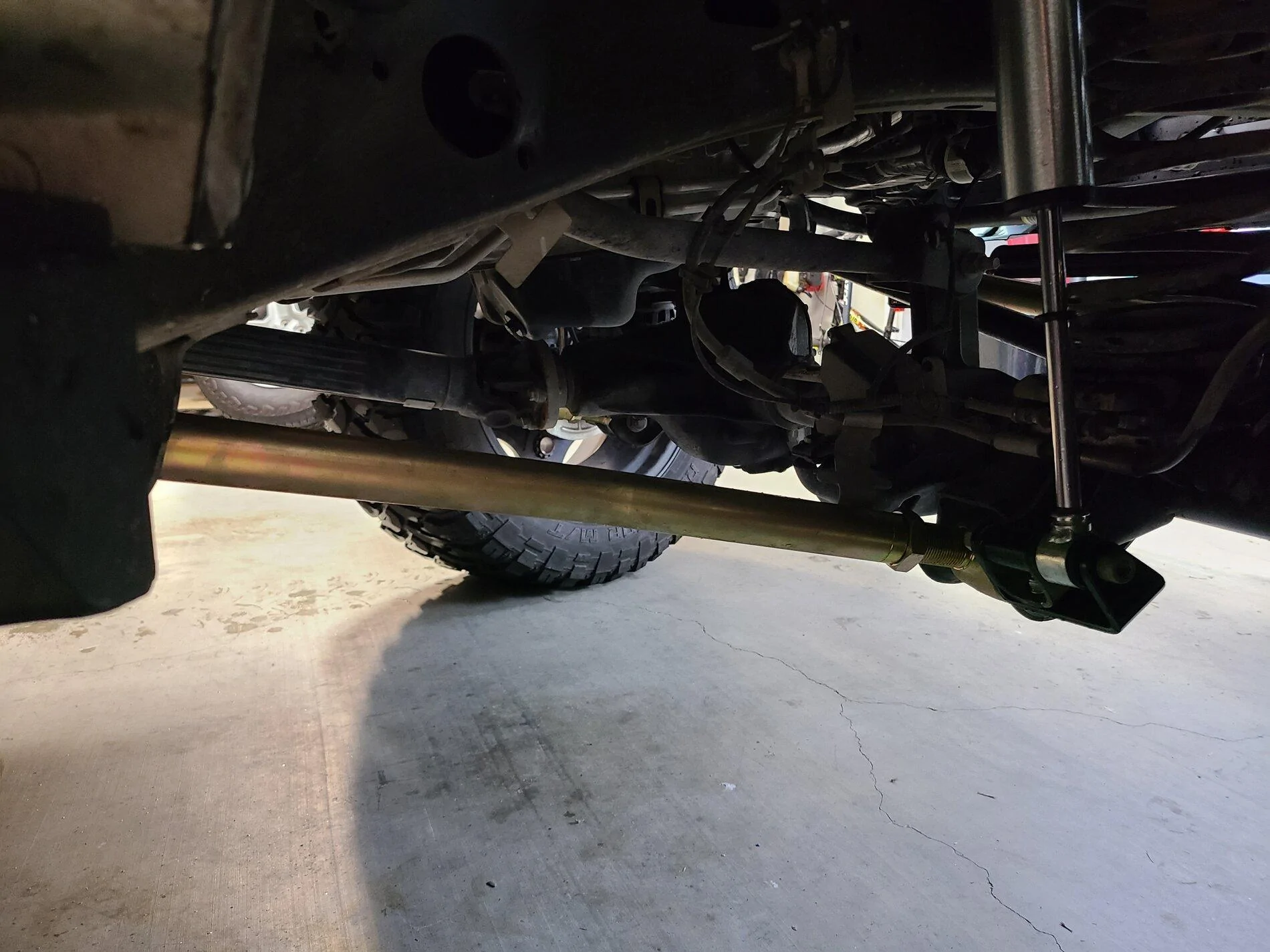

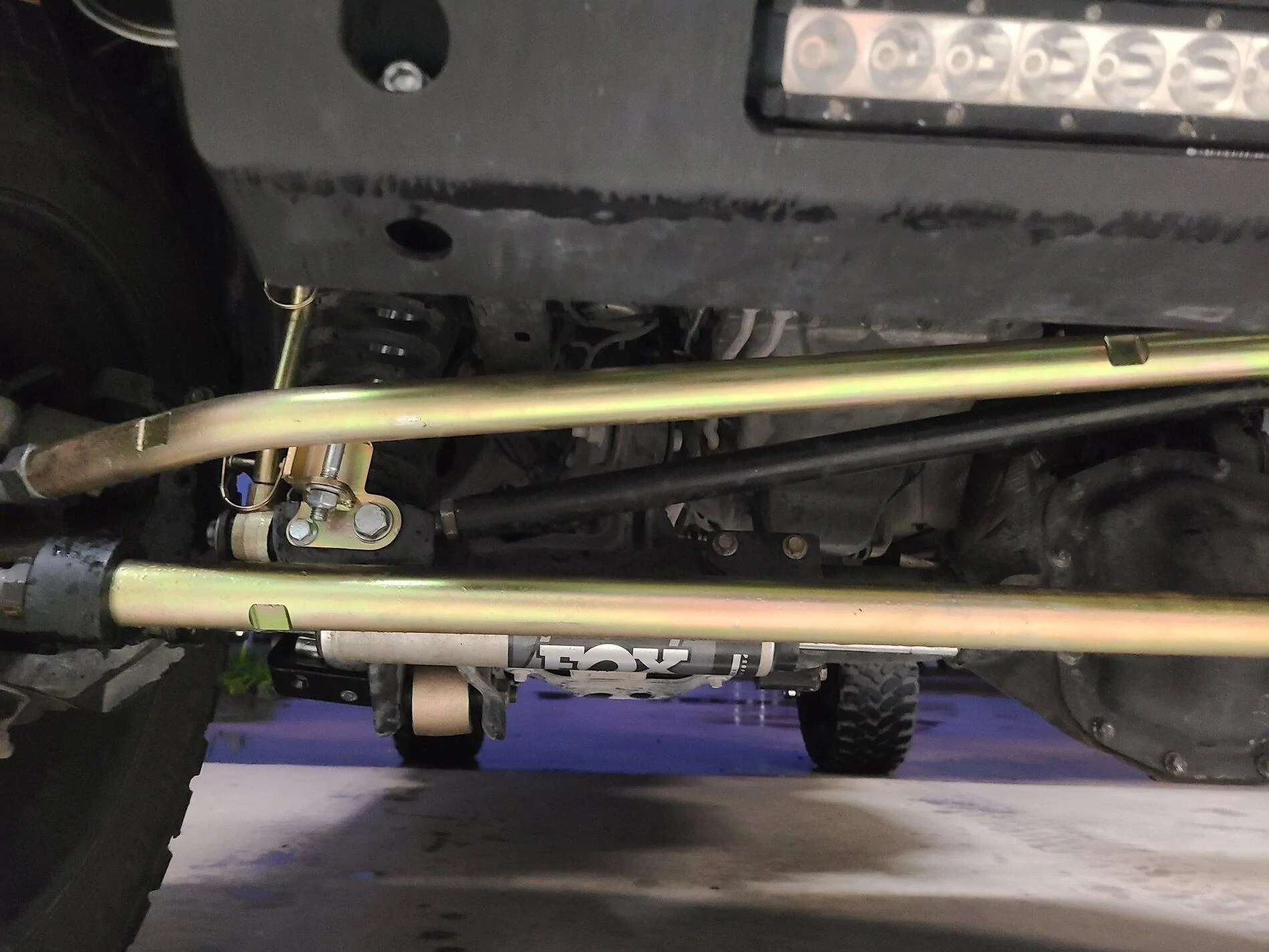

How many miles on your truck now? This is a perfect example of why not to use anything skyjacker. There's no reason you should have warn out joints and "out of round" tires already.
The added caster should help a lot, glad to see you got it to someone who has a decent idea of what they are doing, unlike dealers.
30000. I'm not sure whether the suspension parts caused the out of round tire issue or if the out of round tires caused the wear on the track bar. Admittedly the Skyjacker lift is not super high quality, however, it was one of the few that were available in July of '19. The trackbar is pretty puny when compared to other aftermarket options. I believe my real mistake was buying cheaper tires.
