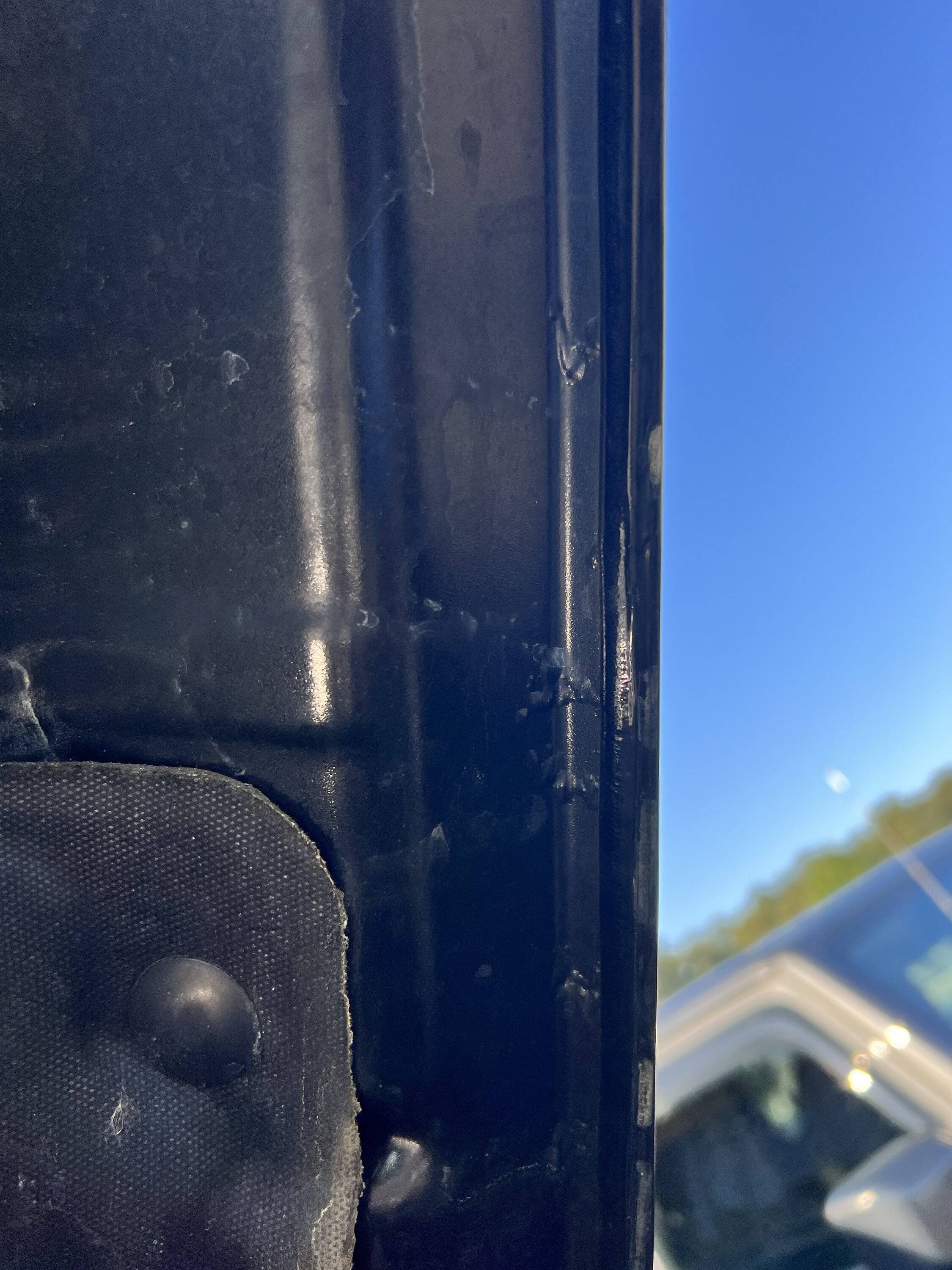

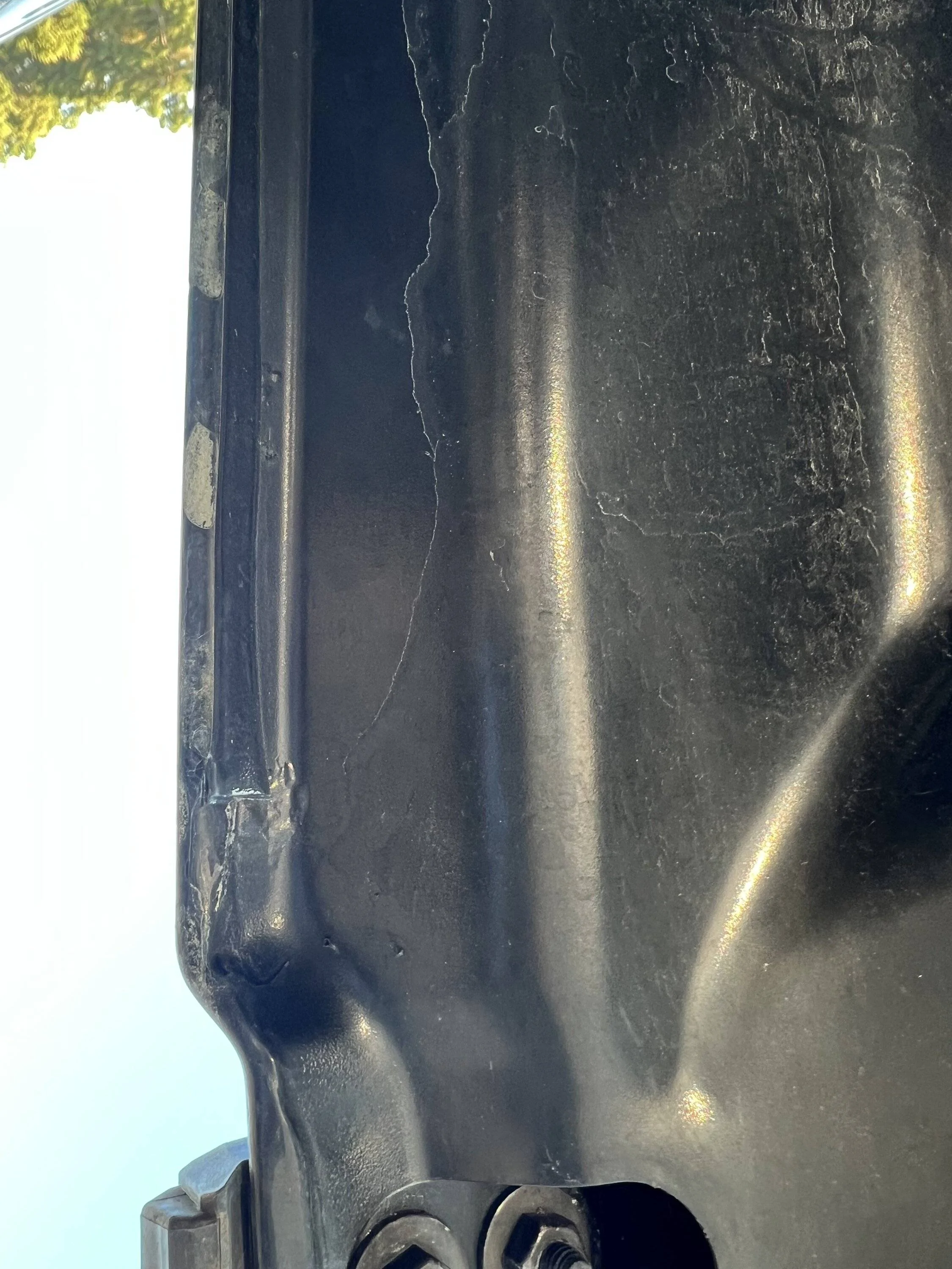

So I opened the hood and checked it today… I was pretty shocked at what I found. I have rust in the same spot on driver and passenger sides AND the under-hood panel. FYI: pictures suck

That is nasty. I would almost argue for a new unpainted hood to be painted for replacement than deal with them trying to get that under control and repainted.

Yeah, the fact that it is blistering on the underside panel as well has me thinking along the same lines.

I doubt it's the paint itself - problems like this are almost always the substrate or the prep. (or a problem with the processes making the metal panels or hood skeleton causing issues with the surface of the metal)
Most of the non-Jeep bubbling I've seen has been exactly like this along hood edges and so on.

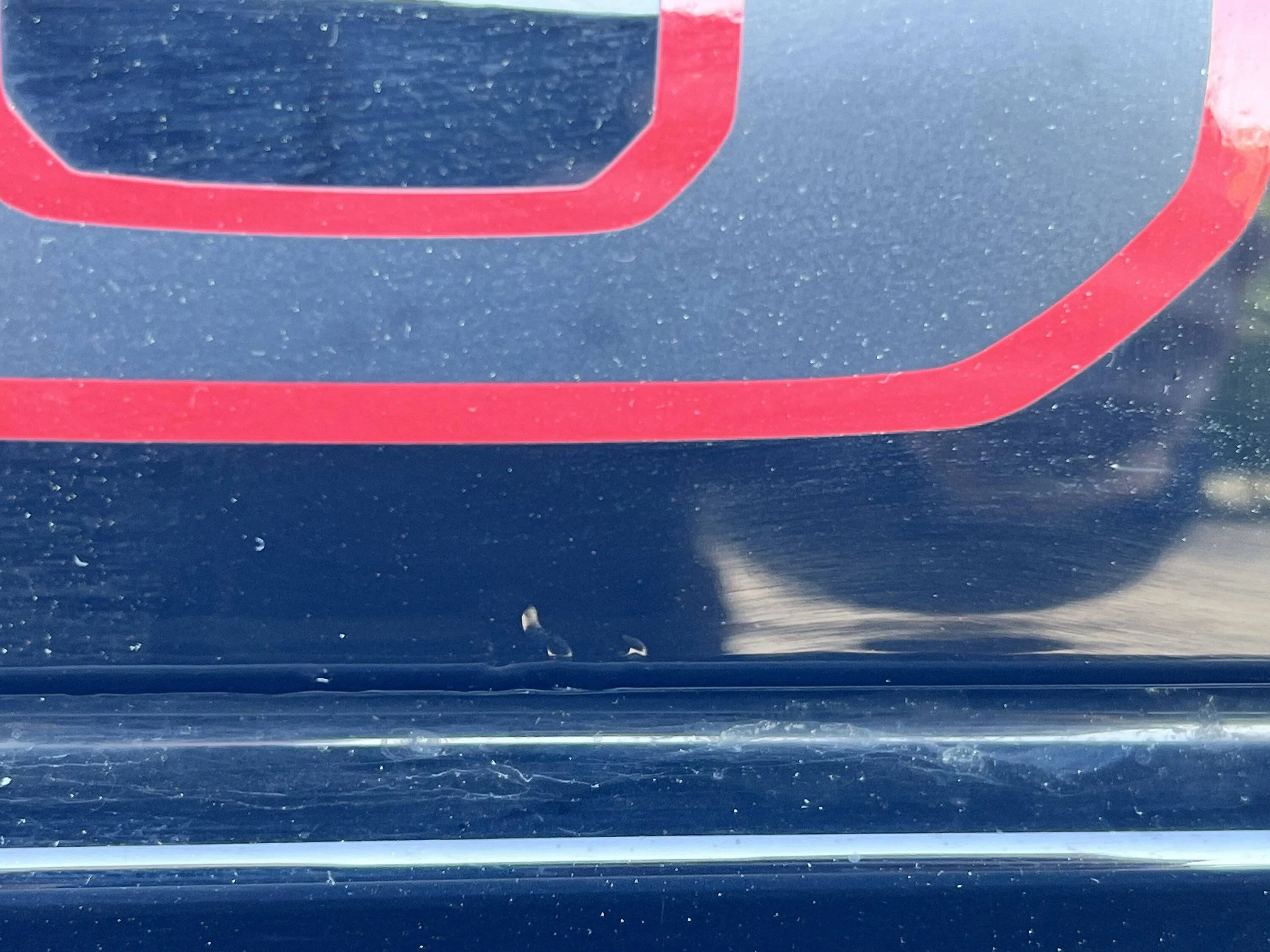

I noticed my hood is starting to bubble. At 43,000 miles. Need to bring it in soon. My daughter's JL had hinges on 4 doors bubble over 50k, warranty wouldn't cover it.
I am under the understanding the corrosion warranty is 5 years unlimited miles.

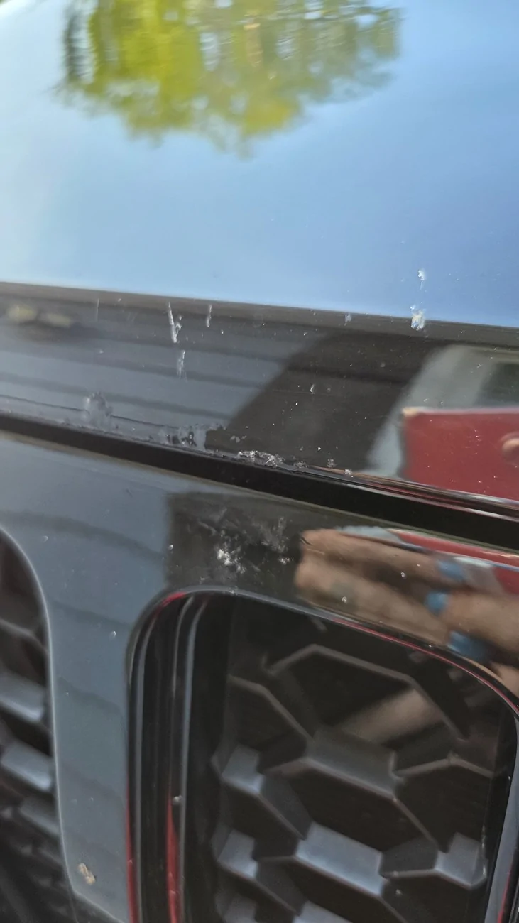

Same problem on my 22, just found it during a wash. Sad day today.

Get it in ASAP. And if you have dealer options, you might have to go to a couple different ones to see who can take care of you.
I had a Jeep dealer (Yark in Toledo) tell me 6-12 month wait and my warranty would expire while waiting.

Yeah I think thats gonna be my problem. I'm scheduled to take it in Monday. I'm kinda freaking out bc im literally at the edge now. Ty
