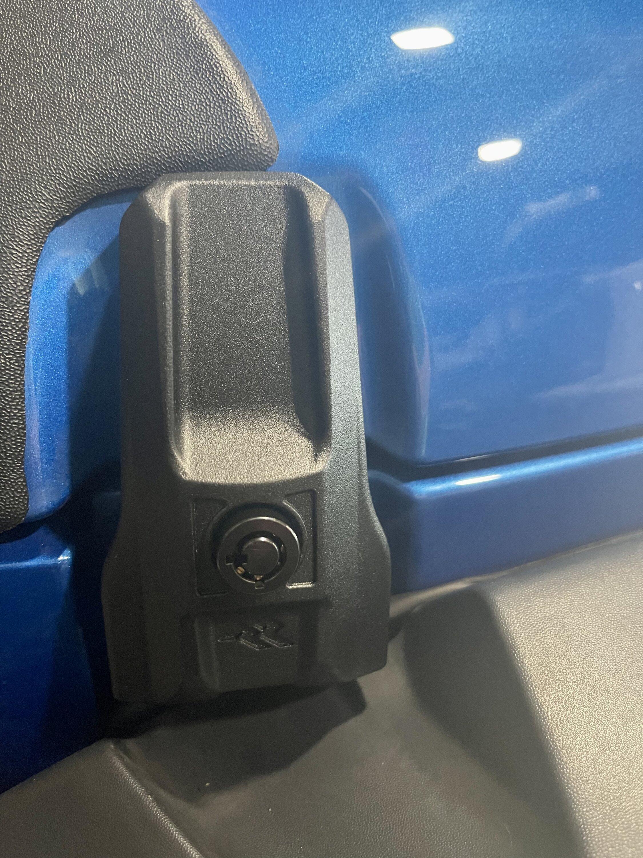

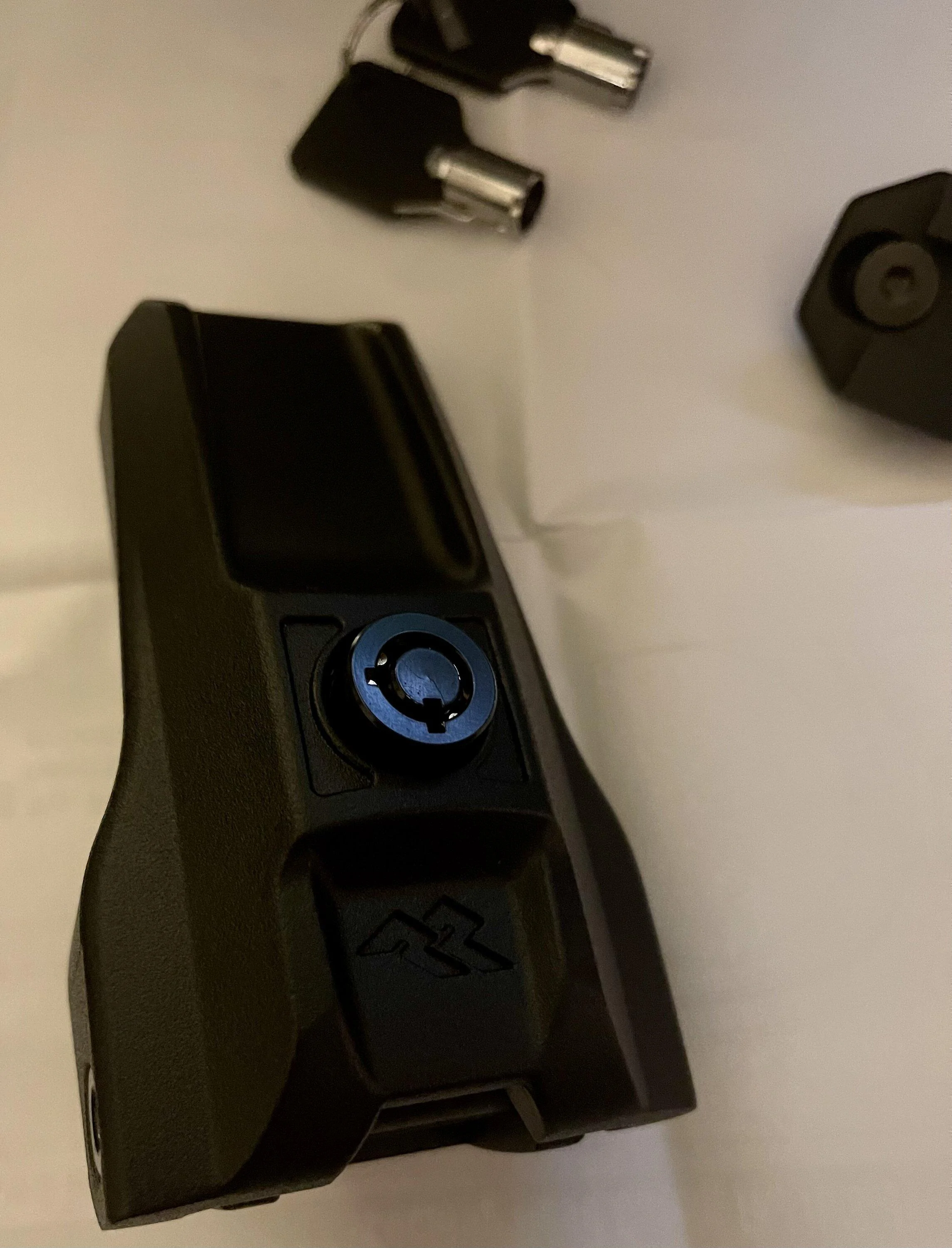

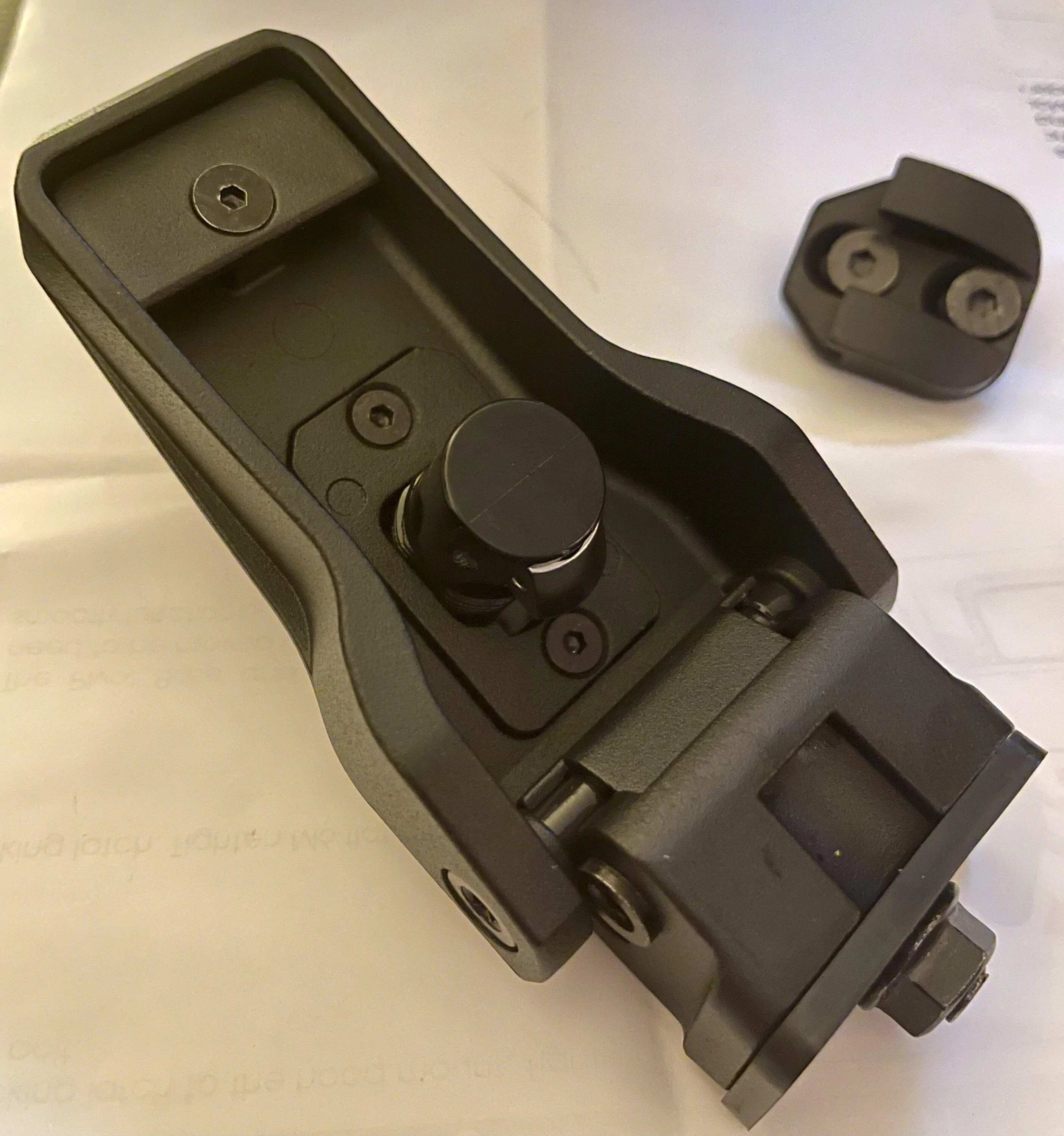

A lot of us have been chatting about hood locks in that other thread to help deter entry into the hood area. I said I was ordering some locking latches and they have arrived, here's my review.
I went with the Rugged Ridge "Locking Hood Catch" ( Jeep Gladiator Locking Hood Catch - $99). I originally saw a couple sets on Amazon that were only about $40 but after reading some reviews I decided to stick to a company I've dealt with before and trust as far as material quality. These are metal but closely resemble the stock plastics.
[Side by side view of the stock hood latch and the Rugged Ridge locking latch.]
The install was quick and painless, the stocks are held in by a single bolt on the fender and 2 small bolts on the hood. The same goes for the Rugged Ridge pair. Including photos, the entire process was about 20 minutes. Instructions were good, but honestly this could have been figured out without them anyway. I used a size 10 socket for the hood and a 1/2" wrench for the fender where the room to work is sparce. Everything popped loose with little effort and removed by hand. You will need two hex wrenches but sorry I didn't mark down which size I used.
[Everything shipped and packaged nicely with instructions and labeled bags, the latch was completely put together already.]
[Removal of the stock fender mount.]
[Close up of the new locking mechanism.]
[An underneath view of one hex bolt.]
[Front view, stock latch on left / Rugged Ridge latch on right.]
My plan was to use this one 2-pack to lock both hoods of my JT and JL, after seeing how closely they appear to each other and not like a "sore thumb" that's exactly what I did. Here it is pictured on my wife's Wrangler, the process was identical.
Overall I am extremely happy with the build quality and I think it will work as intended to keep the hood closed and safely locked away. Hope this helps!

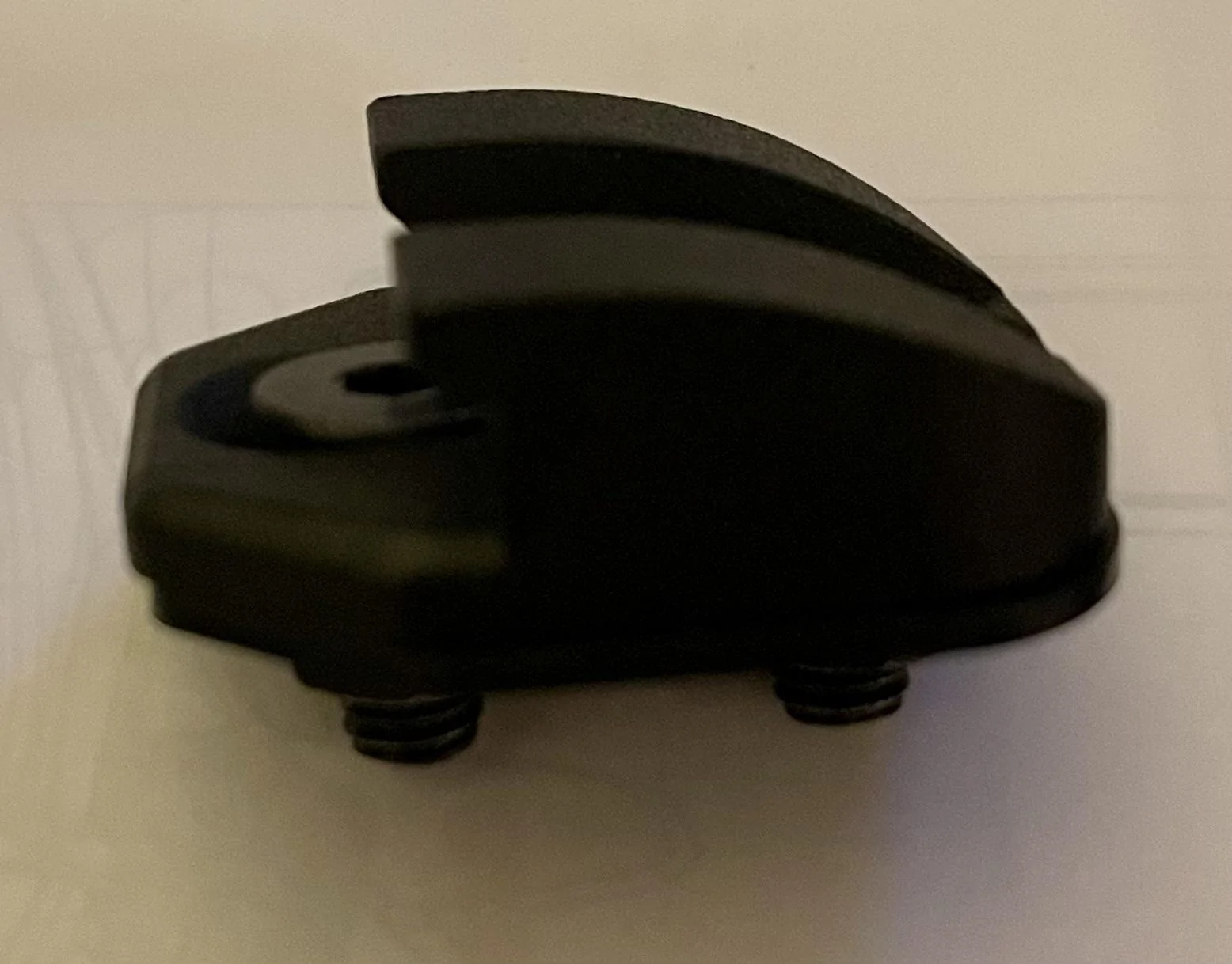

That is the best looking locking hood latch I’ve seen… do you have a picture of the other 1/2 of the latch on the hood?
I’ve always thought the,location of jeep latches on the outside of the hood make defeat of a locking latch too easy with a simple pry bar. They might slow a thief down, but they are going to result in damage to the hood if the thief is determined to get in.

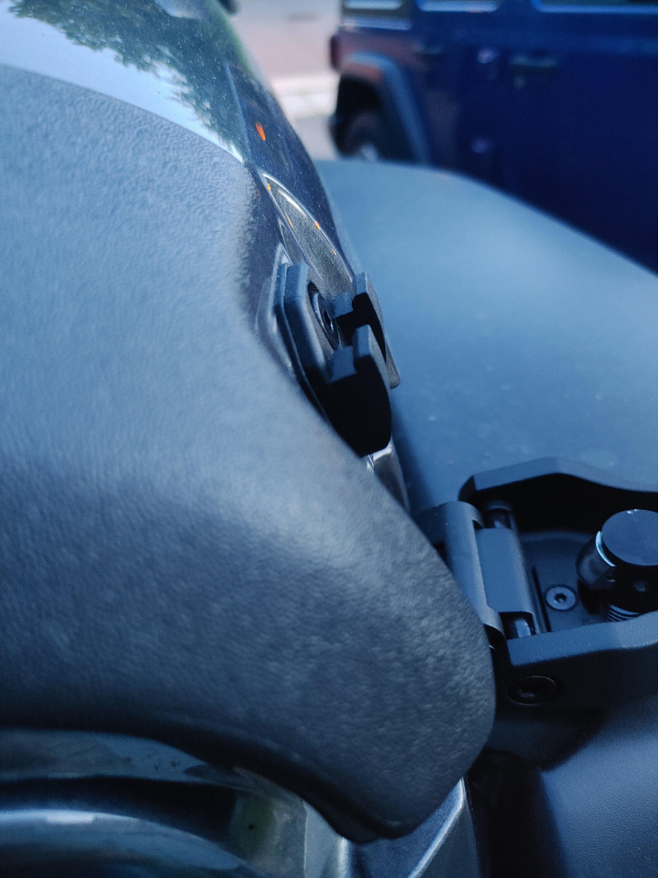

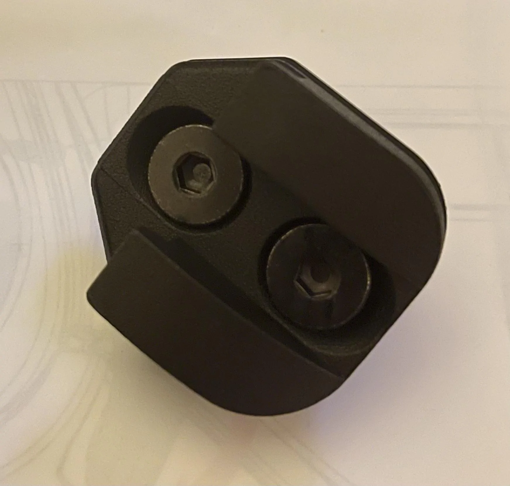

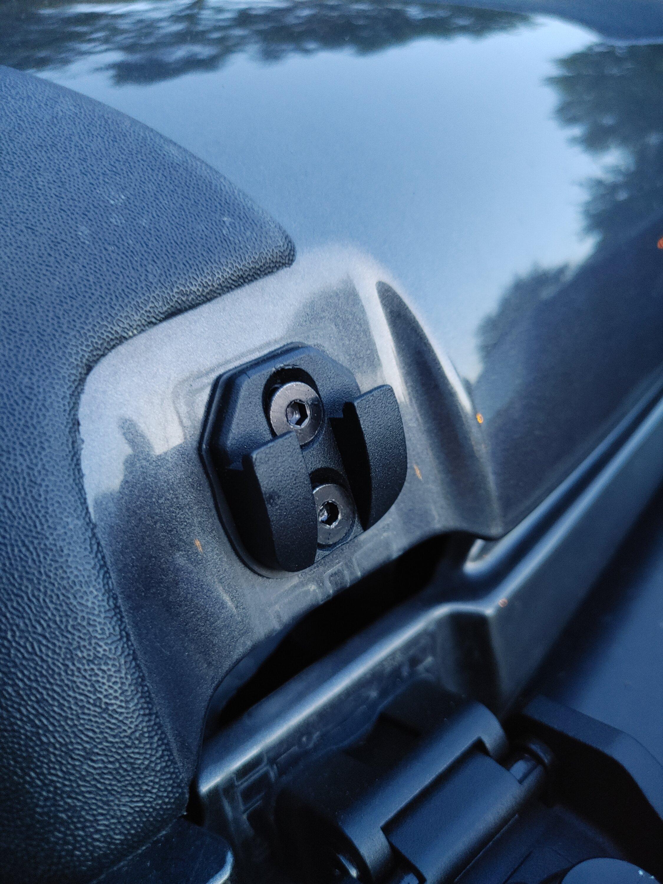

Thank you two for answering and adding the pictures. Here's that top half mounted.
Jeep Gladiator Installation and Review: Rugged Ridge Locking Hood Catch 0619222044_HDR
To mimic what they said, it keeps honest people honest. If someone wants to get in, they will and there's nothing that can stop them. But this just makes it a little bit harder.
