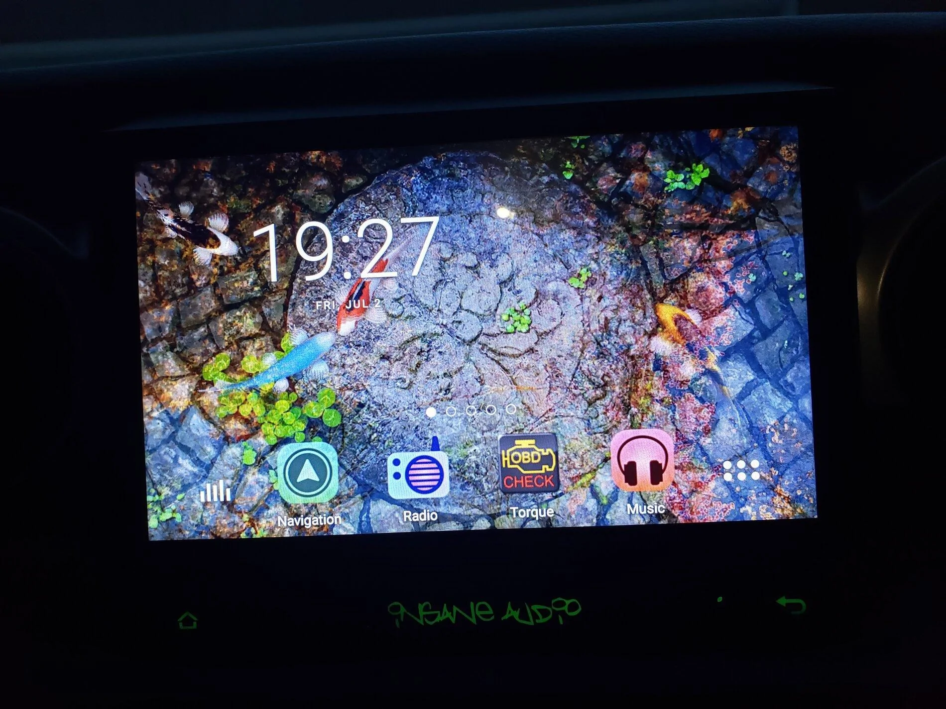

I still LOVE it. If you use your phone as a hotspot it can do anything your tablet can do. If there's an app in the app store it's compatible.
1. The unit stays on when you shut the truck off. And for a lot longer time period than the stock radio. I believe it stays on as long as ACC so about 20 minutes or so.
2. Haven't had doors off yet. But with doors open it shuts off when the truck is turned off.
3. It has 2. You can wirelessly control GoPros from the unit too.
4. It still runs off of Android 9.0.
Another JL3001 Owner here - In regards to question 1 - there are actually some settings you can use to change this. You can change it to stay on for 5 minutes, turn off immediately, etc. I ran into this the first time I did doors off with the JL3001, the head unit wasnt turning off and I didnt want to drain my battery. I did some tinkering with the settings and now it turns off at the same time as the vehicle turns off, instead of waiting for me to open & close a door.
But yea, I absolutely agree, Ive had amazing experiences with IA`s customer service and am really happy with the purchase. Ive had it for ~9 months and its been great.

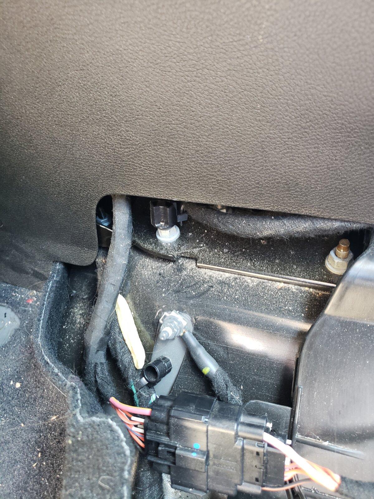

I put the sub behind the rear passenger seat and the amp I attached to a panel under and to the right of the glove box. There's a ground post under the front passenger seat right underneath the center console.
Lateral to the ground post is a grommet in the floor of the cab. I drilled through that and run the power cables through there and along the frame and up into the engine compartment.

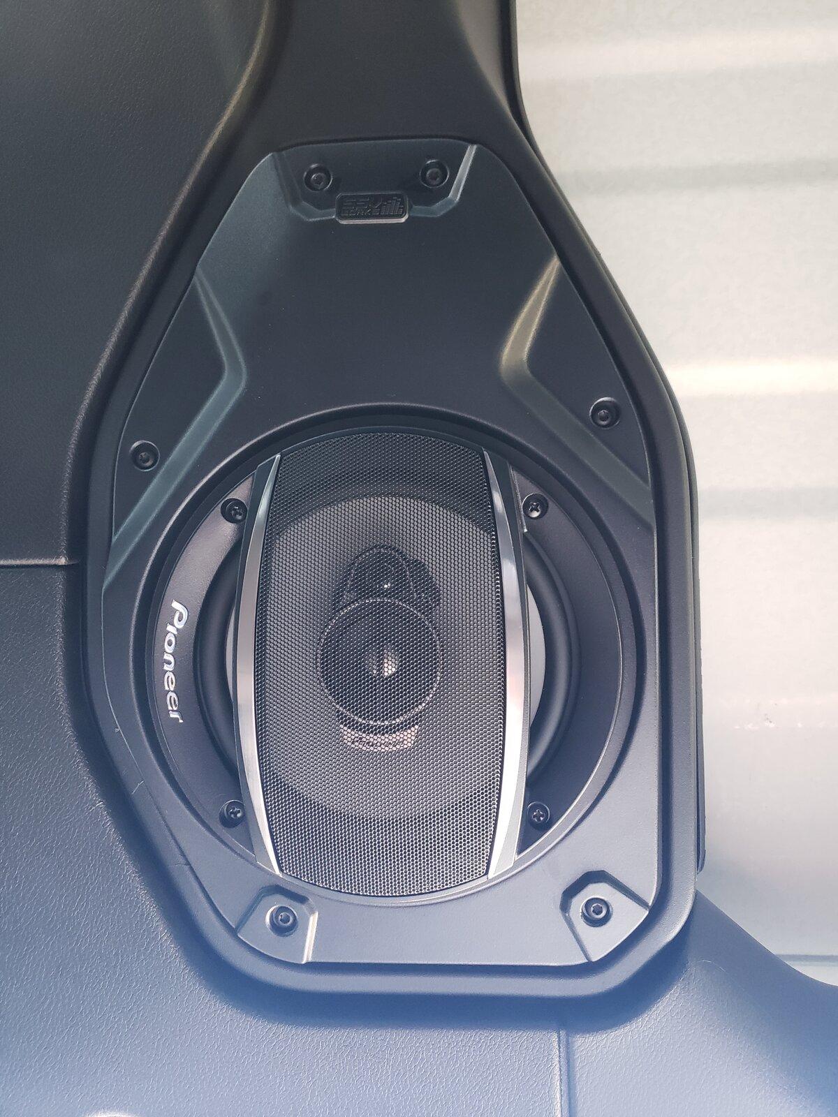

I ran all new speaker wires because on the basic sound system the speakers run parallel and I wanted each speaker on a channel. I upgraded the dash speakers and the kicker panel speakers with the Metra speaker pods and 6 inch speakers. I also replaced the sound bar speakers with one 6 inch 3 ways speaker on each side.
The JBL amp has an internal DSP that can program each channel out with a 31 band EQ. And then the JL3001. I don't even know where to start. It is like an IPAD mounted to your dash. It is absolutely amazing. It turns on instantly and the Nav is almost instant when turning it on. I can't wait to explore it's functions more.
