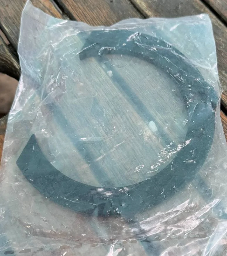

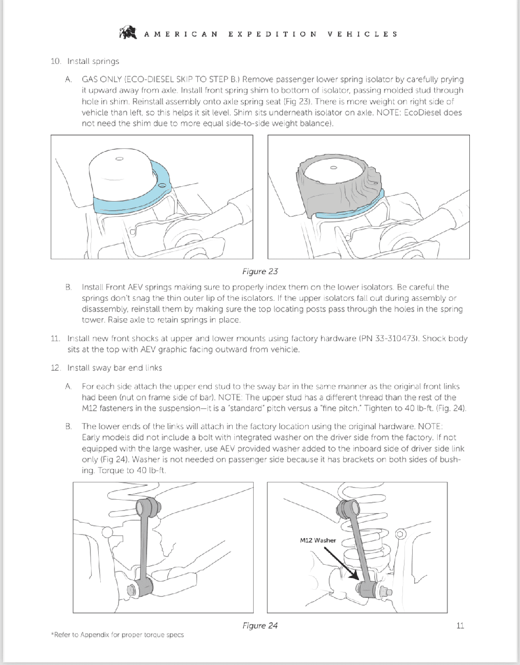

I do have the passenger side spring spacer from AEV for the gas engine. It’s about 1/4 inch thick.
Jeep Gladiator Installed Mopar lift two weeks ago, sides don't match height, what did I do? IMG_3200
